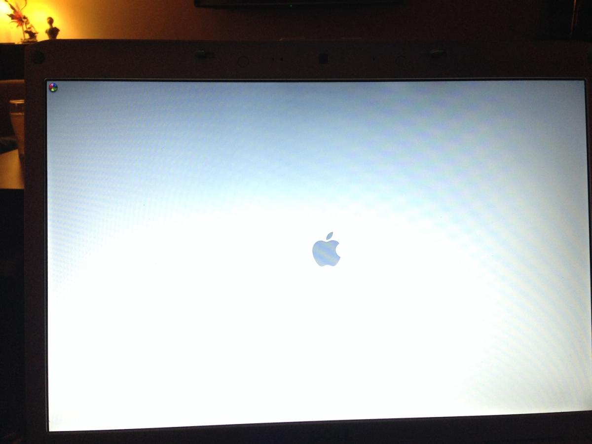

druvix Posted January 24, 2014 Share Posted January 24, 2014 Thanks for the DSDT Fusion and Mirko, It has helped as I can now get further on but it seems to be freezing at the coloured wheel of death, the 1720 Dose not react to Trackpad or keyboard (but dose if I plug in my Apple USB keyboard and mouse) Tried changing all the relevant Bios settings 1 at a time, including using the -cpus=1 etc but still the same end result. After studying your guide I realised that I've not used all the Kexts you mentioned in (things you will need) not including the extra ones in each package, am I now being dumb here and not doing what would be obvious to someone else? I am Enjoying getting stuck into this and Im hoping that I will retain some of this information so I to can be of use in the future, Although I think my Girlfriend is getting tired of having one-sided conversations Link to comment https://www.insanelymac.com/forum/topic/294448-guide-install-mac-os-x-109-mavericks-on-dell-inspiron-1720vostro-1700-with-nvidia-graphics/page/2/#findComment-1988409 Share on other sites More sharing options...

druvix Posted January 25, 2014 Share Posted January 25, 2014 Sorry I should have explained a little better, I have been booting Using the -v at all times as it gives me a little bit of an idea whats going on. After using the Correct DSDT I've managed to get past the verbose output and the Apple logo has appeared + Im getting the Little beach ball spinning, It dose this indefinitely, at first I thought it was totally unresponsive but I then plugged my USB apple keyboard and mouse and I could now move the spinning wheel around the screen but still just stayed at this screen. I did have a little bit more luck this morning, using part of the guide you linked above and Xangle's Guide I've managed to get to the disc utility and format the drive, but When I went to instal It said I needed to Do this Via App store. I had forgot to copy over the Packages File (step 10) I blame talking to my girlfriend lol after copying this file across its freezing at the screen I posted Above. Link to comment https://www.insanelymac.com/forum/topic/294448-guide-install-mac-os-x-109-mavericks-on-dell-inspiron-1720vostro-1700-with-nvidia-graphics/page/2/#findComment-1988546 Share on other sites More sharing options...

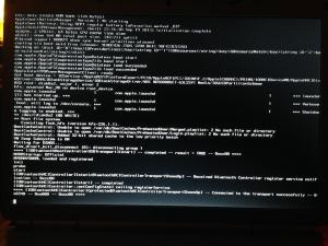

mirko888 Posted January 26, 2014 Share Posted January 26, 2014 @fusion71au yes I'm on latest bios a09,i have all the kexts xangel used in his guide + some kexts from darwinx(links in the first xangels post)-CSRAppleBluetooth.kext,DellBluetoothHCI.kext,IOBluetoothFamily.kext and AppleGraphicsPowerManagement.kext...will try to delete them all and boot without them,thanks...ill let you know if it worked @xangel9626 yes I'm on the newest chameleon available from chameleon wizard...i will try with the older version you said,thanks...ill let you guys know if it works @druvix just be patient,getting through the installer is the hardest part(at least was for me),"less than a minute" lasted 30mins on my 1720.good luck Link to comment https://www.insanelymac.com/forum/topic/294448-guide-install-mac-os-x-109-mavericks-on-dell-inspiron-1720vostro-1700-with-nvidia-graphics/page/2/#findComment-1988858 Share on other sites More sharing options...

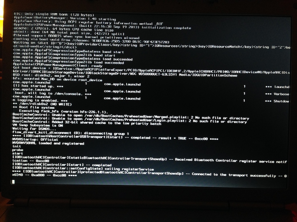

xangel9626 Posted January 26, 2014 Author Share Posted January 26, 2014 SMBios 3.1 won't work. From the look of your second verbose screen, your C-states aren't initializing properly. After removing the Bluetooth kexts, did you redo the extensions.mkext files and place it in the /System/Library/com.apple.kext.caches/Startup folder? Also, try booting with -f if you aren't. Link to comment https://www.insanelymac.com/forum/topic/294448-guide-install-mac-os-x-109-mavericks-on-dell-inspiron-1720vostro-1700-with-nvidia-graphics/page/2/#findComment-1988909 Share on other sites More sharing options...
druvix Posted January 26, 2014 Share Posted January 26, 2014 Well I got past the instal, The last minute took about another hour lol. Im now freezing just after bluetooth warnings in -v I've not finished trying different setups and options but I'm starting to run out. I'm hoping i didn't make the mistake by using my running copy of mavericks on my MacPro to complete the steps in Post instal? on an slightly unrelated note, When installing mavericks did you have to plug in a USB keyboard and mouse? My touchpad and keyboard on the laptop was working perfect but Mavericks wouldn't allow me to continue with setup without detecting a mouse and keyboard. Link to comment https://www.insanelymac.com/forum/topic/294448-guide-install-mac-os-x-109-mavericks-on-dell-inspiron-1720vostro-1700-with-nvidia-graphics/page/2/#findComment-1988935 Share on other sites More sharing options...

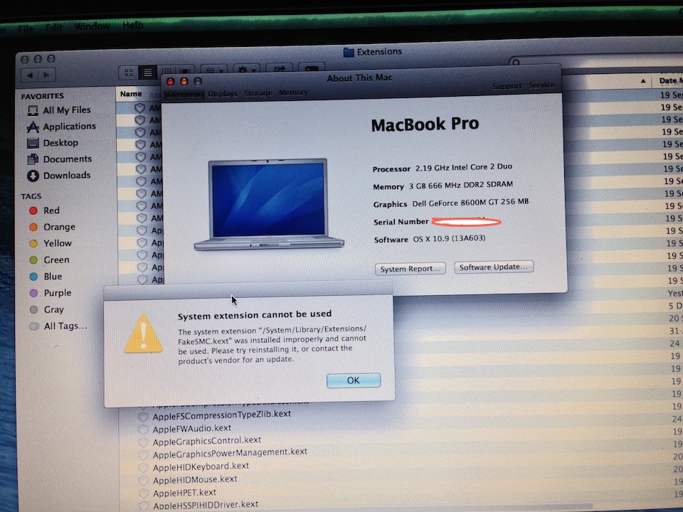

druvix Posted January 26, 2014 Share Posted January 26, 2014 Well I've managed to get it to boot, Took me some time but I think it was my stupid fault (again) on my Mavericks drive I hadn't installed the Fakesmc after doing this I got it to boot If I remove this it stops booting again, although once its up and running I get a warning saying the fakesmc.kext cannot be used. My Built in keyboard, touchpad, wifi and sound don't work, graphics are fine, and cpu running at full speed. these I can hopefully sort out over time. I think Im going to make a Clone of this drive before I continue to mess around with it as I know this boots (kind of) Thanks for all your help! Slowly getting there with this old laptop and Im learning ALOT Link to comment https://www.insanelymac.com/forum/topic/294448-guide-install-mac-os-x-109-mavericks-on-dell-inspiron-1720vostro-1700-with-nvidia-graphics/page/2/#findComment-1988963 Share on other sites More sharing options...
mirko888 Posted January 26, 2014 Share Posted January 26, 2014 @xangel that cstates error keeps repeating from the first time i booted mavericks,dont know why ....but i think it doesnt effect my ram problem,and yes i booted with -f after deleting kexts @druvix copy your kexts again and overwrite everything that asks,boot with -f,then use kext wizard on your mac partition Link to comment https://www.insanelymac.com/forum/topic/294448-guide-install-mac-os-x-109-mavericks-on-dell-inspiron-1720vostro-1700-with-nvidia-graphics/page/2/#findComment-1988968 Share on other sites More sharing options...
fusion71au Posted January 26, 2014 Share Posted January 26, 2014 @mirko888 @xangel9626 The c-states error is normal -none of our Dell Laptops have working c-states (only p-states work). This is because the LPC device is fundamentally different to Apple's and can't be corrected through dsdt or other means - see my post here. re mirko's RAM issue - wonder what brand/exact specs of RAM you are using? Could be a compatibility issue between the RAM and BIOS (although on the other hand, the fact that Windows works OK with 4GB points to a 32 bit kext issue). Out of interest, did you do a vanilla install? A lot of those all in one installers put uneccessary kexts in S/L/E..... Also to exclude a BIOS setting anomaly, maybe reset to optimised defaults and ensure hard drive is in AHCI mode, HPET 64 bit etc. Edit: Have a look at this forum post on determining which 32 bit kexts are in your system. In terminal, type kextstat to show all the kexts used in your system. All the Apple ones should be OK for 64bit. Then use kextfind to filter out the non 64 bit ones kextfind -not -arch x86_64 and kextfind -f /Library/Extensions -e -not -arch x86_64 @xangel: I don't think my patched dsdts are the issue. Mirko has stated that he has used both the dsdt I edited for you (which works with 4GB on your machine) and the one I did from his native dsdt extracted from BIOS in linux with 4GB installed--->they both work on his machine save for the 4GB RAM issue. I am certain I didn't add a patch restricting memory usage to less than 4GB . @mirko: Disk partitioning to mbr or GUID shouldn't have any influence on your RAM issue (although I do strongly recommend GUID for reasons I outline in this post). @druvix That error is a permissions problem that can be corrected running disk utility and repairing disk permissions. You should use kext wizard or kext utility to install kexts to avoid this problem. For post-install into your hard drive's S/L/E folder, you will need FakeSMC and also AppleAPCIPS2Nub and ApplePS2Controller (alternatively VoodooPS2Controller)---> for your trackpad and keyboard VoodooHDA--->for sound ACPIBatteryManager--->for battery meter AppleBCM440Xethernet--->for ethernet Wireless--->Depends on your hardware. You'll find that the Intel wireless cards won't work with OSX, regardless of any kexts. The ones supported natively by OSX and recognised as "Airport" tend to be Broadcom (if you're lucky, you may have a Dell TrueMobile 1505) or Atheros chipset based cards. See my post here Patched AppleRTC--->to prevent CMOS resets with sleep Regressed AppleACPIPlatform--->to prevent reboot on invoking sleep more than once Optional- patched AppleGraphicsPowerManagement--->Id of the Dell 8600gt is inserted into patched kext for better performance/power mx kexts in blue are from DarwinX's post. PS You should use a photo editing program to blank out your serial number in your previous post . Link to comment https://www.insanelymac.com/forum/topic/294448-guide-install-mac-os-x-109-mavericks-on-dell-inspiron-1720vostro-1700-with-nvidia-graphics/page/2/#findComment-1988970 Share on other sites More sharing options...
xangel9626 Posted January 26, 2014 Author Share Posted January 26, 2014 @druvix When you get the kind of error you got with the fakesmc, try doing a permissions repair on the hard drive. For the keyboard, mouse and audio, I would try replacing the files again, rebuilding the extensions.mkext and moving it into the S/L/C/com/Startup folder. I think I didn't explain it properly, you need to drop the kexts into the S/L/Extensions folder, then drag the entire folder onto the Kext Utility to build the extensions.mkext. Make sure you boot with -f when you restart. Yes, do make a clone. @mirko No, your c-states aren't going to affect your ram, only the speeds that your processor is supposed to run. Your situation is very weird since I have never seen anyone have issues with their ram not being fully recognized. I know it may suck since I have done this about 20 times before I got a working system, but you might want to try reinstalling to see if you get the same issue. EDIT @ Fusion That's what I get for walking away from my computer for a second to help my son. LoL Link to comment https://www.insanelymac.com/forum/topic/294448-guide-install-mac-os-x-109-mavericks-on-dell-inspiron-1720vostro-1700-with-nvidia-graphics/page/2/#findComment-1988972 Share on other sites More sharing options...
