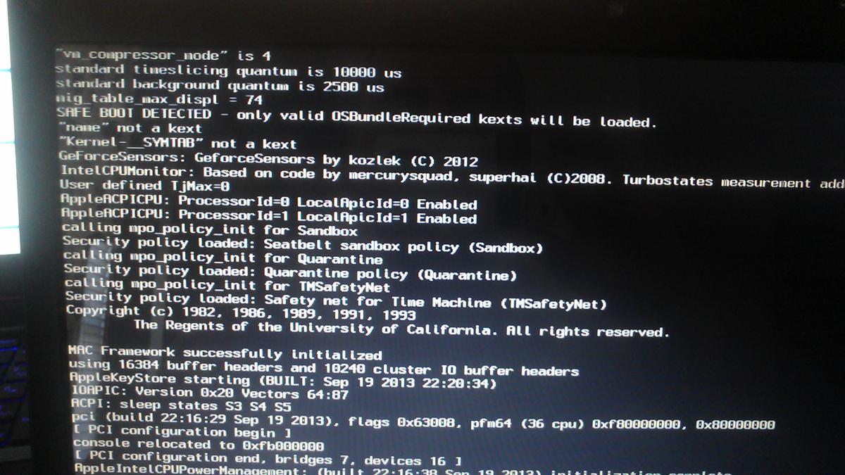

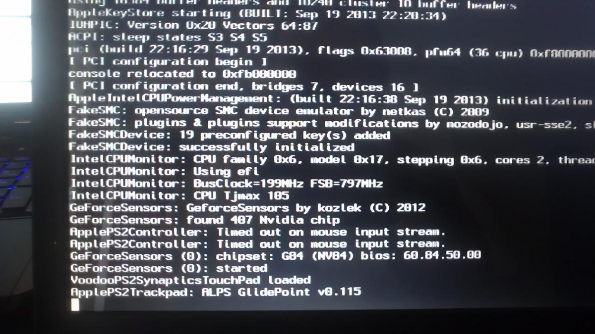

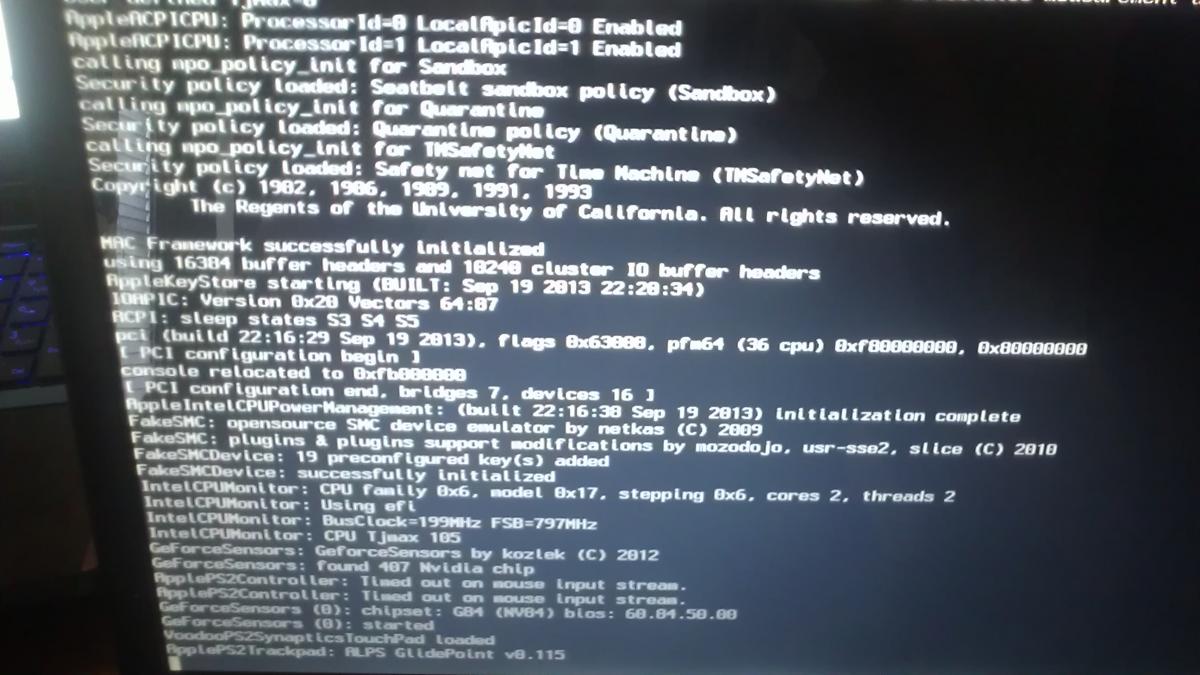

Phibermatrix Posted January 29, 2014 Share Posted January 29, 2014 sticky situation here or atleast where I'm getting stuck at on my boot from my harddrive after install of os x I have not been able to start up to actually configure it after install. I did get the harddrive hooked up to my VM and install everything that I believe I was supposed to install. Link to comment https://www.insanelymac.com/forum/topic/294448-guide-install-mac-os-x-109-mavericks-on-dell-inspiron-1720vostro-1700-with-nvidia-graphics/page/4/#findComment-1989839 Share on other sites More sharing options...
druvix Posted January 29, 2014 Share Posted January 29, 2014 I've just started again with a fresh install also made a new copy of the Instal USB, I've left everything in the bios at defaults, had to boot with flags -v -f -x and its booted straight away. one thing I couldn't do was get anything to happen on my screen after -v text without first plugging in a USB keyboard and mouse. for some reason although my trackpad and built in keyboard was working fine, OSX didn't think it had any input devices and kept asking for me to connect my bluetooth mouse and keyboard. I booted again without my USB bluetooth stick and it just froze at a grey screen for 10 mins after going through the -v mode without any obvious faults. Anyway after trying this with a standard keyboard and mouse plugged in, it went straight onto the install screen after displaying verbose text. not sure why mine is doing this and not sure if this could be a problem for anyone else and might be a reason why some can't get any further? Link to comment https://www.insanelymac.com/forum/topic/294448-guide-install-mac-os-x-109-mavericks-on-dell-inspiron-1720vostro-1700-with-nvidia-graphics/page/4/#findComment-1989843 Share on other sites More sharing options...
xangel9626 Posted January 29, 2014 Author Share Posted January 29, 2014 @phiber - you have both the VoodooPS2 and ApplePS2 kexts installed, you need to remove the VoodooPS2 kext. After you do that, rebuild the extensions.mkext and put it in the startup folder that my instructions tells you and boot with -v -f again. @druvix - it sounds to me that you missed the VoodooPS2 kext in your installer. Check to make sure it's there. When the USB Bluetooth is installed it will look for a keyboard and mouse if there is no USB keyboard or mouse plugged in. Link to comment https://www.insanelymac.com/forum/topic/294448-guide-install-mac-os-x-109-mavericks-on-dell-inspiron-1720vostro-1700-with-nvidia-graphics/page/4/#findComment-1989866 Share on other sites More sharing options...
