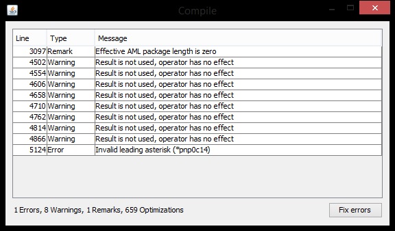

xangel9626 Posted December 31, 2013 Author Share Posted December 31, 2013 Thank you for doing that DSDT edit fusion. Question, could you tell me what I am doing wrong with the DSDTEditor? I added the patches to the DSDT as outlined in immo's thread and when I compiled, I kept getting a couple errors. How do you get past them or do you just ignore them? I attached a picture of what I'm talking about. Link to comment https://www.insanelymac.com/forum/topic/294448-guide-install-mac-os-x-109-mavericks-on-dell-inspiron-1720vostro-1700-with-nvidia-graphics/#findComment-1980413 Share on other sites More sharing options...
fusion71au Posted December 31, 2013 Share Posted December 31, 2013 @xangel9626 The warnings and the remark can be ignored but the error needs fixing. I found that you can just delete the asterisk and change the lower case letters over to uppercase: ie *pnp0c14----> PNP0C14 To fix the cosmetic warnings, apply this fix from Immo's first post in the dsdt thread: You will get a number of warnings that look like this:DSDT.dsl 5016: And (Local0, 0x0F)Warning 1105 - ^ Result is not used, operator has no effectReplace all of these with:And (Local0, 0x0F, Local0) Link to comment https://www.insanelymac.com/forum/topic/294448-guide-install-mac-os-x-109-mavericks-on-dell-inspiron-1720vostro-1700-with-nvidia-graphics/#findComment-1980418 Share on other sites More sharing options...
xangel9626 Posted December 31, 2013 Author Share Posted December 31, 2013 Ok that's easy enough. I figured that the warnings were something that needed to be fixed, now that I know they aren't, I should be able to mod some DSDTs. @ fusion, will do. It seems like DSDT editing is easier than I thought initially. Thank you for your insight. Link to comment https://www.insanelymac.com/forum/topic/294448-guide-install-mac-os-x-109-mavericks-on-dell-inspiron-1720vostro-1700-with-nvidia-graphics/#findComment-1980528 Share on other sites More sharing options...

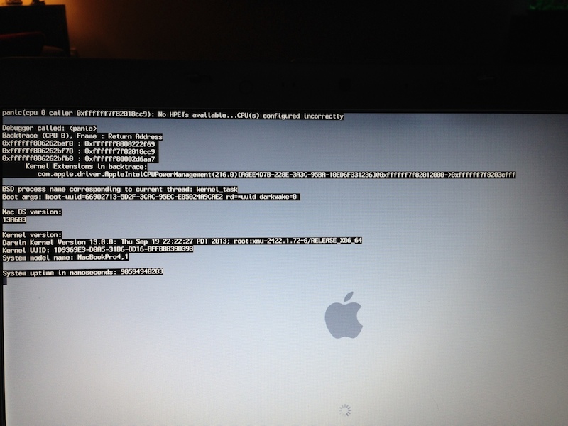

druvix Posted January 22, 2014 Share Posted January 22, 2014 Hey, I have a Dell inspiron 1720, 3GB Ram, Core 2 Duo T7500, Nvidia 8600m gt, 500GB HDD which I'm trying to install Mavericks, Sorry to ask but I've been following your guide But I'm getting stuck, I've tried to use your DSDT but its freezing on the boot screen. Could this be related to using the Wrong DSDT? or would I at least get too the install screen? Link to comment https://www.insanelymac.com/forum/topic/294448-guide-install-mac-os-x-109-mavericks-on-dell-inspiron-1720vostro-1700-with-nvidia-graphics/#findComment-1987667 Share on other sites More sharing options...
fusion71au Posted January 23, 2014 Share Posted January 23, 2014 @druvix Best to extract the native DSDT from your own BIOS eg using rweverything in windows or a linux live USB, then apply the patches using DSDT editor as I outlined in xangel's thread. If you have no luck after attempting this yourself, upload your untouched DSDT and I will have a look at it for you. The error in the screenshot suggests an incorrectly configured DSDT that needs HPET patching (did you put xangel's patched DSDT in the /extra folder of your install USB?). You might be able to complete the install without a DSDT file if NullCPUPowerManagement.kext (& FakeSMC, VoodooPS2Controller) is added to the System/Library/Extensions folder of the install USB as per the all in one Vanilla Install Guide for OSX. Link to comment https://www.insanelymac.com/forum/topic/294448-guide-install-mac-os-x-109-mavericks-on-dell-inspiron-1720vostro-1700-with-nvidia-graphics/#findComment-1987782 Share on other sites More sharing options...
druvix Posted January 23, 2014 Share Posted January 23, 2014 Yes I tried using the 3 different DSDT's available on this thread. I will put my windows Drive back in tonight and try to patch the DSDT myself, If not that I would be very grateful if you had a little look for me. I was just hoping that the ones on here would work (lazy I suppose) using another guide I found somewhere on Google I managed to get the laptop to Disk Utility Before It would freeze up after a random time. I will let you know How I get on Thanks for your time DSDT.AML.zip Link to comment https://www.insanelymac.com/forum/topic/294448-guide-install-mac-os-x-109-mavericks-on-dell-inspiron-1720vostro-1700-with-nvidia-graphics/#findComment-1987937 Share on other sites More sharing options...
fusion71au Posted January 23, 2014 Share Posted January 23, 2014 @druvix Try this DSDT patched from the original you posted above. No guarantees but compiles without errors DSDTdruvixedit.zip Link to comment https://www.insanelymac.com/forum/topic/294448-guide-install-mac-os-x-109-mavericks-on-dell-inspiron-1720vostro-1700-with-nvidia-graphics/#findComment-1988067 Share on other sites More sharing options...
xangel9626 Posted January 24, 2014 Author Share Posted January 24, 2014 For everyone, using the wrong DSDT will not allow the USB installer to boot. You must use one for your CPU. If you have a T7250, my DSDT should work for you, if it doesn't or you have a different CPU, you need to make one of your own. Link to comment https://www.insanelymac.com/forum/topic/294448-guide-install-mac-os-x-109-mavericks-on-dell-inspiron-1720vostro-1700-with-nvidia-graphics/#findComment-1988107 Share on other sites More sharing options...
