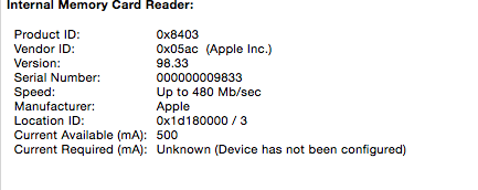

buoo Posted April 6, 2015 Share Posted April 6, 2015 Thank you TimeWalker Have I to change the productId only? idProduct 297 Link to comment https://www.insanelymac.com/forum/topic/293246-osx-on-dell-vostro-3450-inspiron-n4110-xps-l702x-uefi-clover/page/38/#findComment-2125688 Share on other sites More sharing options...
TimeWalker75a Posted April 6, 2015 Author Share Posted April 6, 2015 Thank you TimeWalker Have I to change the productId only? <key>idProduct</key> <integer>297</integer> Should be that simple, make sure you do change it in all the sections that mimic the native reader. Also you might want to shut down the laptop completely before saying it doesn't work. Sometimes when I soft boot, especially from Lubuntu or Windows it tends to not work.. Link to comment https://www.insanelymac.com/forum/topic/293246-osx-on-dell-vostro-3450-inspiron-n4110-xps-l702x-uefi-clover/page/38/#findComment-2125689 Share on other sites More sharing options...
buoo Posted April 6, 2015 Share Posted April 6, 2015 It doesn't work, this is the info.plist. <?xml version="1.0" encoding="UTF-8"?> <!DOCTYPE plist PUBLIC "-//Apple//DTD PLIST 1.0//EN" "http://www.apple.com/DTDs/PropertyList-1.0.dtd"> <plist version="1.0"> <dict> <key>CFBundleDevelopmentRegion</key> <string>English</string> <key>CFBundleIdentifier</key> <string>com.apple.driver.CustomPeripheral</string> <key>CFBundleInfoDictionaryVersion</key> <string>6.0</string> <key>CFBundleName</key> <string>CustomPeripheral</string> <key>CFBundlePackageType</key> <string>KEXT</string> <key>CFBundleSignature</key> <string>????</string> <key>CFBundleVersion</key> <string>8.8.8</string> <key>IOKitPersonalities</key> <dict> <key>Card Reader Device - Realtek USB-CRW 2.0 0bda-0138</key> <dict> <key>CFBundleIdentifier</key> <string>com.apple.driver.AppleUSBMergeNub</string> <key>IOClass</key> <string>AppleUSBMergeNub</string> <key>IOProviderClass</key> <string>IOUSBDevice</string> <key>IOProviderMergeProperties</key> <dict> <key>USB Product Name</key> <string>Internal Memory Card Reader</string> <key>USB Serial Number</key> <string>000000009833</string> <key>USB Vendor Name</key> <string>Apple</string> <key>bcdDevice</key> <integer>38963</integer> <key>idProduct</key> <integer>33795</integer> <key>idVendor</key> <integer>1452</integer> <key>non-removable</key> <string>yes</string> </dict> <key>idProduct</key> <integer>297</integer> <key>idVendor</key> <integer>3034</integer> </dict> <key>Card Reader Inject</key> <dict> <key>CFBundleIdentifier</key> <string>com.apple.driver.AppleUSBCardReader</string> <key>IOClass</key> <string>com_apple_driver_AppleUSBCardReaderUMC</string> <key>IOMediaIcon</key> <dict> <key>CFBundleIdentifier</key> <string>com.apple.iokit.IOSCSIArchitectureModelFamily</string> <key>IOBundleResourceFile</key> <string>SD.icns</string> </dict> <key>IOProviderClass</key> <string>IOUSBInterface</string> <key>Physical Interconnect</key> <string>USB</string> <key>Physical Interconnect Location</key> <string>Internal</string> <key>Read Time Out Duration</key> <string>30000</string> <key>SCSI Device Characteristics</key> <dict> <key>IOMaximumBlockCountRead</key> <integer>8192</integer> <key>IOMaximumBlockCountWrite</key> <integer>8192</integer> </dict> <key>Write Time Out Duration</key> <string>30000</string> <key>bConfigurationValue</key> <integer>1</integer> <key>bInterfaceNumber</key> <integer>0</integer> <key>idProduct</key> <integer>297</integer> <key>idVendor</key> <integer>3034</integer> </dict> <key>Card Reader Interface</key> <dict> <key>CFBundleIdentifier</key> <string>com.apple.driver.AppleUSBMergeNub</string> <key>IOClass</key> <string>AppleUSBMergeNub</string> <key>IOProviderClass</key> <string>IOUSBInterface</string> <key>IOProviderMergeProperties</key> <dict> <key>bcdDevice</key> <integer>38963</integer> <key>idProduct</key> <integer>33795</integer> <key>idVendor</key> <integer>1452</integer> </dict> <key>bConfigurationValue</key> <string>*</string> <key>bInterfaceNumber</key> <string>*</string> <key>idProduct</key> <integer>297</integer> <key>idVendor</key> <integer>3034</integer> </dict> <key>Card Reader SBC</key> <dict> <key>CFBundleIdentifier</key> <string>com.apple.driver.AppleUSBMergeNub</string> <key>IOClass</key> <string>AppleUSBMergeNub</string> <key>IOProviderClass</key> <string>com_apple_driver_AppleUSBCardReaderSBC</string> <key>IOProviderMergeProperties</key> <dict> <key>Product Identification</key> <string>Internal Memory Card Reader</string> <key>USB Serial Number</key> <string>000000009833</string> <key>USB Vendor Name</key> <string>Apple</string> </dict> <key>idProduct</key> <integer>297</integer> <key>idVendor</key> <integer>3034</integer> </dict> <key>Card Reader SCSI</key> <dict> <key>CFBundleIdentifier</key> <string>com.apple.driver.AppleUSBMergeNub</string> <key>IOClass</key> <string>AppleUSBMergeNub</string> <key>IOProviderClass</key> <string>IOSCSIPeripheralDeviceNub</string> <key>IOProviderMergeProperties</key> <dict> <key>Product Identification</key> <string>SD Card Reader</string> <key>Product Revision Level</key> <string>1.00</string> <key>Vendor Identification</key> <string>APPLE</string> </dict> <key>Peripheral Device Type</key> <integer>0</integer> <key>Product Identification</key> <string>Multi-Card</string> <key>Vendor Identification</key> <string>Generic-</string> </dict> <key>Card Reader UMC</key> <dict> <key>CFBundleIdentifier</key> <string>com.apple.driver.AppleUSBMergeNub</string> <key>IOClass</key> <string>AppleUSBMergeNub</string> <key>IOProviderClass</key> <string>com_apple_driver_AppleUSBCardReaderUMC</string> <key>IOProviderMergeProperties</key> <dict> <key>Physical Interconnect Location</key> <string>Internal</string> <key>idProduct</key> <integer>33795</integer> <key>idVendor</key> <integer>1452</integer> </dict> <key>idProduct</key> <integer>297</integer> <key>idVendor</key> <integer>3034</integer> </dict> </dict> <key>OSBundleLibraries</key> <dict> <key>com.apple.driver.IOPlatformPluginFamily</key> <string>1.0.0</string> <key>com.apple.iokit.IOGraphicsFamily</key> <string>1.1</string> <key>com.apple.iokit.IONDRVSupport</key> <string>1.1</string> <key>com.apple.iokit.IOPCIFamily</key> <string>1.0</string> <key>com.apple.kpi.iokit</key> <string>8.3.1</string> <key>com.apple.kpi.libkern</key> <string>8.3.1</string> <key>com.apple.kpi.mach</key> <string>8.3.1</string> </dict> <key>OSBundleRequired</key> <string>Root</string> </dict> </plist> Let me reset the bios and reboot.... doesn't work. Link to comment https://www.insanelymac.com/forum/topic/293246-osx-on-dell-vostro-3450-inspiron-n4110-xps-l702x-uefi-clover/page/38/#findComment-2125692 Share on other sites More sharing options...
TimeWalker75a Posted April 6, 2015 Author Share Posted April 6, 2015 It doesn't work, this is the info.plist. 1. OSBundleLibraries is the same node level as IOKitPersonalities, on your plist you have it under IOKitPersonalities. Your XML is still broken 2. In the plist you have blindly copied over com.apple.driver.CustomPeripheral, whilst the extension you are installing is Custom.kext .. Link to comment https://www.insanelymac.com/forum/topic/293246-osx-on-dell-vostro-3450-inspiron-n4110-xps-l702x-uefi-clover/page/38/#findComment-2125693 Share on other sites More sharing options...
buoo Posted April 6, 2015 Share Posted April 6, 2015 Doesn't work again. The plist is correct now. CustomPeripheral.kext.zip Link to comment https://www.insanelymac.com/forum/topic/293246-osx-on-dell-vostro-3450-inspiron-n4110-xps-l702x-uefi-clover/page/38/#findComment-2125695 Share on other sites More sharing options...
TimeWalker75a Posted April 6, 2015 Author Share Posted April 6, 2015 Then, considering artur-pt has the same hardware an issue, I would only assume this revision won't work with OSX native drivers and requires something third-party, which doesn't exist, I presume. Like the title post says - I can only cater for the hardware I have... Link to comment https://www.insanelymac.com/forum/topic/293246-osx-on-dell-vostro-3450-inspiron-n4110-xps-l702x-uefi-clover/page/38/#findComment-2125705 Share on other sites More sharing options...

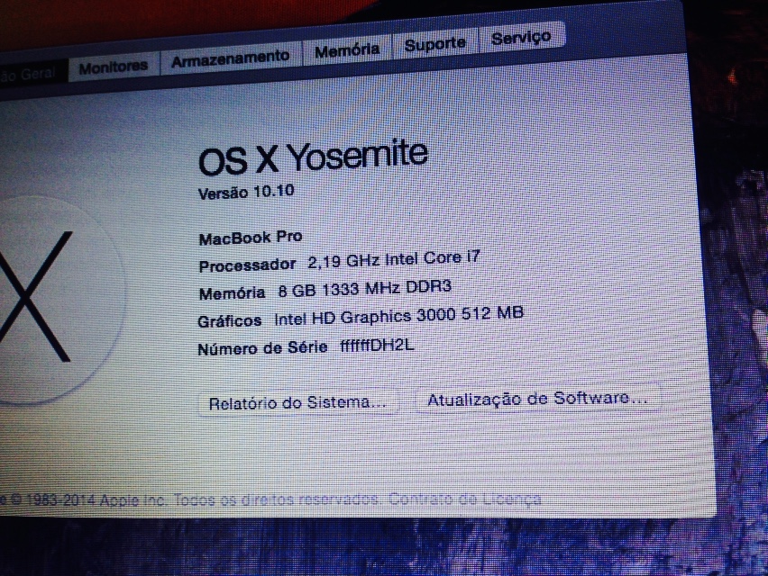

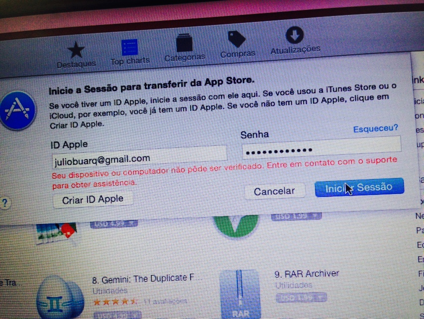

Julios Mac Posted April 14, 2015 Share Posted April 14, 2015 Hi guys all right ?! I have a problem in the appstore, we install all normal and sends the tutorial, but is giving this error ... I can not log in any way. Please help, I have a Dell Vostro 3450 Link to comment https://www.insanelymac.com/forum/topic/293246-osx-on-dell-vostro-3450-inspiron-n4110-xps-l702x-uefi-clover/page/38/#findComment-2128042 Share on other sites More sharing options...
