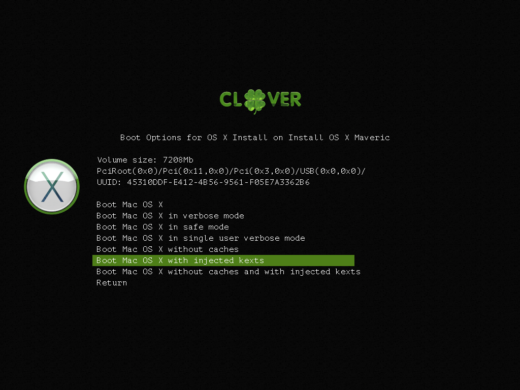

The kernel keeps panicking right after "DSMOS has arrived" line, what does this mean? My research seems to indicate I need to patch the SSDT file for my processor?
Anyways here's my system:
Model : Dell n4110
CPU:    i7-2620m
RAM:    6 GB DDR3
HDD:    INTEL 530 240GB SSD
Edit: I just tried booting the Mavericks install, and I still get the same kernel panic. Are you sure running an i7-2620M doesn't require me to modify any of your clover usb files?
Edit 2: Any help please?
I don't see any kernel panics here, what I see though is message saying that AGPM is unable to determine the platform, which means that IGPU is not being enabled properly. Why is that? You tell me .. because it works for just about everyone here.

I tried that and got a different kernel panic. I also tried resetting NVRAM, and resetting to default bios settings.
Why are you installing 10.9.3, when most recent software is 10.9.5? What is the origin of that installation media? Is that an original image?
I created using DiskMaker X from the .app file. It also panics with the latest Yosemite release from the store.
Well, if removing that SNB patch has lead to this, then try disabling Inject>Intel in config for now. I have no other options for you.
It didn't work. Thanks for the help :). Please let me know if you come up with anything or want more logs or info.

Try maxmem=4096
Maybe your un-paired 6Gb of memory have negative effect.
I actually physically removed the 2 GB RAM module from my laptop, but it still panics.
Edit: I was able to boot into the installer with the -x boot flag enable! What does this mean?
I fixed it! My i7-2620M CPU has a feature called Intel VT for Directed I/O(VT-d) which is enabled by default by the new bios. You have to disable this!!! Other people who have n4110 with i5-2410M or i3-2330M do not have to worry because they do not have VT-d support.

I never knew our BIOS had support for VT-d, so never added drop DMAR to table dropping list, perhaps I need to in next update.
Added, I just hope the table has signature DMAR, lol. Could you please re-enable VT-d in BIOS and re-download the Clover USB files?
