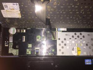

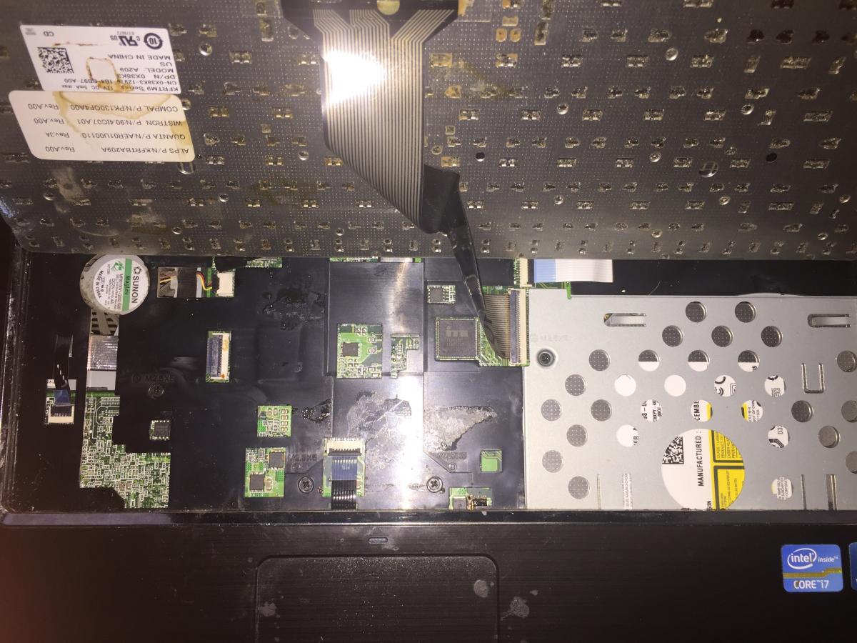

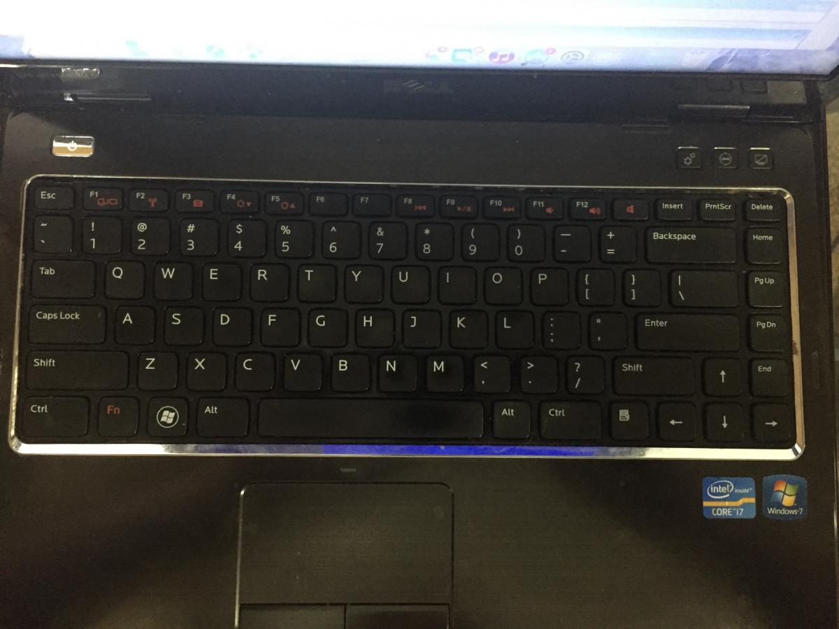

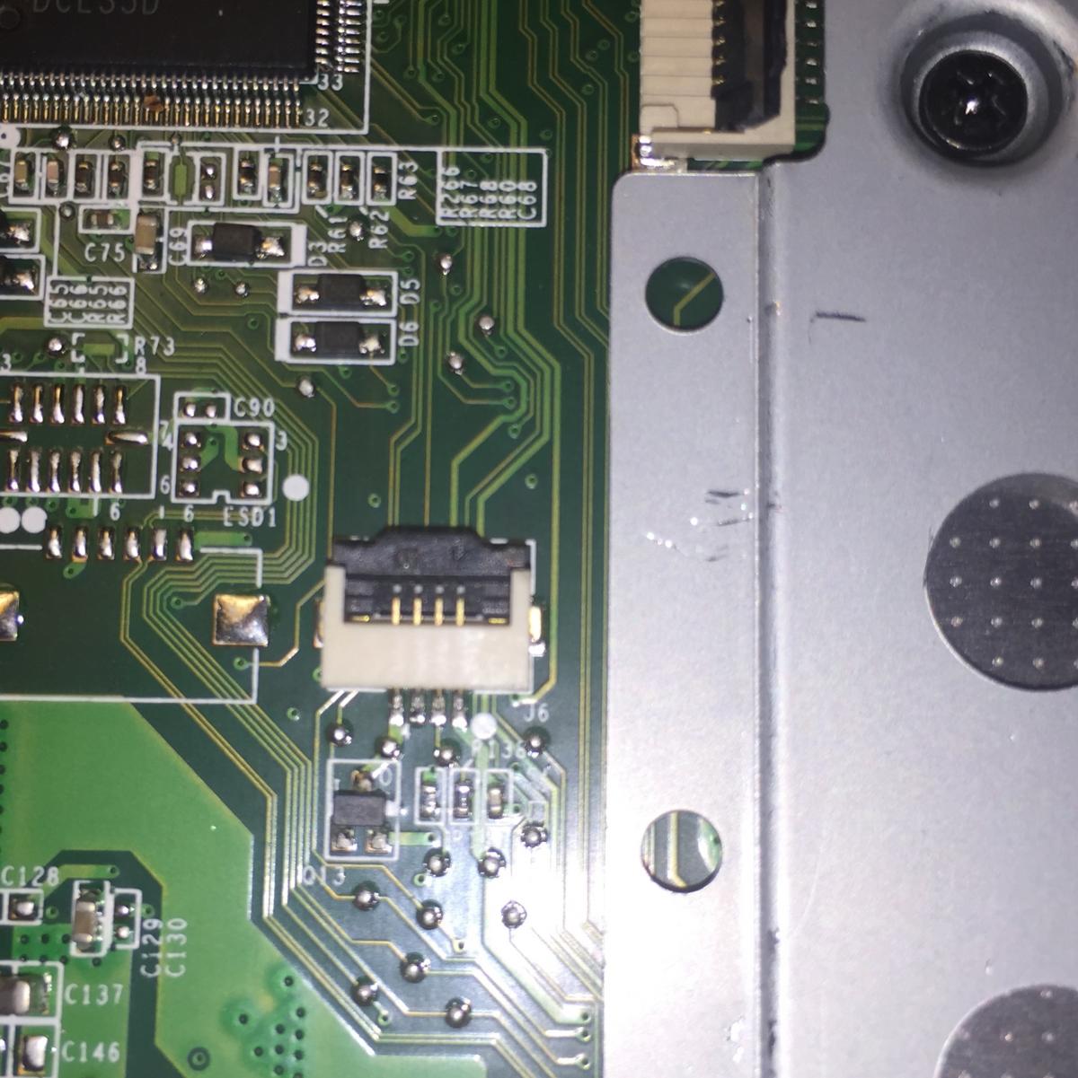

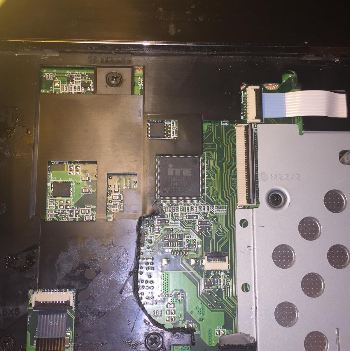

I know this isn't the best place for this, but since quite a few N4110 (and other) users use this thread, I just wanted to post that it is possible to add a backlit keyboard to the N4110.
Here is the stock keyboard.  It can be removed by pushing in 4 clips at the top of the keyboard and sliding in a small knife or flathead screwdriver to lift it up.
Notice there is a plastic shield to the bottom of the keyboard connector, next to the optical drive.  This is where your backlight connector is hiding.  (Yes the stock keyboard looks like there is soda or something previously spilled.  Im not the original owner of this, but everything works thankfully)
I took a soldering iron  to carefully melt the plastic along the factory seams to remove this covering.  In retrospect, I didn't need to remove that much, but it is what it is.  Keep in mind this picture was taken as soon as I removed it, so I haven't sanded or smoothed it out.
Here is what the work was done for.  The hidden ribbon connector.  It is labeled J6.
Just to confirm this is the right connector, I found the schematic for this motherboard:
http://www.s-manuals.com/pdf/motherboard/quanta/quanta_v02,_r01_r1a_20110119_schematics.pdf
Take a look at page 30, Key board illumination.  The connector is also labeled J6.  Wahoo.  (the Vostro 3450 also uses this board, and has a backlit keyboard option, so it also makes sense)
Here is the keyboard Im going to be using.  Notice the additional small ribbon cable that wasn't there on the stock keyboard.  This is what will plug into the J6 connector.

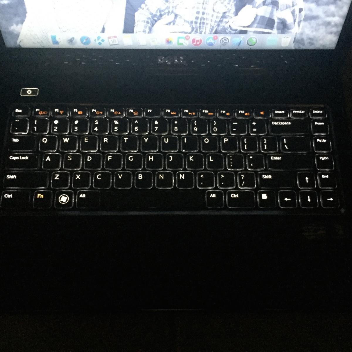

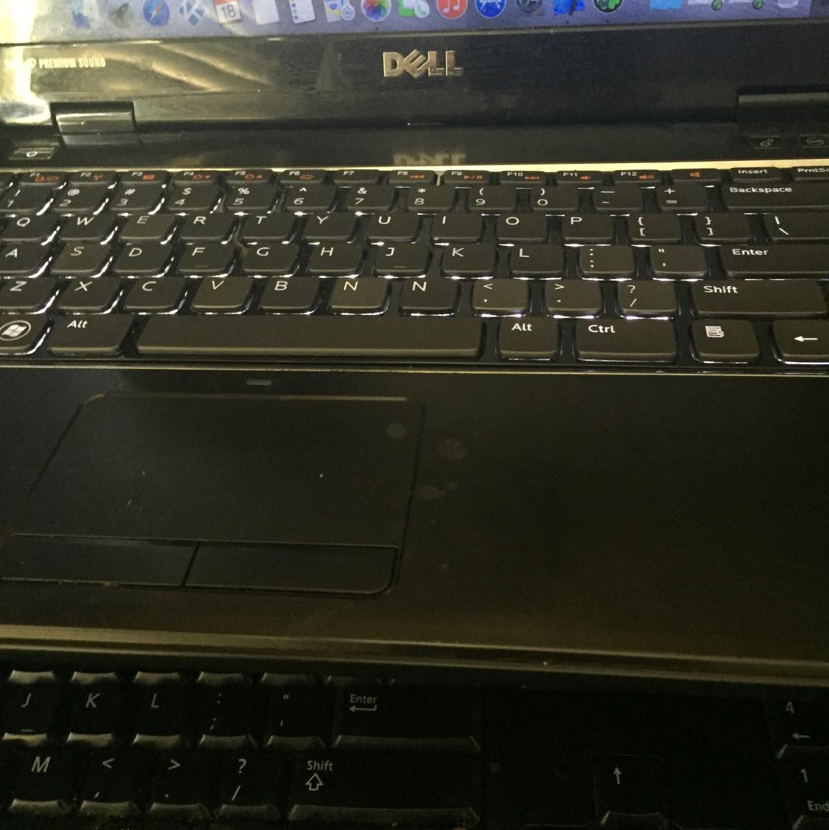

Success:
Fn + F6 Dims backlight on first press, FN + F6 turns off backlight on 2nd, and on 3rd returns to full brightness.

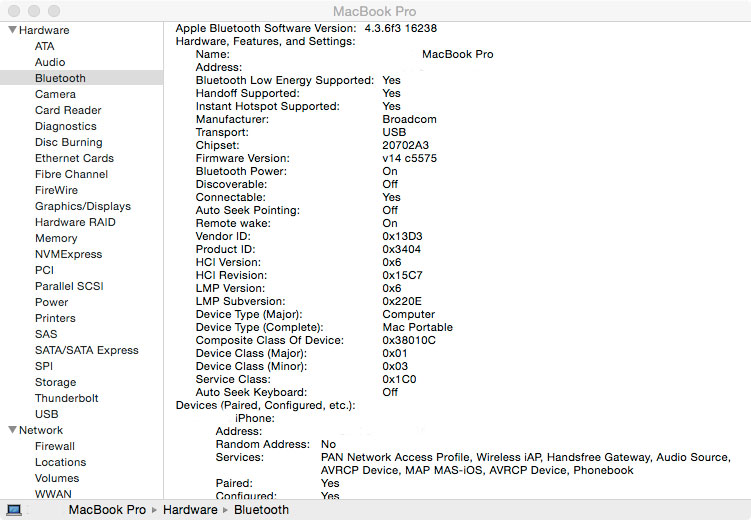

My WiFi + Bluetooth mini card
HP Broadcom BCM94352HMB 4352 WiFi+ BT 4.0 867 Mbps Card 802.11ac SPS:724935-001
Hi Sergio,
I have same laptop. Is your Bluetooth, and webcam working, if so can you share info on how did you make it work? Also, how to disable ATI graphics?
Thanks in advance,
Andy
For 94352hmb (mines an azureware, but it shouldn't matter)

For 5.0ghz, BT, handoff
Installation
  1. Kext/binary patch
    1. Download (View Raw) wireless_bcm94352-110-v4.0.command.zip
    2. Double click Downloads/wireless_bcm94352-11-v4.0.command
      1. Select patch:
        1. Patch: 2
          1. Handoff/BCM94352/US-FCC
        2. Patch: 3
          1. Handoff/BCM94352/Country Code
Im in the US, so I chose patch 2, and when it said complete, I restarted, done.
Credit:Toleda

Thanks for these steps!
My WiFi was working before I tried above command (patch 2), I don't see bluetooth anywhere. Any ideas?

https://github.com/toleda/wireless_half-mini
Be sure to read through the readme.md
Also, make sure bt is active in networking and bt preferences

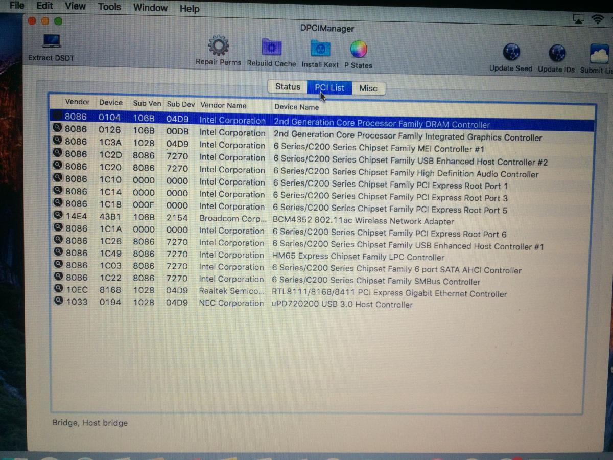

Most of features on my Dell Vostro 3450 are working
(WiFi, LAN, Audio, Trackpad, Sleep, Battery)
However, none of my USB ports are working.
Anyone got USB working on Dell Vostro 3450
See attached screenshot of DPCIManager (PCI List)
USB 2.0 (Intel 6 Series/C200 Chipset Family USB Enhanced Host Controller)
USB 3.0 Host Controller (NEC Corporation)
