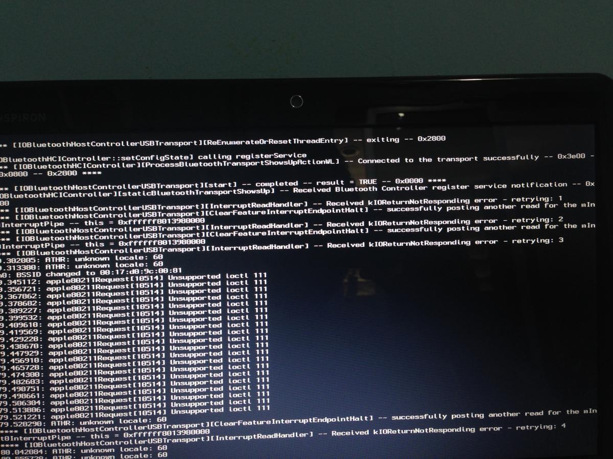

Secondly, i have upgraded to Yosemite 10.10 beta 4 and funny enough my wifi is working, profile is correct, now i am trying to get bluetooth to work. smh.
Clean installed Yosemite using AptioFix2 driver. With this driver, Yosemite installer creates a boot entry in BIOS called Mac OS X which does not work as it does not point to Clover. This creates NVRAM issues and slows down the system. It's better to use emuVariable with AptioFix with the installer.
I'm able to use my bluetooth devices like the Magic Trackpad with Yosemite PB 6. I'm using AzureWave CE123H which is Broadcom BCM4352 + BCM20702BT.
