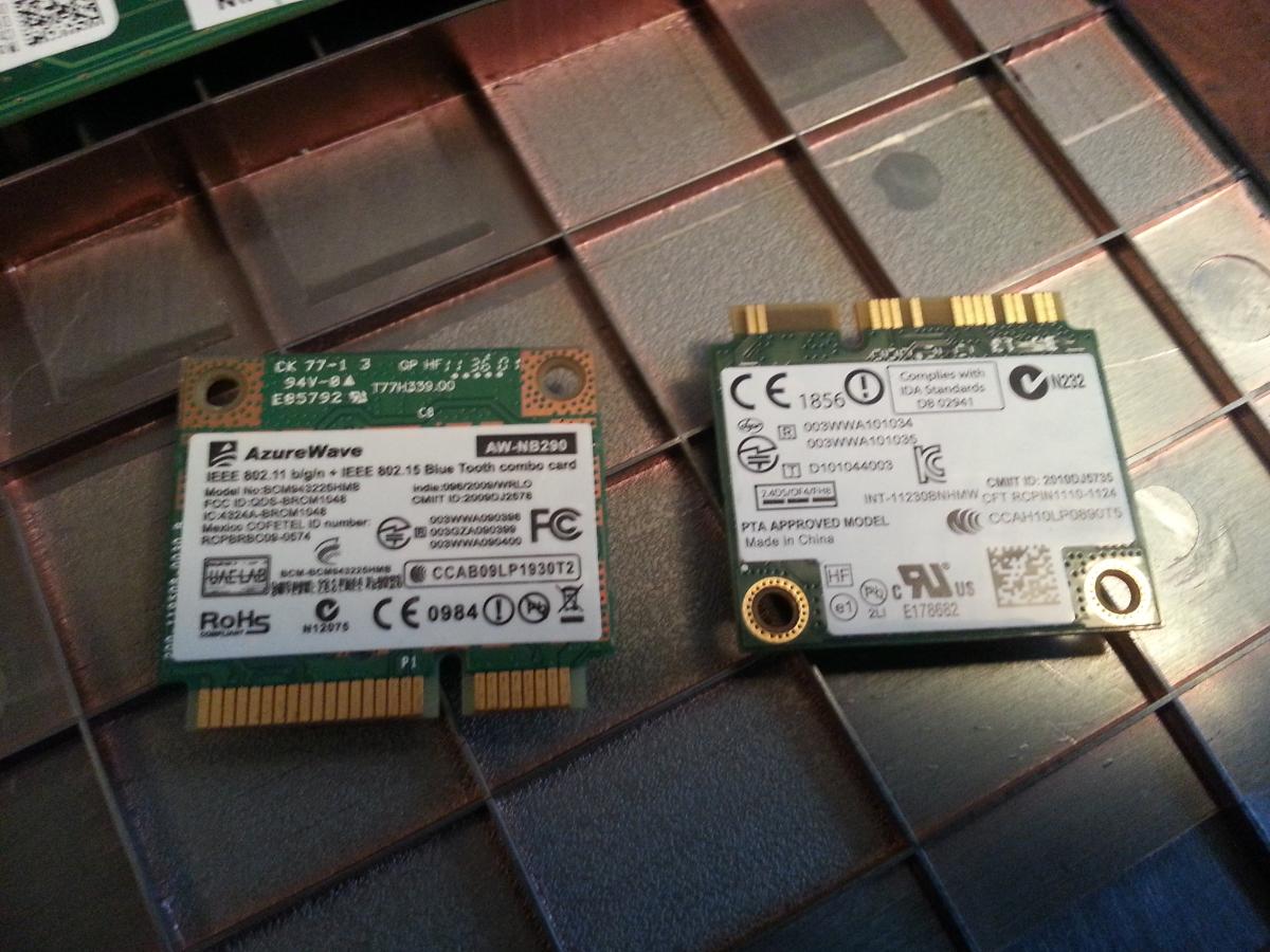

well the kext file must not be loading. I have that exact card...
You don't have the exact card, as you are saying it shows up as BCM43227 in LSPCI, but it should be showing up as Broadcom Corporation BCM43225 802.11b/g/n.
Maybe they came up with a new revision of AW-NB290 and it doesn't have the same chipset anymore. Carefully read the label on your card, it should tate the chipset it is based on.
Similar story about the card not being what it should be and audio issues -> HERE

the card and label look same, the only different that i see is the sticker is on the other side of the card. mine has printed NB290 on the board that your pic is facing.
I attached a photo of my card... I must be doing something wrong...
Model: BCM943226HMB != BCM943225HMB
It indeed seems like a new revision, your card is not supported.
