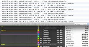

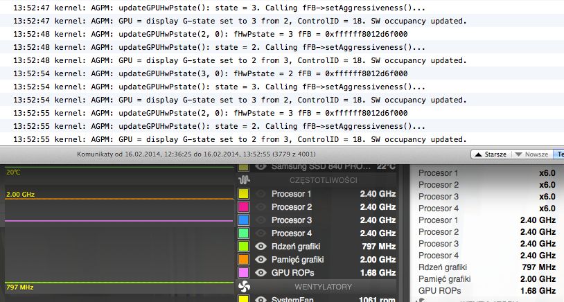

I have GTX 570 SC on board, 10.9.1 Mavericks. AGPM in OSX is working fine, but freq of my GPU stays solid on 3D [high]. Not sure why - if AGPM works fine - GPU wont throttle down, there is no link ?
My GPU in Windows 7 idling with temps 24-25'C, while in Mavericks I have 30-35'C.
AGPM info.plist

What about 13C64?  I can't believe this bug is going to persist through 2 updates...
The actual bug seems to have been around since at least 10.8.5. It just gets triggered more easily in Mavericks. Most notably Preview and QuickLook can now trigger it.
And the latest nvidia web driver beta (b15) still doesn't fix it. Not looking good.
PimentelX86: There's a bug with Kepler cards where OpenCL causes the card to get stuck in a high power state. This has been around since Mountain Lion, but Mavericks uses OpenCL a lot more at the system level.
For example, if I open a picture with Preview my card won't clock back down until I reboot.
