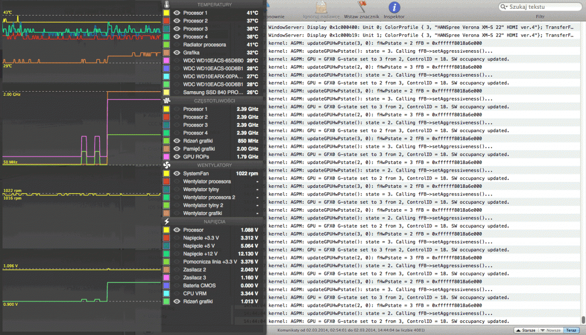

I use a Kepler (GTX650 OC), the GPU frequency will stuck to 1.2GHz after preview a picture.
This issue has been found since 10.8.2, after upgrading to 10.9.2 yesterday and the issue remains...
only restart computer helps..sleep won't help...

I have tried and it does not help. Clocks stay at high state after using Luxmark or Quicklook.

This is great news!!! I just did it and it works great! About time. No need to add any kernel flags, the driver installation itself adds the flag. The only thing needed now is an update to cuda. Just brilliant
