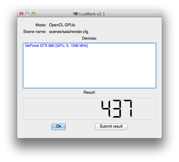

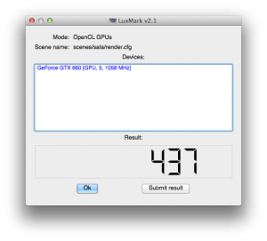

This is the benchmark score I got.
After the benchmark it went back down to 1.08 GHZ
Here is my lowest clock state.
I get the same luxmark score when starting from a "non-stuck" state as I do from a "stuck" state.
Also the clock remains stuck at 1.08GHz after running luxmark. So I guess more confirmation it is OpenCL  -_-
