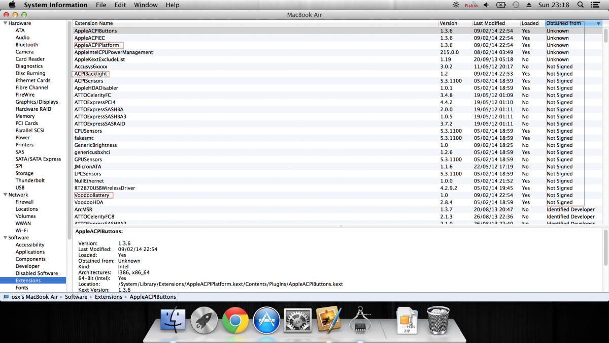

I just copied the smbios section in my original config.plst to your new config.plst. Reboot and all booting ok now.
Brightness slider works perfect. No battery "present". X where % should be. All settings from previous display program are gone.
Holy F!! It works. Just make sure you kext drop all 3 in that recent download file you provided. Tested sleep and display dim after 1 minute. I think it works!!!!
Edit. Left it for longer than 1 minute and won't resume. Can have hard disk go to sleep? I have that checked.
Ok so with that hard drive checked it wouldn't wake up but I have monitor go off after 1 min and sleep kick in after 5 min and NOT the hard drive sleep checked and it seems to be working.

I see ACPIBacklight.kext + "Brightness Fix (HD3000/HD4000)" from my laptop repo must have worked...
And I would not recommend a rollback of AppleACPIPlatform as it breaks Ivy CPU power management.
yes, exaclty the one for ivy bridge....
Appleacpiplatform is needed for voodoobattery...

Just so you know Ivy PM is now broken... It is better to patch DSDT for battery instead of rolling back to Snow Leopard AppleACPIPlatform. But it is your computer, your choice.
