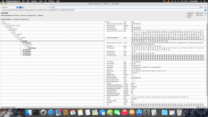

iHackintosh_PT Posted June 15, 2015 Share Posted June 15, 2015 You are right, Desktop or Mobility! Sorry! Can you save in blind mode your ioreg? I did it with black screen! Wait till desktop load, then hit "i" (I have ioregexplorer on desktop), then hit command+O to open it, then hit command+S to save it somewhere, and then hit Enter! You done! Reboot without amd drivers and check if in saved file amd drivers was loaded, if so, your problem is patching connectors! Good luck! I can log on remotely to my desktop and save the iroreg with the kexts loaded.Iv tried already,all the frames from 6000 controller,just didn't try to patch any yet.I have a triple monitor setup,HDMI,DVI, and VGA,im trying also,only with one Display connected.Thanks for the ioreg tip,i will try it right away. I can log on remotely to my desktop and save the iroreg with the kexts loaded.Iv tried already,all the frames from 6000 controller,just didn't try to patch any yet.I have a triple monitor setup,HDMI,DVI, and VGA,im trying also,only with one Display connected.Thanks for the ioreg tip,i will try it right away. EDIT:I have 2 Partitions,one to boot from if i messed up,just in case. Link to comment https://www.insanelymac.com/forum/topic/291117-how-to-make-radeon-desktop-or-mobility-be-working-by-using-clover/page/9/#findComment-2145389 Share on other sites More sharing options...
Rikoshet Posted June 15, 2015 Share Posted June 15, 2015 I can log on remotely to my desktop and save the iroreg with the kexts loaded.Iv tried already,all the frames from 6000 controller,just didn't try to patch any yet.I have a triple monitor setup,HDMI,DVI, and VGA,im trying also,only with one Display connected.Thanks for the ioreg tip,i will try it right away. EDIT:I have 2 Partitions,one to boot from if i messed up,just in case. Well, if kexts are loaded your problem are connectors! Just follow some tuts! Link to comment https://www.insanelymac.com/forum/topic/291117-how-to-make-radeon-desktop-or-mobility-be-working-by-using-clover/page/9/#findComment-2145397 Share on other sites More sharing options...

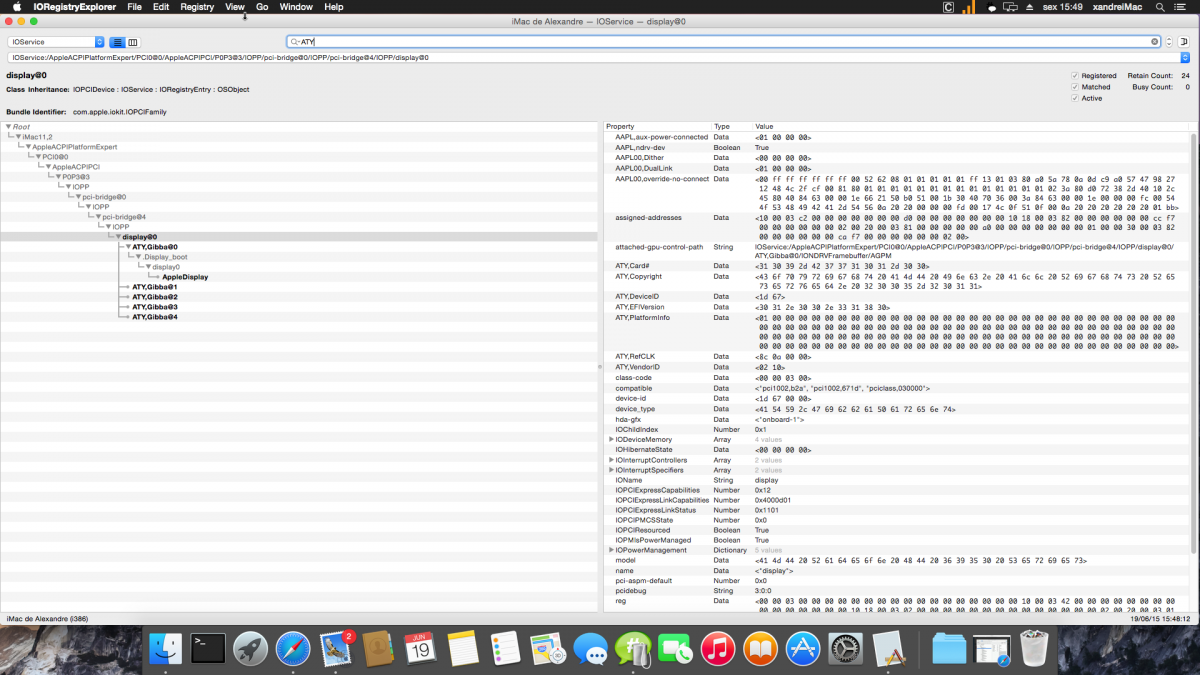

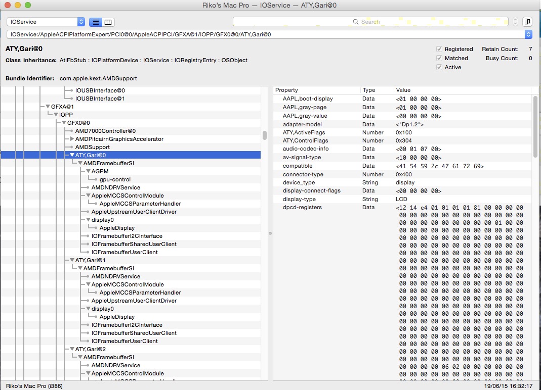

iHackintosh_PT Posted June 19, 2015 Share Posted June 19, 2015 Rikoshet do you know inside iOReg,what should i look for,to check Framebuffer issues ? Link to comment https://www.insanelymac.com/forum/topic/291117-how-to-make-radeon-desktop-or-mobility-be-working-by-using-clover/page/9/#findComment-2146464 Share on other sites More sharing options...
4everAnoob Posted June 19, 2015 Share Posted June 19, 2015 Manual creation, of course. You control what you want to do with it Well yes of course that would be ideal. But is there a tool out there at all similar to myHack now? And unfortunately I spoke too soon about my HP. The graphics acceleration is still not working correctly. There is no transparency and dragging a window causes tearing. Sleep and even resume does work correctly though. I'm really not sure what I can do now. Or is it still simply a matter of adjusting the frame buffer (in my case Cattail) to fix this? Link to comment https://www.insanelymac.com/forum/topic/291117-how-to-make-radeon-desktop-or-mobility-be-working-by-using-clover/page/9/#findComment-2146478 Share on other sites More sharing options...
Rikoshet Posted June 19, 2015 Share Posted June 19, 2015 Rikoshet do you know inside iOReg,what should i look for,to check Framebuffer issues ? Sure: Link to comment https://www.insanelymac.com/forum/topic/291117-how-to-make-radeon-desktop-or-mobility-be-working-by-using-clover/page/9/#findComment-2146481 Share on other sites More sharing options...
iHackintosh_PT Posted June 19, 2015 Share Posted June 19, 2015 Sure: Would these "ATY Gibba@0 @1 @2 @3 @4" be my 4 Display-Ports and the DVI ? Link to comment https://www.insanelymac.com/forum/topic/291117-how-to-make-radeon-desktop-or-mobility-be-working-by-using-clover/page/9/#findComment-2146489 Share on other sites More sharing options...
Rikoshet Posted June 19, 2015 Share Posted June 19, 2015 Would these "ATY Gibba@0 @1 @2 @3 @4" be my 4 Display-Ports and the DVI ? From mine picture you can see you missed some amd files loading.... Even if you have screens black you MUST have amd kexts loaded! And then....patching connectors! Link to comment https://www.insanelymac.com/forum/topic/291117-how-to-make-radeon-desktop-or-mobility-be-working-by-using-clover/page/9/#findComment-2146494 Share on other sites More sharing options...
