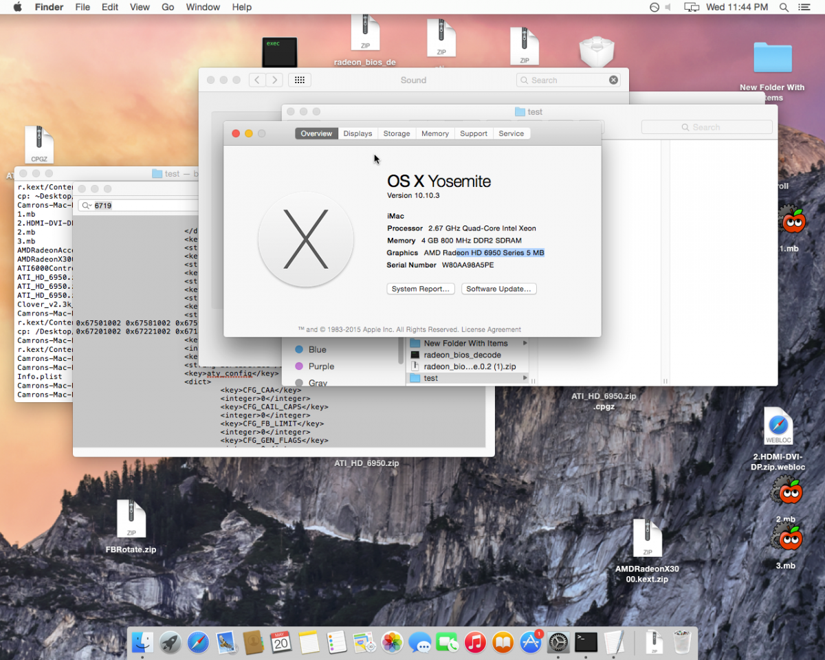

vonboogerstein Posted May 21, 2015 Share Posted May 21, 2015 Thanks for your hard work everyone! I'm a newbie learning the ropes still... my system is ga ep45-ud3r with AMD radeon 6950 2gb, 4gb dd2 I attached a screen shot that shows my gfx is not working at 2gb instead it is only 5mb. This is progress because before I followed this guide it was only 3mb and before installing clover it said intel 3mb. I'm trying to think of next steps. Something to do with ati-personality.pl? Link to comment https://www.insanelymac.com/forum/topic/291117-how-to-make-radeon-desktop-or-mobility-be-working-by-using-clover/page/8/#findComment-2137420 Share on other sites More sharing options...
Slice Posted May 21, 2015 Author Share Posted May 21, 2015 Thanks for your hard work everyone! I'm a newbie learning the ropes still... my system is ga ep45-ud3r with AMD radeon 6950 2gb, 4gb dd2 I attached a screen shot that shows my gfx is not working at 2gb instead it is only 5mb. This is progress because before I followed this guide it was only 3mb and before installing clover it said intel 3mb. I'm trying to think of next steps. Something to do with ati-personality.pl? according to first post. I see smile tomato on your desktop. Probably it is the real reason of your problems. Link to comment https://www.insanelymac.com/forum/topic/291117-how-to-make-radeon-desktop-or-mobility-be-working-by-using-clover/page/8/#findComment-2137660 Share on other sites More sharing options...
vusun123 Posted May 22, 2015 Share Posted May 22, 2015 Smiling tomato is one thing, but he said Intel 3MB, probably he didn't disable the iGPU completely here Link to comment https://www.insanelymac.com/forum/topic/291117-how-to-make-radeon-desktop-or-mobility-be-working-by-using-clover/page/8/#findComment-2137837 Share on other sites More sharing options...

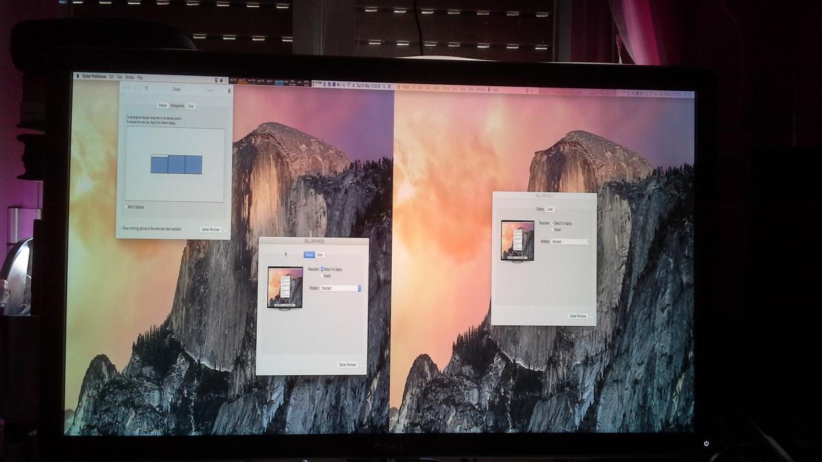

Rikoshet Posted June 10, 2015 Share Posted June 10, 2015 Transmitter and encoder might be involved with these issues Hi vusun123! I did some progress, i have now 4k@60Hz with correct aspect ratio and Gari personality, but the mac os still see it like 2 1920x2160 monitors. The thing is very annoying, the menu bar is only at half of my screen... Is there a way/boot flag/terminal command to tie 2 displays? Now I have a question guys: any personality has some order of connectors, right? Is it a problem if I not respect this order in my DSDT? I must inject some properties in DSDT otherwise I have kernel panic. So, in DSDT I injected @0 LVDS, @1 DP, @2 HDMI. Now, trying various personalities only with some of them I have a signal on DP (will talk about DP 'cause this port I'm interested in for now) with others I have no signal...so, could it be because the order of connectors in chosen personality does not correspond with order and type of connectors injected in DSDT? I have not found any info about it... And, does the order of connectors of any personality correspond to order of physical connectors of my GPU? Thank you! Link to comment https://www.insanelymac.com/forum/topic/291117-how-to-make-radeon-desktop-or-mobility-be-working-by-using-clover/page/8/#findComment-2143516 Share on other sites More sharing options...
vusun123 Posted June 10, 2015 Share Posted June 10, 2015 Hi vusun123! I did some progress, i have now 4k@60Hz with correct aspect ratio and Gari personality, but the mac os still see it like 2 1920x2160 monitors. The thing is very annoying, the menu bar is only at half of my screen... Is there a way/boot flag/terminal command to tie 2 displays? Now I have a question guys: any personality has some order of connectors, right? Is it a problem if I not respect this order in my DSDT? I must inject some properties in DSDT otherwise I have kernel panic. So, in DSDT I injected @0 LVDS, @1 DP, @2 HDMI. Now, trying various personalities only with some of them I have a signal on DP (will talk about DP 'cause this port I'm interested in for now) with others I have no signal...so, could it be because the order of connectors in chosen personality does not correspond with order and type of connectors injected in DSDT? I have not found any info about it... And, does the order of connectors of any personality correspond to order of physical connectors of my GPU? Thank you! In laptop personality, LVDS is always first. In the others, I don't know, since we need a real Mac with AMD GPU's IOREG to find out. About the display, I dunno either, since I don't own a desktop with AMD GPU anymore Link to comment https://www.insanelymac.com/forum/topic/291117-how-to-make-radeon-desktop-or-mobility-be-working-by-using-clover/page/8/#findComment-2143536 Share on other sites More sharing options...
Rikoshet Posted June 10, 2015 Share Posted June 10, 2015 In laptop personality, LVDS is always first. In the others, I don't know, since we need a real Mac with AMD GPU's IOREG to find out. About the display, I dunno either, since I don't own a desktop with AMD GPU anymore No, neither I have a desktop, I'm talking about my laptop in sig. Now I'm looking to ioreg and dsdt and don't understand one thing: you say in laptop LVDS is always first...now, in gari personality LVDS is first, in my dsdt LVDS is @0, so why in ioreg on @0 and @1 is my DP and LVDS is on @2? Maybe I'm doing something wrong? Thank you! Link to comment https://www.insanelymac.com/forum/topic/291117-how-to-make-radeon-desktop-or-mobility-be-working-by-using-clover/page/8/#findComment-2143563 Share on other sites More sharing options...
Rikoshet Posted June 10, 2015 Share Posted June 10, 2015 DualLink=true? Hi Slice! Sorry, I was not knew that DualLink is a clover thing, discovered it today.... Anyway, DualLink=true gives me the same double image on screen but vertically stretched ... Any idea why I am the only one who has double image? Even in ioreg I have the same monitor on 2 connectors... Thank you! Link to comment https://www.insanelymac.com/forum/topic/291117-how-to-make-radeon-desktop-or-mobility-be-working-by-using-clover/page/8/#findComment-2143611 Share on other sites More sharing options...
