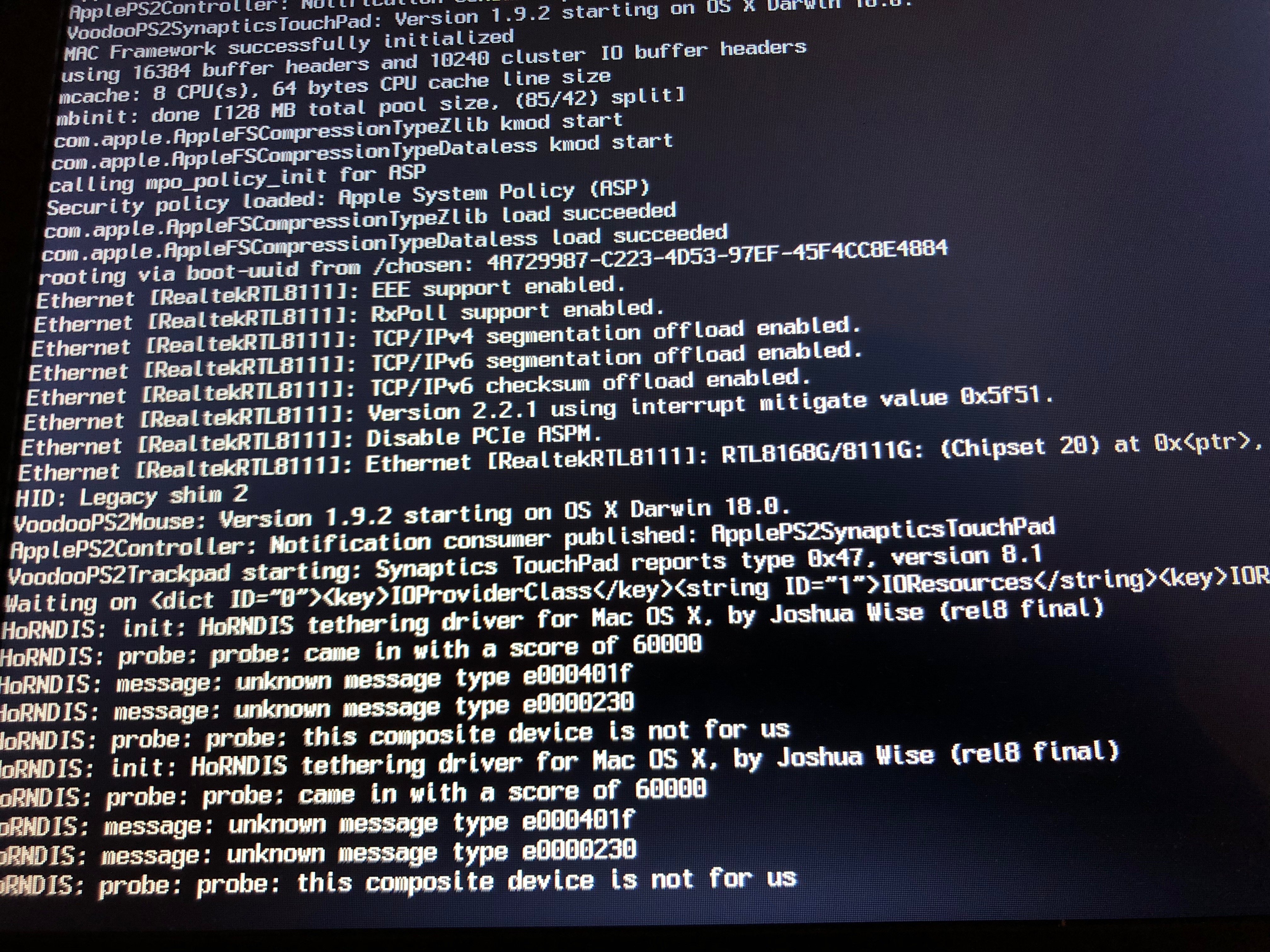

Everything worked correctly in my EFI partition, my SSDT was replaced by the new one besides of the config. Added my SMBIOS and restarted my computer.
Now I'm stuck at the boot, when it gets to HoRNDIS (probe: probe: this composite device is not for us) it freezes (pic attached) and then it shows a prohibited symbol.
Tried to update Clover but still not booting, I'm using Clover_v2.4k_r4699.
Thank you!

Is your SATA mode set to AHCI?
I'm not able to change any SATA settings in my BIOS, just the Boot Options and a few Intel options like USB 3.0.
Installed MacOS in UEFI without Secure Boot as you described in your guide.
Attach full PR files as per Envy guide.  Use your USB to boot if needed.
Note: If your SATA mode is fixed as RAID (iRST), we can simply add SATA-unsupported.kext.
FYI: Added SATA-RAID-unsupported.kext to repo/install_downloads.sh just in case.
PR files attached.
Forgot to mention that I needed to install OsxAptioFixDrv-64.efi in Drivers64UEFI to boot properly in High Sierra, also I'm using MacBookPro11,2 due to it's been working correctly since Mavericks (iMessage and FaceTime).
Thanks again!

SATA is in RAID (iRST) mode.
Note 8086:282a in misc/preboot.log:
0:122  0:000  === [ GetDevices ] ========================================
0:122  0:000  PCI (00|00:1F.02) : 8086 282A class=010400
SATA-RAID-unsupported.kext should take care of your booting problem.
We are now typically using AptioMemoryFix-64.efi instead of OsxAptioFix*.efi.
Also, ApfsDriverLoader-64.efi+AppleImageLoader-64.efi instead of apfs.efi.

Wow, you're a beast, only 4 minutes to answer me!
Thank you so much, will try now!
EDIT: It works like a charm, thank you @RehabMan!
