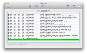

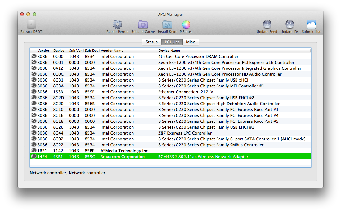

toleda Posted October 1, 2013 Share Posted October 1, 2013 Hi Toleda - your bcm4352.kext.zip works well here. On my board the WIFI is supposed to work in both 2.4 & 5GHz bands, seems fine with 2.4 but no 5GH. Any ideas? Tks. I have the same issue, not solved. Hi there. I've just installed 10.8.5 on a Z87I-Deluxe board. It boots up fine, ethernet works, but I don't have sound or BT or wifi yet? Just to clarify, will both of these fixes work with ML or do they only work with Mavericks DP? For 10.8.5 1150 audio, see Mountain Lion Realtek ALC AppleHDA Audio - OSx86 10.8 (Mountain Lion) - InsanelyMac Forum For 10.8.5 HDMI and/or DP audio, see Mountain Lion Realtek ALC AppleHDA Audio - OSx86 10.8 (Mountain Lion) - InsanelyMac Forum For Airport/BCM4352 kext or dsdt enablers, see toleda/airport_pcie-hm · GitHub. Link to comment https://www.insanelymac.com/forum/topic/290187-asus-z87-deluxe-4770k-a-guide-to-mavericks/page/3/#findComment-1950062 Share on other sites More sharing options...

toleda Posted October 2, 2013 Share Posted October 2, 2013 I just swapped out my motherboard (z87i-deluxe for h87i-plus), so I already have a patched appleHDA.kext. I understand I need to get the native one back again to install the 1150 patch. How exactly do I do this? The guide mentioned the combo update -- I'm already at the latest version of OS X, The instructions do not apply to the H87I-Plus; it has the 887 codec and doesn't have BCM4352 WiFi. For 10.8.5 887_v100302 audio, see Mountain Lion Realtek ALC AppleHDA Audio - OSx86 10.8 (Mountain Lion) - InsanelyMac Forum The script patches the installed AppleHDA.kext (patch in place). The Combo Update installs the native AppleHDA.kext over whatever is there; no need to look for a posted native kext. Regarding the audio enabler, use Audio ID: 1 for motherboard labeled 3 port audio (2 inputs, 1 output). Use Audio ID: 2 for 5.1 Analog (3 outputs). Any enabler is fine, suggest the ssdt. For WiFI, download http://sourceforge.net/projects/dpcimanager/, reply with the a screenshot of PCI List. Link to comment https://www.insanelymac.com/forum/topic/290187-asus-z87-deluxe-4770k-a-guide-to-mavericks/page/3/#findComment-1950232 Share on other sites More sharing options...
wiz329 Posted October 2, 2013 Share Posted October 2, 2013 The instructions do not apply to the H87I-Plus; it has the 887 codec and doesn't have BCM4352 WiFi. For 10.8.5 887_v100302 audio, see Mountain Lion Realtek ALC AppleHDA Audio - OSx86 10.8 (Mountain Lion) - InsanelyMac Forum The script patches the installed AppleHDA.kext (patch in place). The Combo Update installs the native AppleHDA.kext over whatever is there; no need to look for a posted native kext. Regarding the audio enabler, use Audio ID: 1 for motherboard labeled 3 port audio (2 inputs, 1 output). Use Audio ID: 2 for 5.1 Analog (3 outputs). Any enabler is fine, suggest the ssdt. For WiFI, download http://sourceforge.net/projects/dpcimanager/, reply with the a screenshot of PCI List. Sorry, I wasn't very clear. I am no longer using the H87 board. I replaced it with the Z87 board. So, if I understand you correctly, I've got to: 1. Install combo update 2. Run the script 3. Run an audio enabler. What exactly is the ssdt? I do not currently have a DSDT installed, as far as I know. Thanks for your help! Link to comment https://www.insanelymac.com/forum/topic/290187-asus-z87-deluxe-4770k-a-guide-to-mavericks/page/3/#findComment-1950239 Share on other sites More sharing options...
toleda Posted October 2, 2013 Share Posted October 2, 2013 3. Run an audio enabler. What exactly is the ssdt? I do not currently have a DSDT installed, as far as I know. 3. Install an enabler, instructions (README) provided for audio_kext_enabler or audio_ssdt_enabler The ssdt edits the native dsdt/HDEF during boot and is installed in Extra. Link to comment https://www.insanelymac.com/forum/topic/290187-asus-z87-deluxe-4770k-a-guide-to-mavericks/page/3/#findComment-1950278 Share on other sites More sharing options...
wiz329 Posted October 3, 2013 Share Posted October 3, 2013 3. Install an enabler, instructions (README) provided for audio_kext_enabler or audio_ssdt_enabler The ssdt edits the native dsdt/HDEF during boot and is installed in Extra. It worked! Thanks for your patience. One final question: it put a file audio_ALC1150 onto my desktop. I assumed it was a remnant of the installation, so I removed it (after copying it somewhere else just to be safe). I found that after this, I wasn't able to boot up normally. So, I guess I have to leave this file on my desktop? For Wifi, I downloaded the program, here is the screenshot: Link to comment https://www.insanelymac.com/forum/topic/290187-asus-z87-deluxe-4770k-a-guide-to-mavericks/page/3/#findComment-1950292 Share on other sites More sharing options...
toleda Posted October 3, 2013 Share Posted October 3, 2013 It worked! I found that after this, I wasn't able to boot up normally. For Wifi, I downloaded the program, here is the screenshot: The audio_ALC1150 is an archive file with the original and patched AppleHDA.kexts and a record of the edits performed. It is not necessary for booting. What was the boot problem? Since you have the Z87I Deluxe, WiFi/BT is supported. Link to comment https://www.insanelymac.com/forum/topic/290187-asus-z87-deluxe-4770k-a-guide-to-mavericks/page/3/#findComment-1950307 Share on other sites More sharing options...
wiz329 Posted October 3, 2013 Share Posted October 3, 2013 The audio_ALC1150 is an archive file with the original and patched AppleHDA.kexts and a record of the edits performed. It is not necessary for booting. What was the boot problem? Since you have the Z87I Deluxe, WiFi/BT is supported. Hmmm. It could just be a coincidence, but after I deleted the file, it froze on boot with the last line being: "HDA Enabler: 03/07/2009 Compiled for 32/64-bit by Taruga" Then it would just say "Still waiting for root device." I tried booting a couple times more, but it just kept hanging at that place. So I copied the file back to the Desktop after booting into safe mode, restarted, and it booted just fine. Link to comment https://www.insanelymac.com/forum/topic/290187-asus-z87-deluxe-4770k-a-guide-to-mavericks/page/3/#findComment-1950326 Share on other sites More sharing options...
