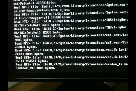

Sephiroth79 Posted October 27, 2013 Share Posted October 27, 2013 Still trying to solve the istant reboot issue I am getting while trying to installa Final Mavericks OSX version on my pc. I figured it out to make a video and then to extract a picture of the latest line the installer writes before going to reboot (disabled USB 2.0 support to get the process slower and make a video). Actual PC configuration: - Mobo: ASRock G31M-S R 2.0 with latest official Bios; - Cpu: Intel Celeron E3300@2.50 GHz - Audio/Video Onboard Maybe Celeron's CPUs are not supported? Regards. Link to comment https://www.insanelymac.com/forum/topic/289083-os-x-109-myhack-usb-installer-beta/page/8/#findComment-1959201 Share on other sites More sharing options...
AudiSport Posted October 27, 2013 Share Posted October 27, 2013 Still trying to solve the istant reboot issue I am getting while trying to installa Final Mavericks OSX version on my pc. I figured it out to make a video and then to extract a picture of the latest line the installer writes before going to reboot (disabled USB 2.0 support to get the process slower and make a video). Actual PC configuration: - Mobo: ASRock G31M-S R 2.0 with latest official Bios; - Cpu: Intel Celeron E3300@2.50 GHz - Audio/Video Onboard Maybe Celeron's CPUs are not supported? Regards. I am seeing the same reboot you are with two different G31M based systems. Both of them run Mountain Lion with no problem. They both also have nVidia PCIe graphics cards (9500 and 210). I built the USB installer with myHack 3.2 beta 8 and just tried it again with myHack 3.3. Same thing. I booted the USB on an i3 based laptop and it worked so I don't think it is a bad USB drive. I am beginning to wonder if anyone has Mavericks working G31M based motherboard. My guess is that it may be due to these G31M motherboards not having AHCI support. I would love to find a work around. Link to comment https://www.insanelymac.com/forum/topic/289083-os-x-109-myhack-usb-installer-beta/page/8/#findComment-1959489 Share on other sites More sharing options...

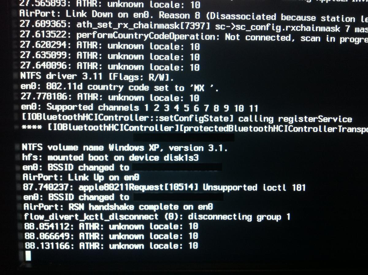

K0st Posted November 3, 2013 Share Posted November 3, 2013 Hi,i'm trying to install maverick on my laptop but i have always a blackscreen . My config (look like a mba 4.1) : Core i5 2467M,IntelHD3000,Intel HM65,SSD 128Go I've tried GraphicsEnabler: yes & no and always the same result = blackscreen =/ With PCIRootUid=No ,it freeze .I deleted NV&Ati Ktext but it change nothing . Is there a problem with the graphics ,maybe on the bios ? Link to comment https://www.insanelymac.com/forum/topic/289083-os-x-109-myhack-usb-installer-beta/page/8/#findComment-1962873 Share on other sites More sharing options...

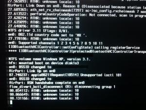

macgirl Posted November 5, 2013 Share Posted November 5, 2013 Here is where my P35-DS3L is stuck: Link to comment https://www.insanelymac.com/forum/topic/289083-os-x-109-myhack-usb-installer-beta/page/8/#findComment-1963757 Share on other sites More sharing options...
theconnactic Posted November 5, 2013 Share Posted November 5, 2013 This is a framebuffer/general graphics issue. Try: - safe boot (-x); - GraphicsEnabler=No; - both steps above at the same time. If no luck, remove all graphics kexts from your /S/L/E and you'll get to the desktop in VESA mode. Reinstall all graphics kexts with latest kext utility, then sudo touch /System/Library/Extensions and diskutil repairPermissions / Good luck! Link to comment https://www.insanelymac.com/forum/topic/289083-os-x-109-myhack-usb-installer-beta/page/8/#findComment-1964051 Share on other sites More sharing options...
