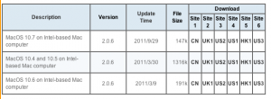

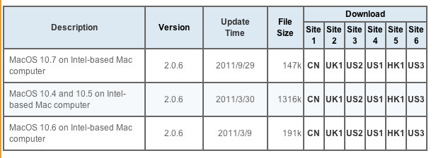

Slice Posted December 11, 2014 Share Posted December 11, 2014 Outta curiosity, did you try the driver provided by realtek? This driver is very old and is not working properly. That's why we created new drivers. Link to comment https://www.insanelymac.com/forum/topic/287161-new-driver-for-realtek-rtl8111/page/34/#findComment-2094173 Share on other sites More sharing options...

tluck Posted December 11, 2014 Share Posted December 11, 2014 @dr hurt - thanks for the link to the realtek site. surprise! that (old) driver seems to be stable for me under 10.10.2 on my H61-USB3 system. all the other versions (slice, hhak, mieze, rehabman) will hang after 10-15 minutes on Yosemite. Note: all these others do work just fine under Mavericks 10.9.5 though. Anyway, and I am running this box on a 100base-T network (off my wireless extender) ... so i don't need TSO or anything "fancy". I did buy an alternative USB3 to GigE port that is working on yosemite too. but its good to have the native port as well. I had a similar experience with my laptop where all the newer 2.5 and 3.x versions for the Intel E1000e card hang after a short while. But an older version (less featured) is the only one that is stable... Link to comment https://www.insanelymac.com/forum/topic/287161-new-driver-for-realtek-rtl8111/page/34/#findComment-2094297 Share on other sites More sharing options...

Dr. Hurt Posted December 12, 2014 Share Posted December 12, 2014 I did not mean to disrespect or blame anyone. I was merely reporting my observation because it kinnda surprised me. I really appreciate your work on this driver and the excellent driver for the rtl8100 series. Link to comment https://www.insanelymac.com/forum/topic/287161-new-driver-for-realtek-rtl8111/page/34/#findComment-2094423 Share on other sites More sharing options...

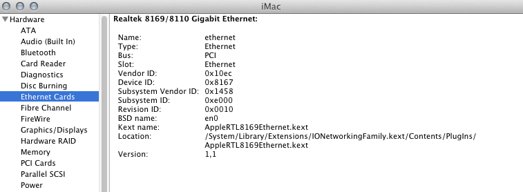

Dr. Hurt Posted January 17, 2015 Share Posted January 17, 2015 Mieze, Could you please add support for the RTL8110 Gigabit Ethernet (8167-10ec)? I added the device I'd to the info.plist of your kext but ended up with the following error: kernel[0]: Ethernet [RealtekRTL8111]: region #2 not an MMIO resource, aborting. PS. The driver provided by realtek has the device id and loads, but the ethernet is stuck with a self assigned ip and cannot connect to internet. Manually assigning IP says connected but doesn't work. PS. 2 Windows too appears to be using the same 8168 driver for it so I think the chipsets are close enough to be supported by this driver. Link to comment https://www.insanelymac.com/forum/topic/287161-new-driver-for-realtek-rtl8111/page/34/#findComment-2103716 Share on other sites More sharing options...
Mieze Posted January 21, 2015 Author Share Posted January 21, 2015 Mieze, Could you please add support for the RTL8110 Gigabit Ethernet (8167-10ec)? I added the device I'd to the info.plist of your kext but ended up with the following error: PS. The driver provided by realtek has the device id and loads, but the ethernet is stuck with a self assigned ip and cannot connect to internet. Manually assigning IP says connected but doesn't work. PS. 2 Windows too appears to be using the same 8168 driver for it so I think the chipsets are close enough to be supported by this driver. No, sorry this isn't possible as the underlying Linux driver only supports PCIe devices and the RTL8110 is a PCI device. Besides that writing an OS X driver for a PCI NIC is completely different, as those 32bit devices can't do DMA operations with 64 bit addresses. Mieze 1 Link to comment https://www.insanelymac.com/forum/topic/287161-new-driver-for-realtek-rtl8111/page/34/#findComment-2104384 Share on other sites More sharing options...
Dr. Hurt Posted January 21, 2015 Share Posted January 21, 2015 No, sorry this isn't possible as the underlying Linux driver only supports PCIe devices and the RTL8110 is a PCI device. Besides that writing an OS X driver for a PCI NIC is completely different, as those 32bit devices can't do DMA operations with 64 bit addresses. Mieze Ouch!! Well, I contacted Realtek to see if they can update their PowerPC PCI ethernet driver to support recent Intel Macs. I wonder if they would actually listen (or if its technically possible). I'll keep you updated. I suppose that this means that even an RTL8111 ethernet card connected via PCI won't work with your driver?! Link to comment https://www.insanelymac.com/forum/topic/287161-new-driver-for-realtek-rtl8111/page/34/#findComment-2104456 Share on other sites More sharing options...
Mieze Posted January 21, 2015 Author Share Posted January 21, 2015 I suppose that this means that even an RTL8111 ethernet card connected via PCI won't work with your driver?! Exactly, because the 32 bit PCI bus can't do 64 bit addressing but you'll have a hard time to find such a card for economical reasons. With regard to the logical structure PCIe is based on PCI, but the electrical implementation is completely different which makes it impossible to connect a PCIe device to a PCI bus and vice versa. You'll have to put a PCIe-to-PCI-Bridge in-between making it impossible to manufacture cheap add-in cards. Mieze Link to comment https://www.insanelymac.com/forum/topic/287161-new-driver-for-realtek-rtl8111/page/34/#findComment-2104572 Share on other sites More sharing options...
Slice Posted January 26, 2015 Share Posted January 26, 2015 Mieze, Could you please add support for the RTL8110 Gigabit Ethernet (8167-10ec)? I added the device I'd to the info.plist of your kext but ended up with the following error: PS. The driver provided by realtek has the device id and loads, but the ethernet is stuck with a self assigned ip and cannot connect to internet. Manually assigning IP says connected but doesn't work. PS. 2 Windows too appears to be using the same 8168 driver for it so I think the chipsets are close enough to be supported by this driver. This card is supported by existing driver (8169) on my computer. Link to comment https://www.insanelymac.com/forum/topic/287161-new-driver-for-realtek-rtl8111/page/34/#findComment-2105707 Share on other sites More sharing options...
