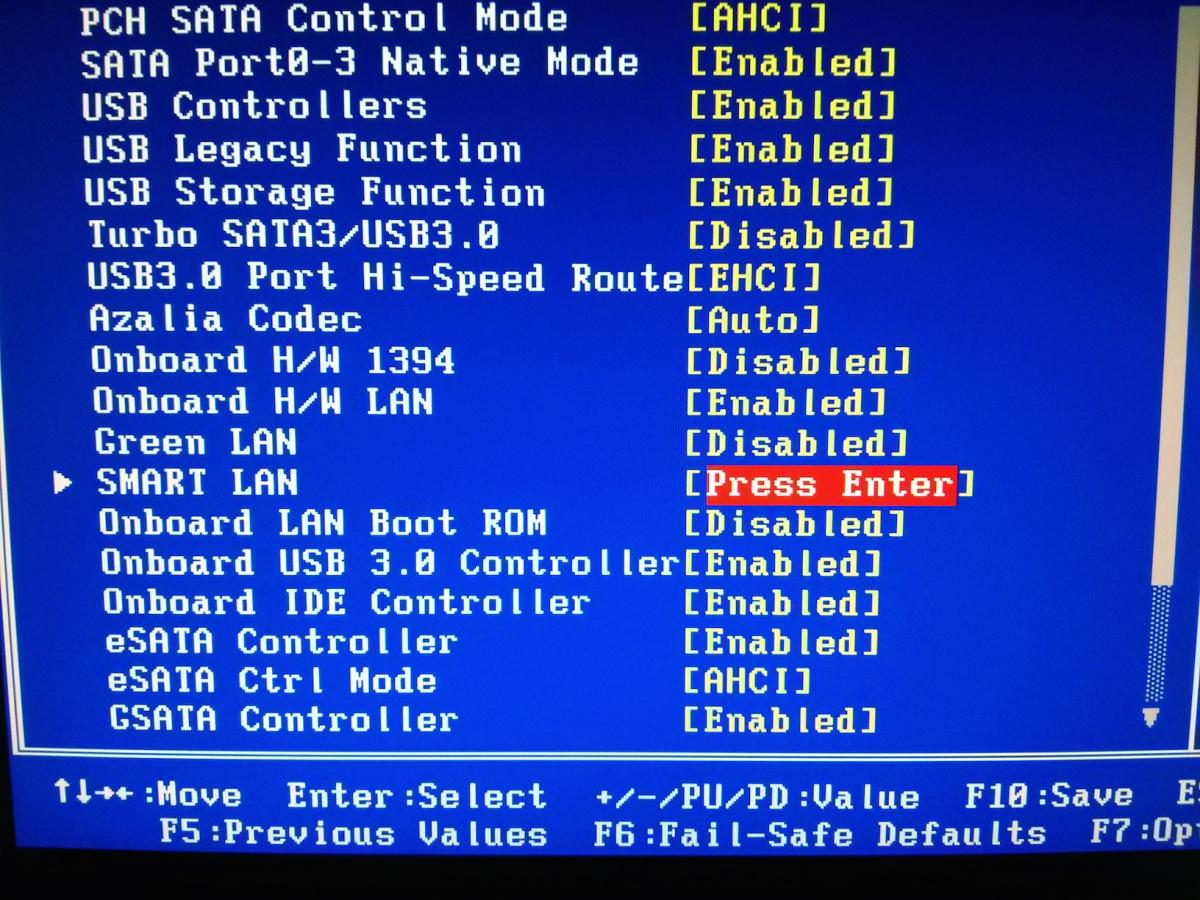

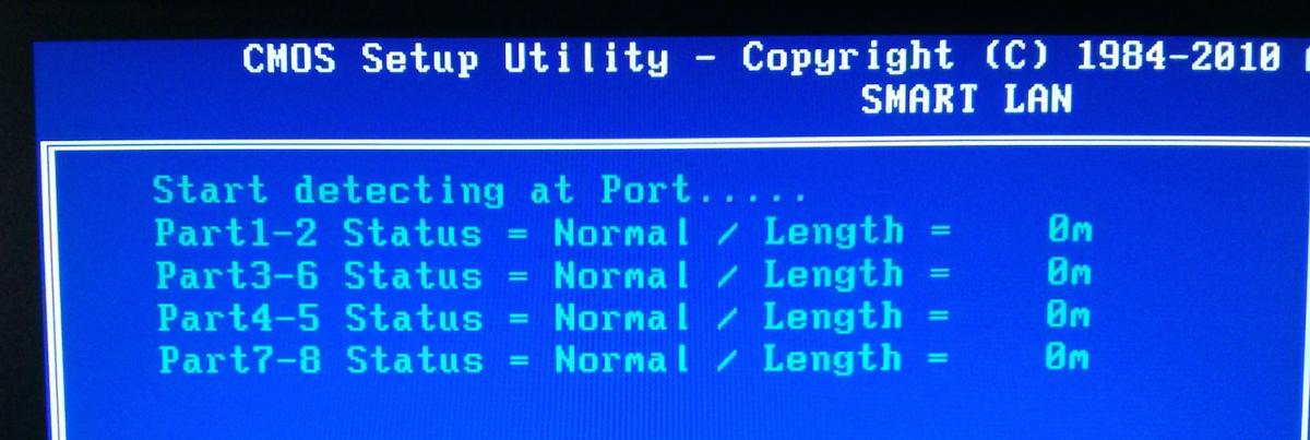

MilesTEG1 Posted August 15, 2014 Share Posted August 15, 2014 Try to get an add-in card with a RTL8111E because these chips work best and are well tested. I'm using this chip in my server with the driver since march 2013 and never lost connection. I'd recommend the Delock 89357 which I tested myself. Avoid the old RTL8111B which is still found on many ultra cheap cards as these chips have more bugs and less offload functions. In case the manufacturer doesn't mention the chip used, have a look at the PCIe compatibility spec of the card which is a good hint to distinguish old and new chips. In case it's PCIe 1.1 compatible, it's equipped with a RTL8111C or newer (probably RTL8111E), but in case it's only PCIe 1.0 compatible you'll get one of the outdated RTL8111B chips. Mieze Ok, thanks for the advise. Does this card correspond to your description (photo) : http://www.amazon.fr/DeLOCK-89357/dp/B00CE11N5E/ref=sr_1_1?s=computers&ie=UTF8&qid=1408109828&sr=1-1&keywords=Delock+89357#productDetails It's a bit more expensive than the one I wanted to buy, bit If you tested it successfully, I could do the effort (I hop it will works on windows 8.1 ?) Link to comment https://www.insanelymac.com/forum/topic/287161-new-driver-for-realtek-rtl8111/page/30/#findComment-2052011 Share on other sites More sharing options...
Mieze Posted August 15, 2014 Author Share Posted August 15, 2014 Yes, it's the same card I'm using. Mieze Link to comment https://www.insanelymac.com/forum/topic/287161-new-driver-for-realtek-rtl8111/page/30/#findComment-2052014 Share on other sites More sharing options...
MilesTEG1 Posted August 15, 2014 Share Posted August 15, 2014 Yes, it's the same card I'm using. Mieze Great, I'll buy this one ! Thanks For information, here what I got in the bios : Until I receive the new ethernet card, I'll have to use windows, because it can connect, at 10Mbits... maybe it will be enough to play diabloIII Link to comment https://www.insanelymac.com/forum/topic/287161-new-driver-for-realtek-rtl8111/page/30/#findComment-2052015 Share on other sites More sharing options...
