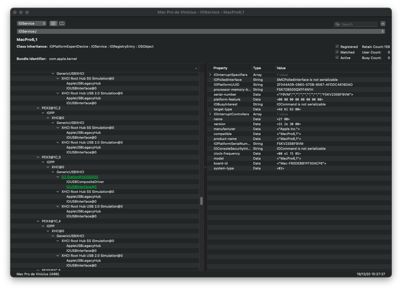

Vinicius P. Miranda Posted December 18, 2020 Share Posted December 18, 2020 @Zenith432 Is there any possibility that you can update "GenericUSBXHCI.kext" to run on Big Sur? It seems that we have no possibility of running USB 3.0 with ASMedia 1042 on Big Sur. Link to comment https://www.insanelymac.com/forum/topic/286860-genericusbxhci-usb-30-driver-for-os-x-with-source/page/37/#findComment-2747284 Share on other sites More sharing options...

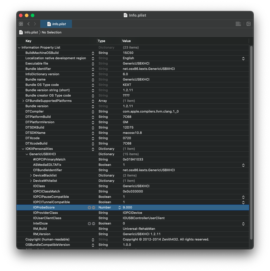

ACIDSky Posted December 19, 2020 Share Posted December 19, 2020 14 hours ago, Vinicius P. Miranda said: @Zenith432 Is there any possibility that you can update "GenericUSBXHCI.kext" to run on Big Sur? It seems that we have no possibility of running USB 3.0 with ASMedia 1042 on Big Sur. Make the IOProbescore in the kext equal to 9000 Link to comment https://www.insanelymac.com/forum/topic/286860-genericusbxhci-usb-30-driver-for-os-x-with-source/page/37/#findComment-2747316 Share on other sites More sharing options...
Vinicius P. Miranda Posted December 19, 2020 Share Posted December 19, 2020 11 hours ago, ACIDSky said: Make the IOProbescore in the kext equal to 9000 You say, edit the info.plist inside the "GenericUSBXHCI.kext" and change the "IOProbescore" from 1 to 9000 like this photo? If so, it didn't work. With 1 or 9000, I can see my External HD on IOJOnes using the USB 3.0 port, but it doesn't mount to be able to use. Like this 2° photo. Any other solution that I can try? Link to comment https://www.insanelymac.com/forum/topic/286860-genericusbxhci-usb-30-driver-for-os-x-with-source/page/37/#findComment-2747339 Share on other sites More sharing options...
