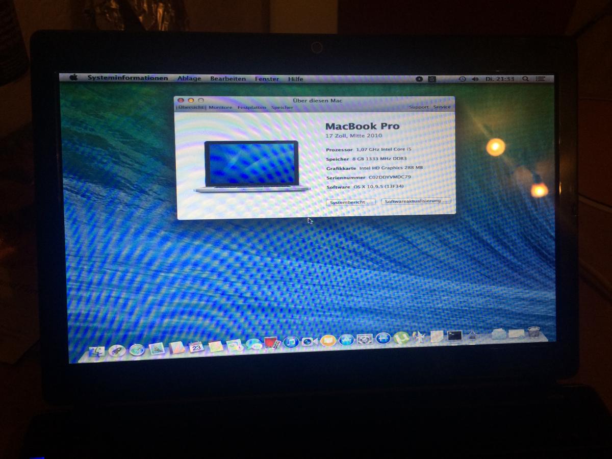

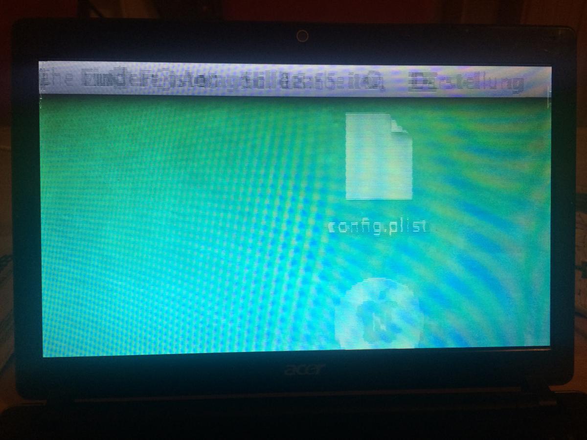

I have a Acer Aspire One 753 Netbook with a Intel HD from the 1st gen.. Running on Niresh 10.9.5
Today i spend the completely day to get the Intel HD working.. but absolutely no chance :(
Here some Screenshorts..
Completely without AppleIntelHD *.kext is in mode 1024*786 working but when i install the
"Intel HD Graphics QECI 10.9.5.zip" and i Added via Kext Wizzart the
Framebuffer "SINGLE-LINK->NORMAL->LCD+VGA->LCD+VGA W1"
and the "AppleIntelHDGraphics.kext" i get a very crazy screen and is only possible to boot
when i remove the kext...
If you need more infos please tell me, i give you.. but please let me now how i can fix this :(
Thanks
Alex

Hmm.. well from that screenshot its obvious that QE/CI is not enabled because the menubar has a grey color. It seems that that the framebuffer is not loaded either.
Delete all of the Intel HD Graphics kexts from the Extensions folder.
From the 10.9.5 QE/CI framebuffer folder, pick SINGLELINK > ALTERNATE > LCD+VGA > LCD+VGA LW1. Install the framebuffer with the other kexts:
AppleIntelHDGraphicsGA.plugin
AppleIntelHDGraphicsGLDriver.bundle
AppleIntelHDGraphicsVA.bundle
Use kext utility and restart your computer. Let me know what happens.

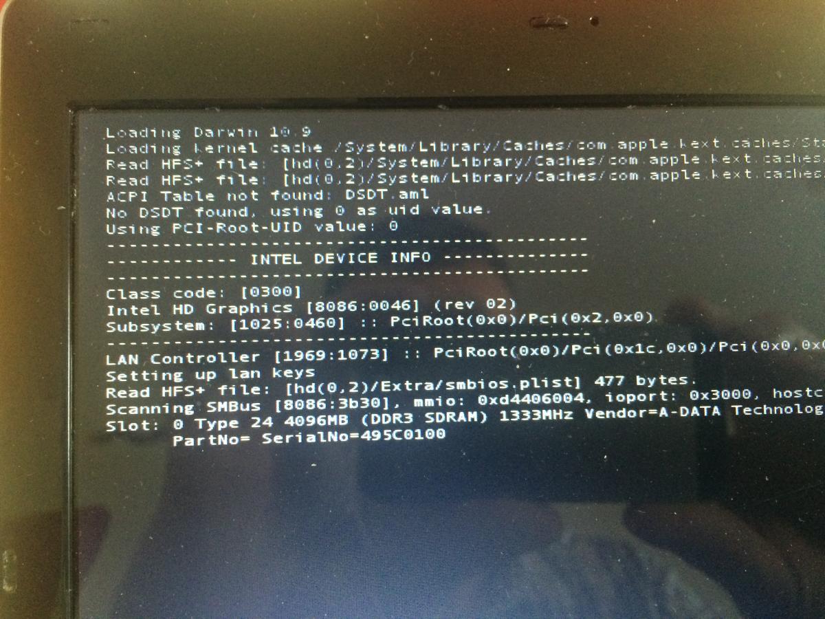

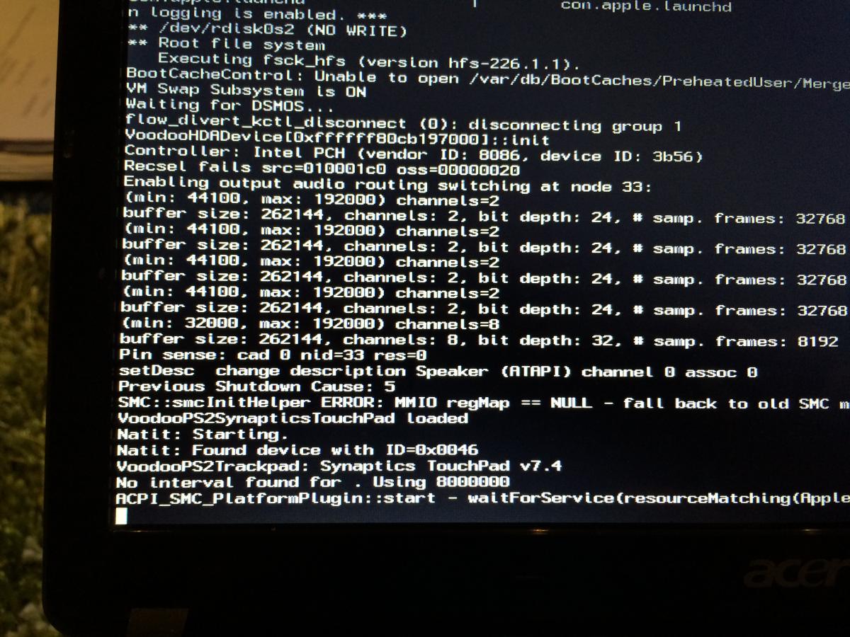

Hello GhostRaider,
I make exactly what you say and i testet also LW2 and the unmodified Framebuffer.. and i get the same result..
I Search a bit in the Board here and i read that i need also the "Natit.kext" File and i found Here...
I installed the via kext wizard and reboot..(and i to with the same tool fix the permissions)
in Verbose mode i see the kext i loaded and found my Device :)
but the Graphic Driver dos't not work :(
Thanks for Help :)

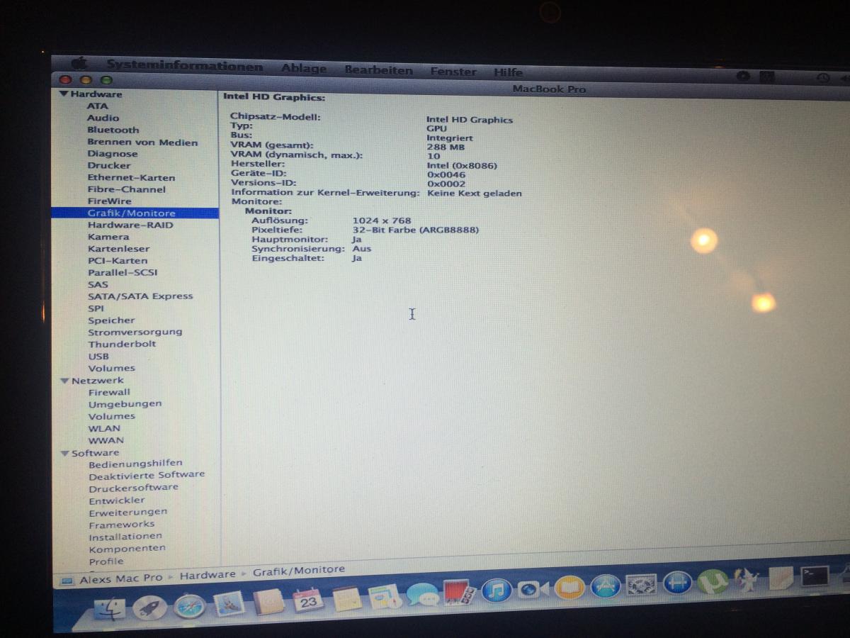

Hello again :)
I testet a bit and i remove the "Natit.kext" file and i patched my DSDT file like the Guide from the Page "1" from here..
but i get again only 1024x768 and not 1366... what i need..
any Tips?
Try the new uploaded QE/CI package for 10.9.5. Maybe it works now. Again, use the SingleLink Alternate LW1 framebuffer.
