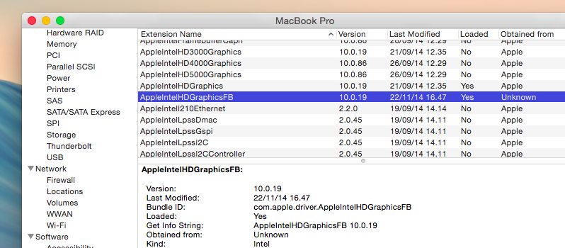

if you do not have a working FB, from 10.8, or 10.9 or 10.10,
use the following method,
(USE Chameleon)
1. make sure you have a vnc connection,  (with all AppleIntelHDG* deleted)
2. Install AppleIntelHDG* except FB
3. copy GhostRaider's Folder to desktop
4. From VNC session, try 1 fb version at time and reboot from VNC, until you find the correct one.

I already can play movies with VLC, QT etc since i have the correct FB installed
but the problem is the game, i can't even play chess game, it's very slow. like i said, even my older GMA950 + lion hackintosh can play it better, maybe because it's a lion anyway
and also everytime i click a stacked folder from the dock, it gives me a bit sluggish animation. again, my older-slower lion hack can give me better animation
i don't know, maybe i'm asking too much from this quite old system
