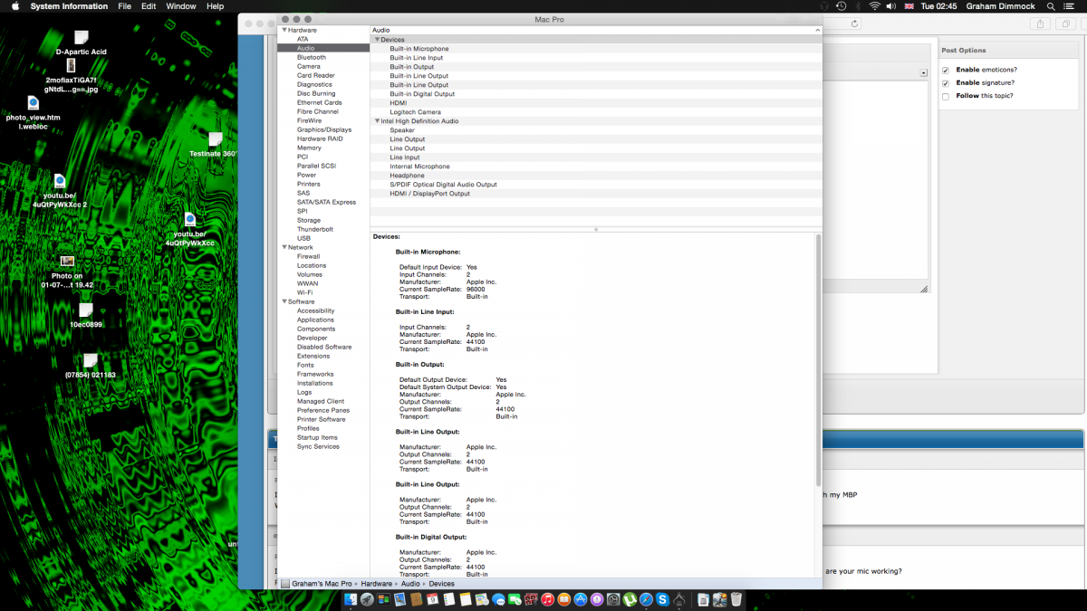

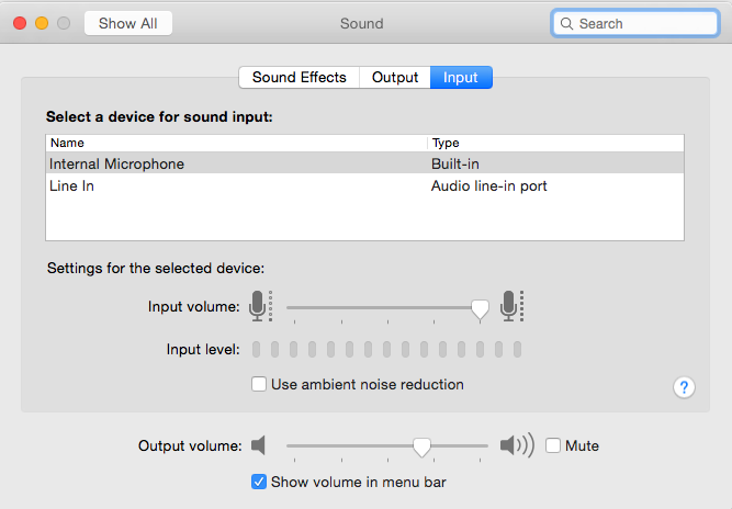

elviejo Posted September 7, 2014 Share Posted September 7, 2014 I have everything working 100% with the exception of my mic and some pops in the sound, the mic shows in system preferences but won't work, what can be done to solve this? Link to comment https://www.insanelymac.com/forum/topic/285920-os-x-compatible-motherboard-quo/page/62/#findComment-2058648 Share on other sites More sharing options...
IronManJFF Posted September 8, 2014 Share Posted September 8, 2014 Is it working on Mavericks or Mountain Lion ? I noticed you are on Yosemite Beta ... and beta software is beta software... Link to comment https://www.insanelymac.com/forum/topic/285920-os-x-compatible-motherboard-quo/page/62/#findComment-2058734 Share on other sites More sharing options...
elviejo Posted September 8, 2014 Share Posted September 8, 2014 It's the same in Maverick, audio works but not the mic, I do not have Mountain Lion, but the same mic works perfectly in an Asus P5K-VM I have. Link to comment https://www.insanelymac.com/forum/topic/285920-os-x-compatible-motherboard-quo/page/62/#findComment-2058757 Share on other sites More sharing options...
IronManJFF Posted September 8, 2014 Share Posted September 8, 2014 What version of Mavericks ? I think my troubles started with 10.9.3 or 10.9.4 I am also having some issues with 10.9.4 ....but listen to this ... Start iTunes press play ..hear nothing ...leave it on and after about 10 minutes .. pop Audio works. Seems like it takes a long time for it to "sync" the audio format.. I am still researching audio stuff .. seems Toleda/Piker-Alpha have released a patch for AppleHDA ALC Realteck for 10.9.4, trying to understands what is the difference between that, QUO Legacy Package and TheKing's Audio Patch for QUO mobo (that is referenced in Wiki) To be continued.. Link to comment https://www.insanelymac.com/forum/topic/285920-os-x-compatible-motherboard-quo/page/62/#findComment-2058833 Share on other sites More sharing options...
elviejo Posted September 8, 2014 Share Posted September 8, 2014 No, my audio works ok, only occasional "pops", my Maverick is 10.9.4, but I expend my time on Yosemite, I love this OS, my only problem is the mic, not that I really need it, I don't do nothing recording audio or chat, it is only that I'm a bit of perfectionist and I wan't everything working 100% Link to comment https://www.insanelymac.com/forum/topic/285920-os-x-compatible-motherboard-quo/page/62/#findComment-2058867 Share on other sites More sharing options...

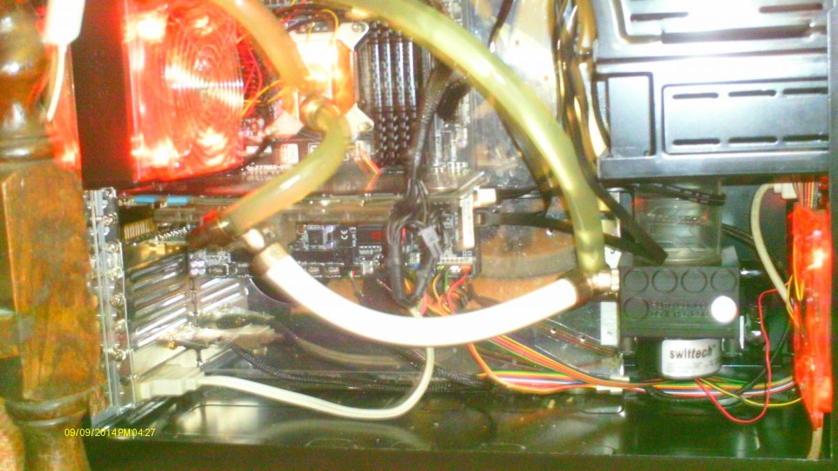

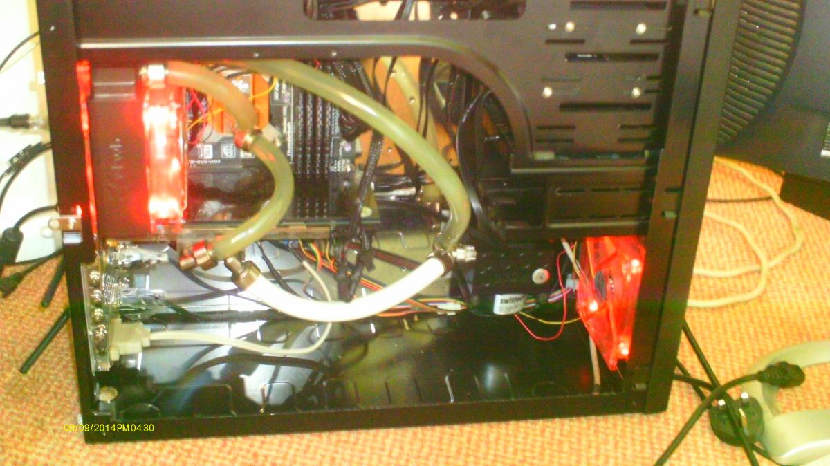

BALDY_MAN Posted September 8, 2014 Share Posted September 8, 2014 @IronManJFF. Just a quick picture of my water-cooled Quo motherboard the water-cooling is all fitted to the slid out motherboard tray so can be just slide out of the case 1 Link to comment https://www.insanelymac.com/forum/topic/285920-os-x-compatible-motherboard-quo/page/62/#findComment-2058873 Share on other sites More sharing options...
IronManJFF Posted September 8, 2014 Share Posted September 8, 2014 @IronManJFF. Just a quick picture of my water-cooled Quo motherboard the water-cooling is all fitted to the slid out motherboard tray so can be just slide out of the case Awesome man, thanks for sharing. No, my audio works ok, only occasional "pops", my Maverick is 10.9.4, but I expend my time on Yosemite, I love this OS, my only problem is the mic, not that I really need it, I don't do nothing recording audio or chat, it is only that I'm a bit of perfectionist and I wan't everything working 100% Will give a try to Piker-Alpha's (where you don't patch AppleHDA but create a new Kernel Extension to be included into /S/L/E )when I get back home...the benefit of this method is that you don't have to repatch after a System Update. The script also support Yosemite (I don't run it) but will let you know how it runs on Mavericks Link to comment https://www.insanelymac.com/forum/topic/285920-os-x-compatible-motherboard-quo/page/62/#findComment-2058881 Share on other sites More sharing options...

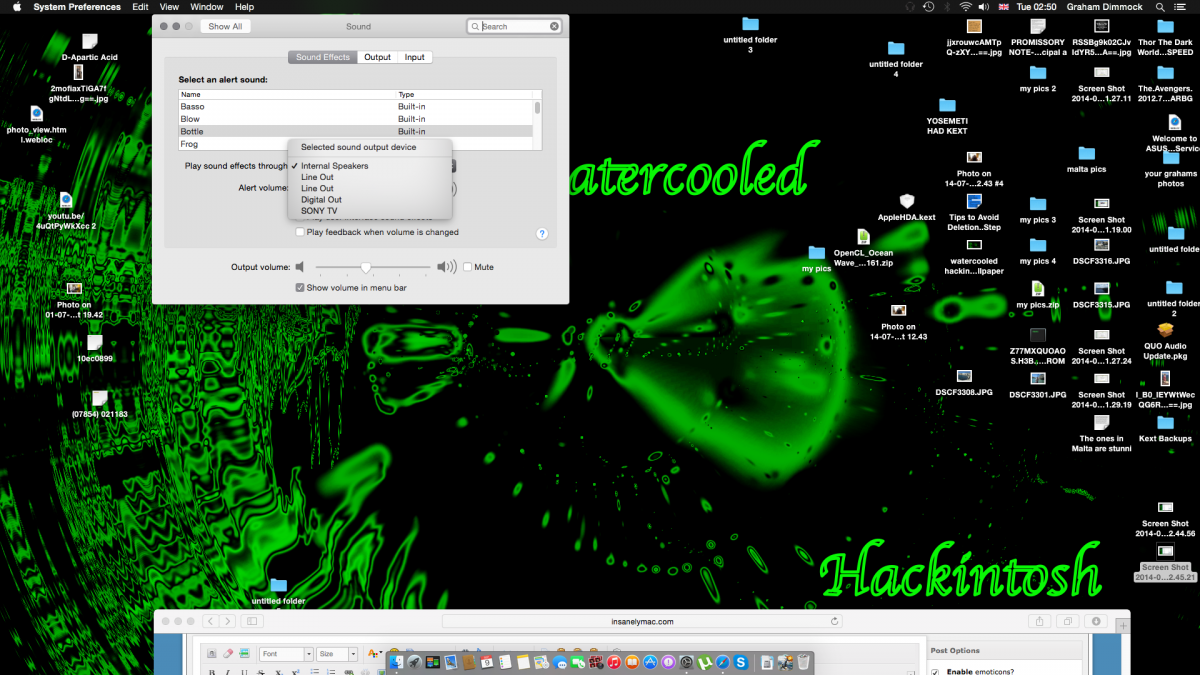

IronManJFF Posted September 9, 2014 Share Posted September 9, 2014 Applied Piker-Alpha ALC Patch ... Rebooted and started iTunes and sound works thru Green connector (labeled internal speaker in Sound Preferences). Note 1 : Not able to configure any setup besides stereo (haven't tried with aggregate device since I don't need it) Note 2 : Quo Audio Update list more ports but seems to have issue with 10.9.4 so I might stay on this patch until 10.9.5 or Quo Update gets updated (if ever) or until I understand better how this all works Note 3 for elviejo Yosemite will not load a kext that is to signed with a dev certificate unless ... nvram boot-args=kext-dev-mode=1 (I did not test this) or unless you ran Trim Enabler 3.2.5 which has to do it for you to enable TRIM support for 3rd party SSD on Yosemite Be careful and have a backup or Time Machine to restore, I did some experiments with that before and brick my installation, to the date the best option is tHE KING installer, the only problem is it is made for Maverick not Yosemite, I hope he surf this tread and put some effort in Yosemite audio, I understand this is beta and he must be waiting for the real thing to put his efforts, anyway, this mobo is amazing and is the closest to foolproof I have seen. Careful is my middle name Link to comment https://www.insanelymac.com/forum/topic/285920-os-x-compatible-motherboard-quo/page/62/#findComment-2058986 Share on other sites More sharing options...
elviejo Posted September 9, 2014 Share Posted September 9, 2014 I have both, the boot arguments and the Trim enabled. Glad you solved your problem, I reflashed the bios and the pops in the audio are gone, but, still no mic, are your mic working? P.S. I'm going to try with another mic as soon I remember where I have it. Link to comment https://www.insanelymac.com/forum/topic/285920-os-x-compatible-motherboard-quo/page/62/#findComment-2058988 Share on other sites More sharing options...
IronManJFF Posted September 9, 2014 Share Posted September 9, 2014 I do not have a mic that fits into the on-board audio .. i am currently using my old iSight connected thru the FireWire port, My M-Audio FW-410 now resides with my MBP Waiting for Alesis Core-1 so I can plug my stage mic (directional) on my Hack, great for gaming ..blast those sound effects and it does not gets into your mic Link to comment https://www.insanelymac.com/forum/topic/285920-os-x-compatible-motherboard-quo/page/62/#findComment-2058989 Share on other sites More sharing options...
BALDY_MAN Posted September 9, 2014 Share Posted September 9, 2014 ONBOARD SOUND IN YOSEMITE 10.10 BETA I read your posts with interest so i tried this 1)Downloaded TrimEnabler 3.2.6. and ran the installer rebooted . ran trim enabler installer again (as it didn't activate the first time.) reboot 2)Ran QUO Audio Update. pkg by KING . choose 10.9 from the dropdown installed to HD reboot 3) Ran kext wizard and kext utilities I have only tried the green plug that works. i don't have a pluged mic to try I hope this helps ppl a little This was only to get onboard sound working HDMI WORKED OOTB Link to comment https://www.insanelymac.com/forum/topic/285920-os-x-compatible-motherboard-quo/page/62/#findComment-2059003 Share on other sites More sharing options...
IronManJFF Posted September 9, 2014 Share Posted September 9, 2014 This got me thinking that maybe QUO Audio Update as to be ran on top of a vanilla AppleHDA kext and not a patched one ( like patched by itself ) will give it another go tomorrow.. Just to make sure my troubles were not caused by some corruption... Link to comment https://www.insanelymac.com/forum/topic/285920-os-x-compatible-motherboard-quo/page/62/#findComment-2059018 Share on other sites More sharing options...
BALDY_MAN Posted September 9, 2014 Share Posted September 9, 2014 @IronManJFF. it was something the trimEnabler did that helped the QUOAudio update pkg work. as it would not work before i installed the trim enabler Link to comment https://www.insanelymac.com/forum/topic/285920-os-x-compatible-motherboard-quo/page/62/#findComment-2059023 Share on other sites More sharing options...
ntsmkfob Posted September 9, 2014 Share Posted September 9, 2014 @IronManJFF. it was something the trimEnabler did that helped the QUOAudio update pkg work. as it would not work before i installed the trim enabler It added boot-args=kext-dev-mode=1 to your nvram. That allowed the patched AppleHDA.kext to load. Link to comment https://www.insanelymac.com/forum/topic/285920-os-x-compatible-motherboard-quo/page/62/#findComment-2059047 Share on other sites More sharing options...
THe KiNG Posted September 9, 2014 Share Posted September 9, 2014 This got me thinking that maybe QUO Audio Update as to be ran on top of a vanilla AppleHDA kext and not a patched one ( like patched by itself ) will give it another go tomorrow.. Just to make sure my troubles were not caused by some corruption... I said several times to run the patcher/installer only on original kext. Anyway, next BIOS will use VoodooHda for onboard and AppleHda for discrete GFX HDMI/DP audio, this means no more patching to get sound working. 2 Link to comment https://www.insanelymac.com/forum/topic/285920-os-x-compatible-motherboard-quo/page/62/#findComment-2059067 Share on other sites More sharing options...
IronManJFF Posted September 9, 2014 Share Posted September 9, 2014 I said several times to run the patcher/installer only on original kext. I am pretty sure that is what I originally did, but I like to be double-sure, so I will re-run the procedure from QUO Audio Update ... (will simply move AppleHDA892.kext outside of /S/L/E) and re-apply Question : Once I have a patched AppleHDA.kext , can it be simply renamed let's say TheKingHDA.kext and live alongside AppleHDA.kext (unpatched) or is it more complicated than that (like editing a bunch of plist files and such) ? next BIOS will use VoodooHda for onboard and AppleHda for discrete GFX HDMI/DP audio, this means no more patching to get sound working. Thanks TheKing, it is good to know that there is still work being done to improve the BIOS. Any other teaser you want to throw our way ? Does anyone has an idea to solve this mystery ..... : /Library/Preferences/Audio/com.apple.audio.DeviceSettings.plist has entries from devices that are no longer present and drivers have been removed , I delete the file , it gets recreated and those entries are being re-created as well , where do they come from ? How do I get rid of them/tell the system to only look at what is currently there ? See below an example of such entry from my M-Audio FW410 Thanks <key>com_m_audio_FWEngine1:0xD6C0100194066</key> <dict> <key>controls</key> <array> <dict> <key>element</key> <integer>1</integer> <key>page</key> <integer>0</integer> <key>scope</key> <integer>1768845428</integer> <key>selector</key> <integer>1987013741</integer> <key>value</key> <real>1</real> </dict> <dict> <key>element</key> <integer>2</integer> <key>page</key> <integer>0</integer> <key>scope</key> <integer>1768845428</integer> <key>selector</key> <integer>1987013741</integer> <key>value</key> <real>1</real> </dict> <dict> <key>element</key> <integer>0</integer> <key>page</key> <integer>0</integer> <key>scope</key> <integer>1869968496</integer> <key>selector</key> <integer>1987013741</integer> <key>value</key> <real>1</real> </dict> <dict> <key>element</key> <integer>1</integer> <key>page</key> <integer>0</integer> <key>scope</key> <integer>1869968496</integer> <key>selector</key> <integer>1987013741</integer> <key>value</key> <real>1</real> </dict> <dict> <key>element</key> <integer>2</integer> <key>page</key> <integer>0</integer> <key>scope</key> <integer>1869968496</integer> <key>selector</key> <integer>1987013741</integer> <key>value</key> <real>1</real> </dict> <dict> <key>element</key> <integer>3</integer> <key>page</key> <integer>0</integer> <key>scope</key> <integer>1869968496</integer> <key>selector</key> <integer>1987013741</integer> <key>value</key> <real>1</real> </dict> <dict> <key>element</key> <integer>4</integer> <key>page</key> <integer>0</integer> <key>scope</key> <integer>1869968496</integer> <key>selector</key> <integer>1987013741</integer> <key>value</key> <real>1</real> </dict> <dict> <key>element</key> <integer>5</integer> <key>page</key> <integer>0</integer> <key>scope</key> <integer>1869968496</integer> <key>selector</key> <integer>1987013741</integer> <key>value</key> <real>1</real> </dict> <dict> <key>element</key> <integer>6</integer> <key>page</key> <integer>0</integer> <key>scope</key> <integer>1869968496</integer> <key>selector</key> <integer>1987013741</integer> <key>value</key> <real>1</real> </dict> <dict> <key>element</key> <integer>7</integer> <key>page</key> <integer>0</integer> <key>scope</key> <integer>1869968496</integer> <key>selector</key> <integer>1987013741</integer> <key>value</key> <real>1</real> </dict> <dict> <key>element</key> <integer>8</integer> <key>page</key> <integer>0</integer> <key>scope</key> <integer>1869968496</integer> <key>selector</key> <integer>1987013741</integer> <key>value</key> <real>1</real> </dict> <dict> <key>element</key> <integer>9</integer> <key>page</key> <integer>0</integer> <key>scope</key> <integer>1869968496</integer> <key>selector</key> <integer>1987013741</integer> <key>value</key> <real>1</real> </dict> <dict> <key>element</key> <integer>10</integer> <key>page</key> <integer>0</integer> <key>scope</key> <integer>1869968496</integer> <key>selector</key> <integer>1987013741</integer> <key>value</key> <real>1</real> </dict> </array> <key>input streams</key> <array> <dict> <key>bits per channel</key> <integer>24</integer> <key>bytes per frame</key> <integer>16</integer> <key>bytes per packet</key> <integer>16</integer> <key>channels per frame</key> <integer>4</integer> <key>format flags</key> <integer>6</integer> <key>format id</key> <integer>1819304813</integer> <key>frames per packet</key> <integer>1</integer> <key>sample rate</key> <real>44100</real> </dict> </array> <key>output streams</key> <array> <dict> <key>bits per channel</key> <integer>24</integer> <key>bytes per frame</key> <integer>40</integer> <key>bytes per packet</key> <integer>40</integer> <key>channels per frame</key> <integer>10</integer> <key>format flags</key> <integer>6</integer> <key>format id</key> <integer>1819304813</integer> <key>frames per packet</key> <integer>1</integer> <key>sample rate</key> <real>44100</real> </dict> </array> </dict> <key>com_senstic_driver_PocketAudioEngine:0</key> <dict> <key>controls</key> <array/> </dict> Link to comment https://www.insanelymac.com/forum/topic/285920-os-x-compatible-motherboard-quo/page/62/#findComment-2059086 Share on other sites More sharing options...

elviejo Posted September 9, 2014 Share Posted September 9, 2014 Well, I found the other microphone and, what do you know!, it works, the old one I have went bonkers. The lesson is to go with the simple solution first. Link to comment https://www.insanelymac.com/forum/topic/285920-os-x-compatible-motherboard-quo/page/62/#findComment-2059149 Share on other sites More sharing options...
