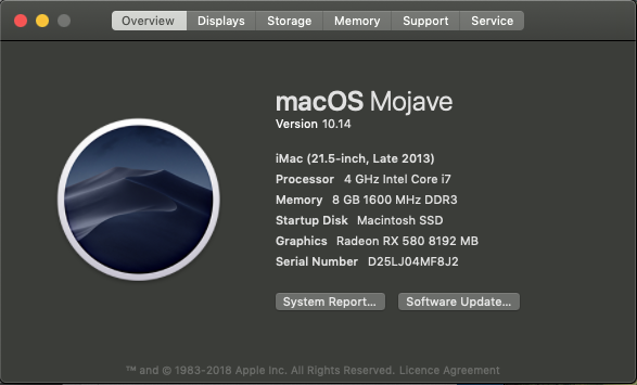

On ‎7‎/‎5‎/‎2019 at 6:30 AM, jkim74 said:
I had the same problem of getting a black screen after booting Mojave installer USB.  What specific BIOS changes did you have to make for the Mojave installer to work?
Sorry for the late reply.
The only way to get it working seems to be: install supported card (ex. RX5xx), disable iGPU.

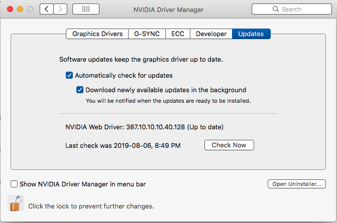

On 8/5/2019 at 8:30 PM, Casm101 said:
But, as I try to install it, after the whole process completes, my Mac boots, but it hasn't really updated. I have tried with different updated .plist files (MacMini6.1, iMac13.1, iMac14.1, etc.) but to no avail.
Were you using a Nvidia Card prior to the RX 580?
If so .. you may need remove the Nvidia Web drivers from your system ...Open Uninstaller ...

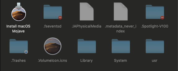

11 hours ago, ntsmkfob said:
Add flagsnv_disable=1 to kernel flags line in:
fsx:edit "macOS Install Data\Locked Files\Boot Files\com.apple.boot.plist"
Thanks, it seems like a pretty easy fix, but where is the macOS Install Data folder?
On the install drive I created this is what I get:
Or do you mean on my boot SSD once I have started the installation?
I was using a Nvidia card, but I never had to install drivers, it just worked straight out of the box as if it were native to Mac, it was almost 10 years old, so there wasn't that much I could do with it anyways. -_-
Thanks to IronManFF and others for working it out and documenting it (probably better than I have, so search back for the messages discussing it)
If it weren't for people like IronMan (but mainly just IronMan :D), this forum would be a lot more hectic and half of the problems we have would take forever to be fixed, so as always thanks for all the help @ntsmkfob and @IronManJFF for you help with this particular problem.

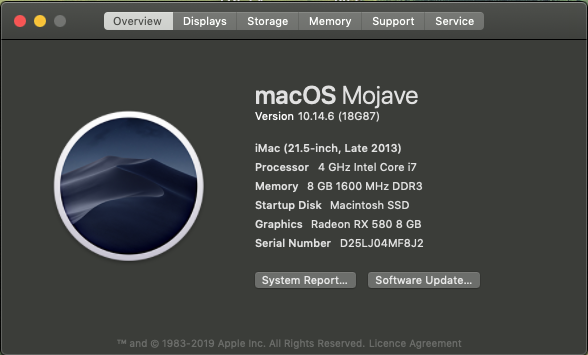

Okay so I re-read your post after waking-up with a cup of tea, and understood what I didn't before.... :whistle:
So I started the update process, let it fail, sudo nano'd the com.apple.boot.plist to add the kernel flag, rebooted and selected the boot.efi from the installer files.
And now I'm happy to say that I'm running 10.14.6!! :thumbsup_anim:
So you can pretty much forget about my previous post hehehe
And thanks again, for your help!

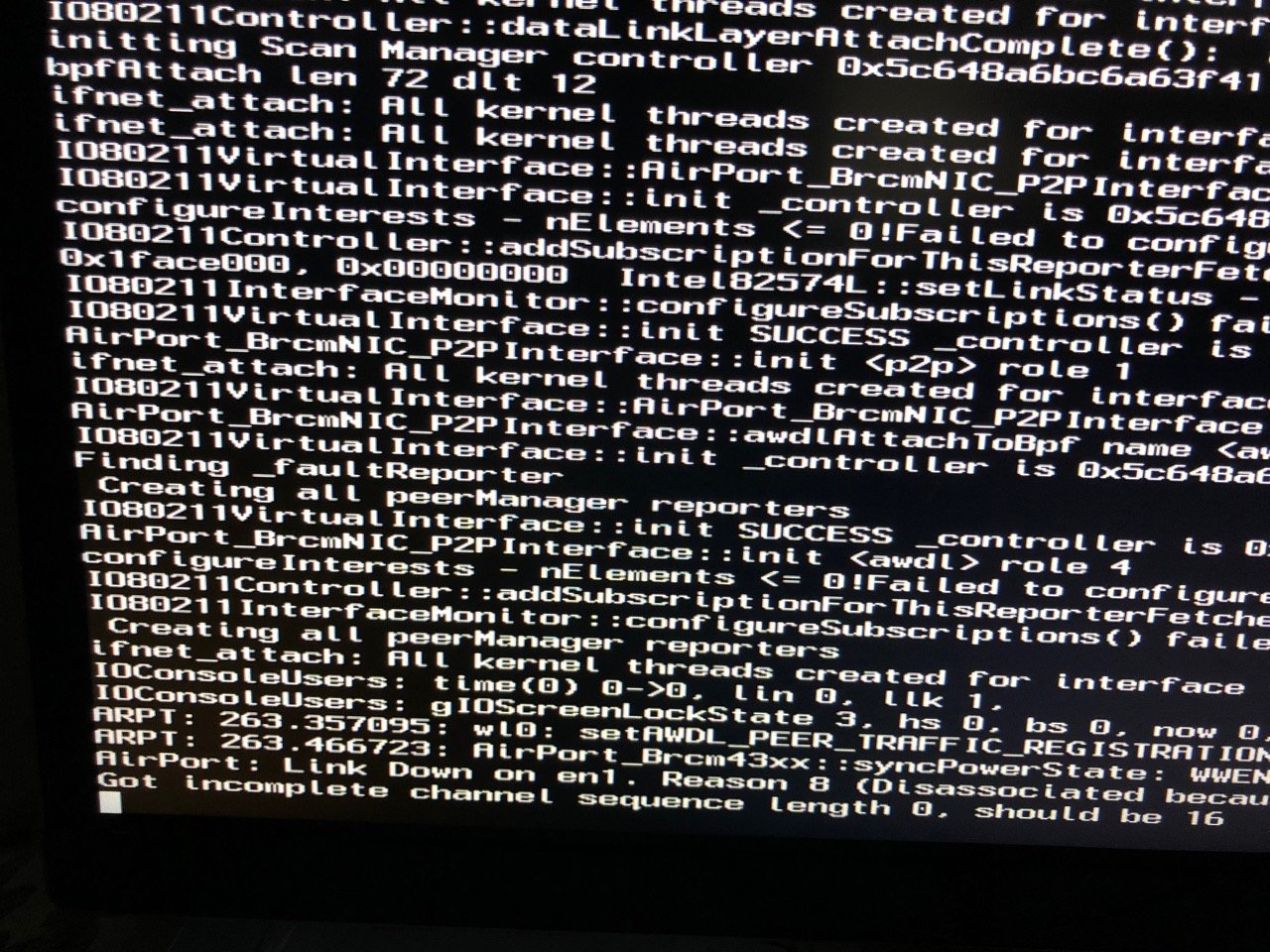

First attempt @ Catalina Developer Beta... it installing now on a external SSD drive..good news is Installer is running ...Install Completed... First Boot in Progress...stuck to where the UI would start IMG_0055.thumb.jpg.067b13aaad12e70669086912ac3dd6bb.jpg ...
to be continued...
Edited by IronManJFF

First attempt unsuccessful .. (using binary packages)
Stuck @ Loaded Configuration .. not sure if I should get a message when it is done parsing the config file...
I think because Ozmosis is already in firmware .. that might be conflicting
Yes definitely because of what’s in the firmware. From what I understood so far it should be alone in the EFI partition. I don’t have my Quo next to me, so no way to try yet.
Edited by alberto21
