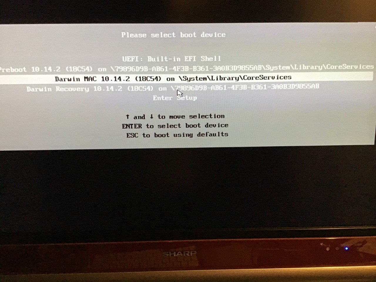

On 12/20/2018 at 10:44 AM, IronManJFF said:
Z77MXQUOAOS.H20.167X-RE-XMAX.rom
hi guy s
I have install Mojave via clover work s like a charm
now like to install the bios
I have change for the bios of JJ
and did:
Step #1
Finding your APFS filesystem mapping.
Boot with F12 and go to UEFI shell
Issue this command
fs1:\System\Library\CoreServices\boot.efi
Does it boot to High Sierra/Mojave ?, if so  go to Step #2, if not repeat Step #1 but this time replace fs1 by fs2, fs3 ... until you get to the one that will boot in High Sierra/Mojave.
Step #2
Listing current boot entries
Once again go to UEFI Shell and issue this command
bcfg boot dump
This will output the boot list that you see when you press F12 at boot. It is a numbered list .. take note the highest number.
Step #3
Adding the new boot entry
Now issue theses commands (replacing italic by values we found earlier)
fsn:
bcfg boot addp highest number +1 System\Library\CoreServices\boot.efi "Name that you want to appear in F12 Menu"
now I have replace the EFI ,for the on you have posted also have change the  OzmosisDefaults.plist
question for the plist when I change , do I leave it as is or change the name to Defaults.plist
still can t boot
need help please
still can t boot
need help please
It has to be named Defaults.plist and it has to be in /EFI/Oz on the EFI partition and you have to reset nvram for changes to take effect.

here is what I am using  I am able to boot to my Mac,
Efi.zip
Nividia GTX will not work for Mojave because there is no Nvidia Web drivers at this time. High Sierra will work
You can try to increase iGPU memory size in BIOS like I asked JJ. It could be related as a real MacMini using HD4000 would use from 384M to 1024M of shared memory but the default for our board is 32M. So I am hoping that by raising the minimal value to 384M that it will enable you to use HD4000.
