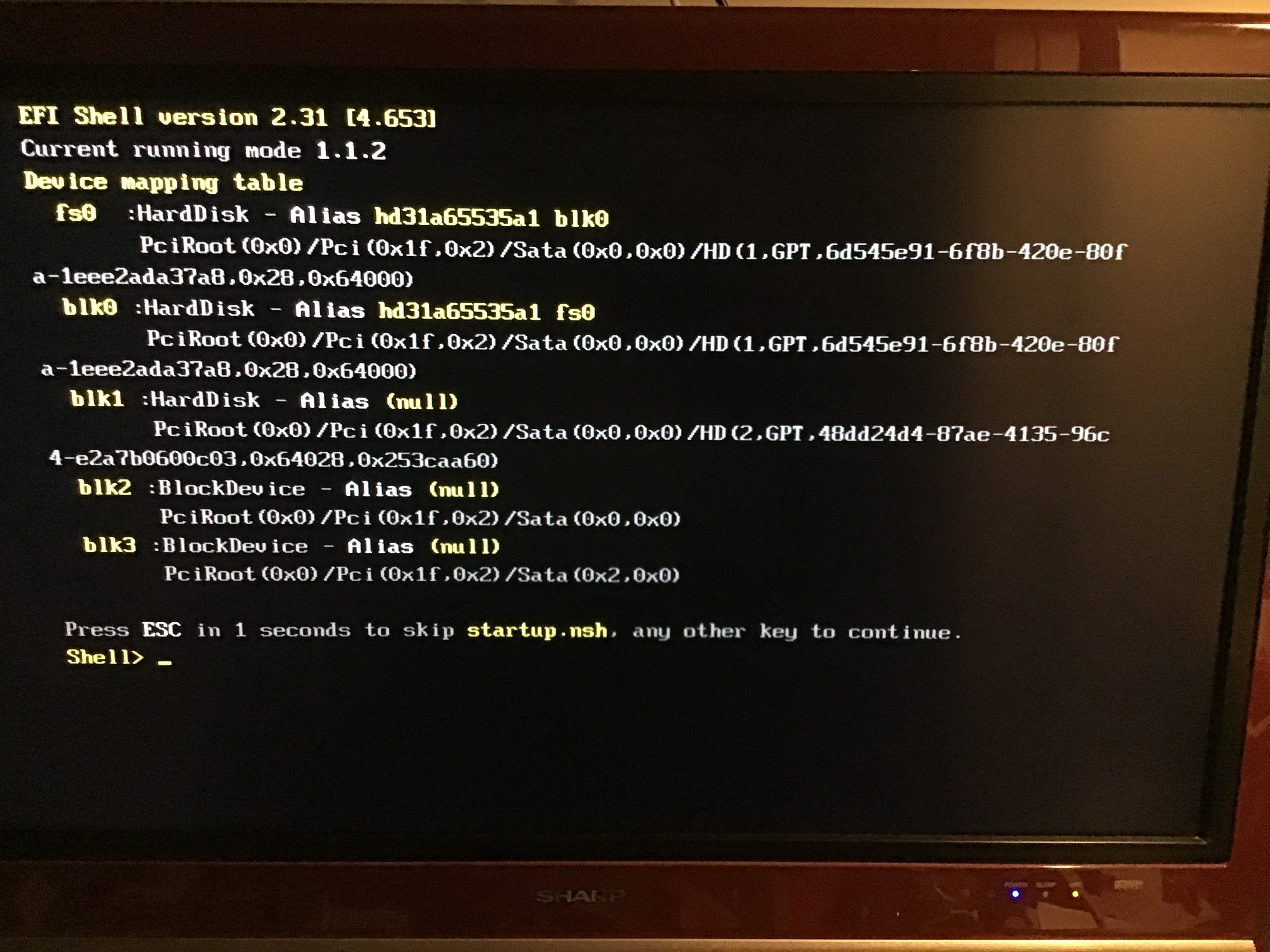

I would start from the top the way it should be ... and btw throwing Clover in the mix is to gonna solve anything just make more noise.
I would
0) Reset CMOS
1) Create a USB Installer
2) Copy on the USB stick the Defaults.plist file i provided you
3) Re-Format the target drive and plug it in SATA0,0
4) Flash BIOS (so it will create the required directory structure in the ESP partition
5) Boot to UEFI Shell  and Copy Defaults,plist to fs0:\EFI\Oz (nothing else should be needed) and flash nvram
6) Verify in UEFI shell that Defaults.plist was read and applied (thru the use of the dmpstore and bdmesg commands)
7) And only after this has been successful I would then start installation of the target OS

this is where nothing happens
@guido13456
Nothing shows up when you type bdmesg in UEFI shell ? That is almost impossible. It should output something like
00:000 00:000 Ozmosis 1.03.167X-XMAX RELEASE (2018-06-06 09:12:07 VS2013x86) on 2019-01-14 12:33:46

You sure you are not booting with Clover ?
