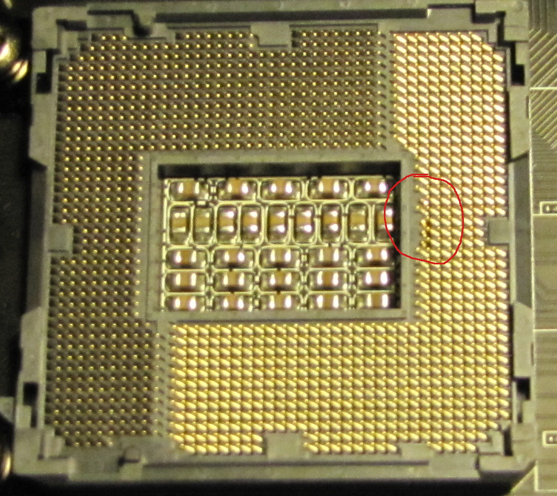

ItsJustDave Posted August 26, 2013 Share Posted August 26, 2013 1. It might be worth your while removing the processor and ensuring all the pins look ok before carefully reinserting it. Regrettably, that was the culprit. There's 4 pins that don't look so good. I've added an image to this post. Link to comment https://www.insanelymac.com/forum/topic/285920-os-x-compatible-motherboard-quo/page/14/#findComment-1941505 Share on other sites More sharing options...
joe75 Posted August 26, 2013 Share Posted August 26, 2013 That sucks.. Does it look like something you can bend back and take care of yourself? Link to comment https://www.insanelymac.com/forum/topic/285920-os-x-compatible-motherboard-quo/page/14/#findComment-1941507 Share on other sites More sharing options...
Lanceomni Posted August 26, 2013 Share Posted August 26, 2013 IMG_0040.JPG Regrettably, that was the culprit. There's 4 pins that don't look so good. I've added an image to this post. Yikes! Confirm you have not broken a pin into the socket. You generally can bend pens back into place. They need to be precisely positioned. You can look into the die from each side to line them up. Take your time and consider not using metal tools. A rigid plastic pick usually does the job. Grounding yourself would be good. Not something to do as you nervously slide your socks on the carpet. Be very careful as you place it back in. Remember, it does not take any effort to slide into the socket. Dont push. If you are lucky and you have no broken pins, static discharge or arching from the original install, you may be okay. 1 Link to comment https://www.insanelymac.com/forum/topic/285920-os-x-compatible-motherboard-quo/page/14/#findComment-1941508 Share on other sites More sharing options...
Rampage Dev Posted August 26, 2013 Share Posted August 26, 2013 Yikes! Confirm you have not broken a pin into the socket. You generally can bend pens back into place. They need to be precisely positioned. You can look into the die from each side to line them up. Take your time and consider not using metal tools. A rigid plastic pick usually does the job. Grounding yourself would be good. Not something to do as you nervously slide your socks on the carpet. Be very careful as you place it back in. Remember, it does not take any effort to slide into the socket. Dont push. If you are lucky and you have no broken pins, static discharge or arching from the original install, you may be okay. Or just RMA... Link to comment https://www.insanelymac.com/forum/topic/285920-os-x-compatible-motherboard-quo/page/14/#findComment-1941510 Share on other sites More sharing options...
joe75 Posted August 26, 2013 Share Posted August 26, 2013 Or just RMA... Agreed. If it looks too bad just RMA. Too much money there to have it not be perfect. Link to comment https://www.insanelymac.com/forum/topic/285920-os-x-compatible-motherboard-quo/page/14/#findComment-1941512 Share on other sites More sharing options...
ItsJustDave Posted August 26, 2013 Share Posted August 26, 2013 Or just RMA... Yeah, I've gotten in touch with Quo. I'm bummed that I've got to wait some more, but I'd rather not attempt to rectify this myself. Thanks so much for all the help. Slightly ashamed for missing something kinda obvious, but my mind was looking for something specific to the board being incorrectly setup on my end. 1 Link to comment https://www.insanelymac.com/forum/topic/285920-os-x-compatible-motherboard-quo/page/14/#findComment-1941513 Share on other sites More sharing options...

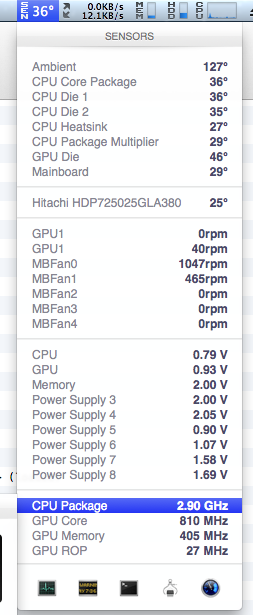

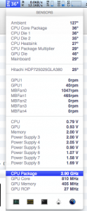

Fruitboi Posted August 27, 2013 Share Posted August 27, 2013 Fruitboi, http://www.mediafire...08072013[1].zip Grab the legacy file there. You will find a script to fix audio in PatchALC892 folder. Thanks Joe75, I did find that and will try on the next OS update. Can anybody confirm their CPU Multiplier and power management? I can sleep and wake up fine, the CPU just does not throttle down while idle. The only way I know how to see this is via iStat Menus' Sensor widget Link to comment https://www.insanelymac.com/forum/topic/285920-os-x-compatible-motherboard-quo/page/14/#findComment-1941724 Share on other sites More sharing options...
