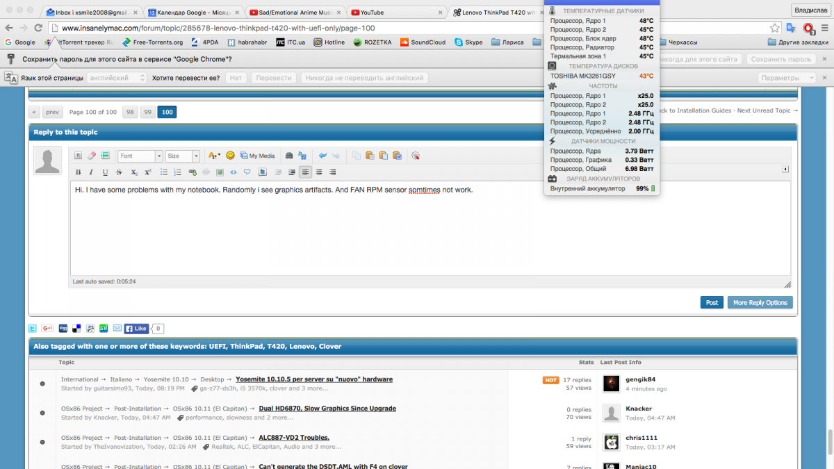

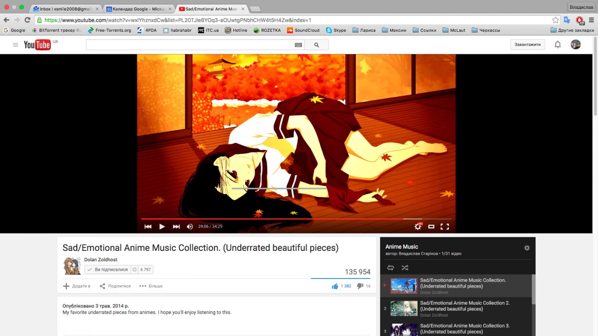

Hi. I have some problems with my notebook. Randomly i see graphics artifacts like this gray line on youtube video. I can see artifact on other UI elements. And FAN RPM sensor sometimes not work. What I do wrong with installation? I complete all stages o instruction.
And what models of Wifi adapter is recommends to replace my Intel 6205?
Sorry for my bad english)))
post-828455-0-25156600-1444597789_thumb.pngpost-828455-0-27548000-1444597800_thumb.png

@XSmile2008
is your screen 1600x900 or 1366x768? my T420 with 1600x900 and 4GB of memory got some random artifacts lately. But the other one 1600x900 with 8GB, i have not seen a glitch in a long time. for the lower memory  laptop, I recompile the DSDT and included a built-in EDID. somehow that makes a difference. other threads mention to change slide=0 to slide=10 or 100. Tetonne reports that using the DSDT with the built-in EDID and display overrides allow his 1366x768 LCD to actually display at 1600x900! good stuff
The wifi adaptor is a mater of opinion. some like broadcom and some like atheros. there are plenty of posts with the pros and cons of each one and which ones are compatible. Personally, i went with a basic Atheros 9280 which is supported by OS X and readily available on eBay. if you replace your wifi in the box, you need to flash with modded bios.
