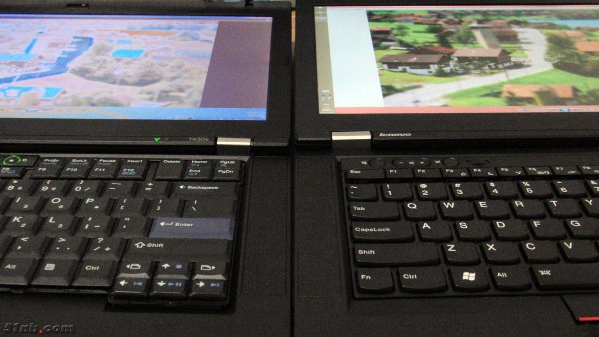

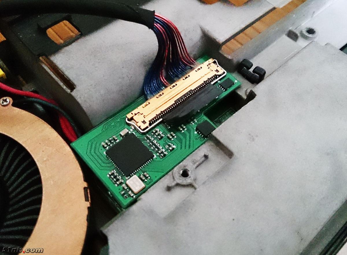

ntp2000 Posted July 21, 2015 Share Posted July 21, 2015 T420/T430 with FHD link(Chinese) http://forum.51nb.com/thread-1604535-1-1.html http://forum.51nb.com/thread-1604332-1-1.html Left is the original screen and the right is IPS FHD screen Link to comment https://www.insanelymac.com/forum/topic/285678-lenovo-thinkpad-t420-with-uefi-only/page/73/#findComment-2154511 Share on other sites More sharing options...
