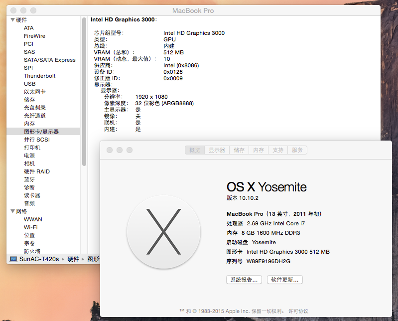

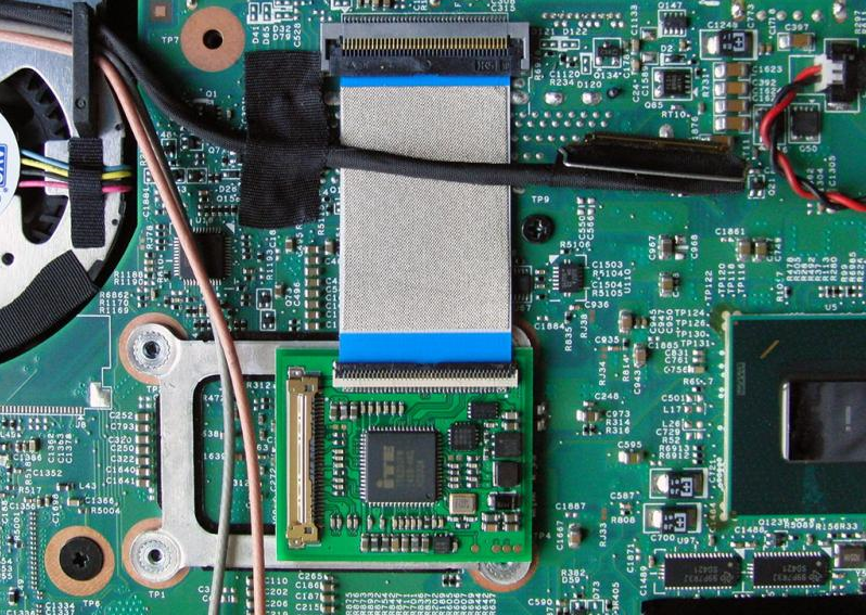

ntp2000 Posted March 27, 2015 Share Posted March 27, 2015 Today I upgrade my T420s to FHD with a LVDS-eDP convertor. I also update EDID in DSDT and config.plist. It works very well. Thanks everyone. Here is my dsdt and config.plist. My LCD is B140HAN01.2 FHD now. T420s.1.38-FHD.zip This is the convertor. This is Yosemite. The convertor only supports T420s/T430s now, because of the free space in laptop. 8 Link to comment Share on other sites More sharing options...

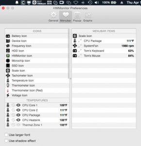

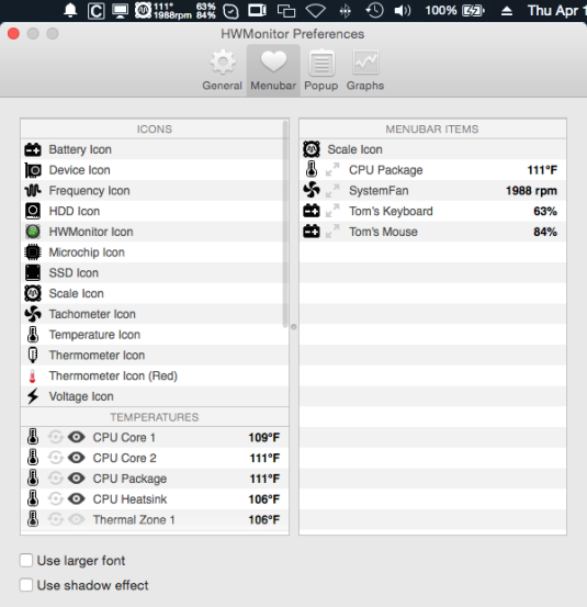

verleihnix Posted April 16, 2015 Share Posted April 16, 2015 Install of 10.10.3 went fine. Since then the the HWMonitor icon in menubar is hidden. Link to comment Share on other sites More sharing options...
ntp2000 Posted April 16, 2015 Share Posted April 16, 2015 @verleihnix You can click the menubar(Yes, HWMnitor is there ,but cannot see icon), open the HWMonitor menu, click options, and set the icon. Link to comment Share on other sites More sharing options...
tluck Posted April 16, 2015 Share Posted April 16, 2015 @ntp2000 - the new ethernet kext is in the guide zip file - unzip and look in EFI/CLOVER/kexts/Other @verleihnix - have you installed the 6.14.1364 monitor? it has new icons that switch automatically with the menu mode. if so have you removed the green icon and use the black/white icons? if you are using dark mode then you may not see the green or red one. Link to comment Share on other sites More sharing options...
verleihnix Posted April 16, 2015 Share Posted April 16, 2015 got it, the menu bar item list was empty. Thanks ntp2000 and tluck Link to comment Share on other sites More sharing options...
