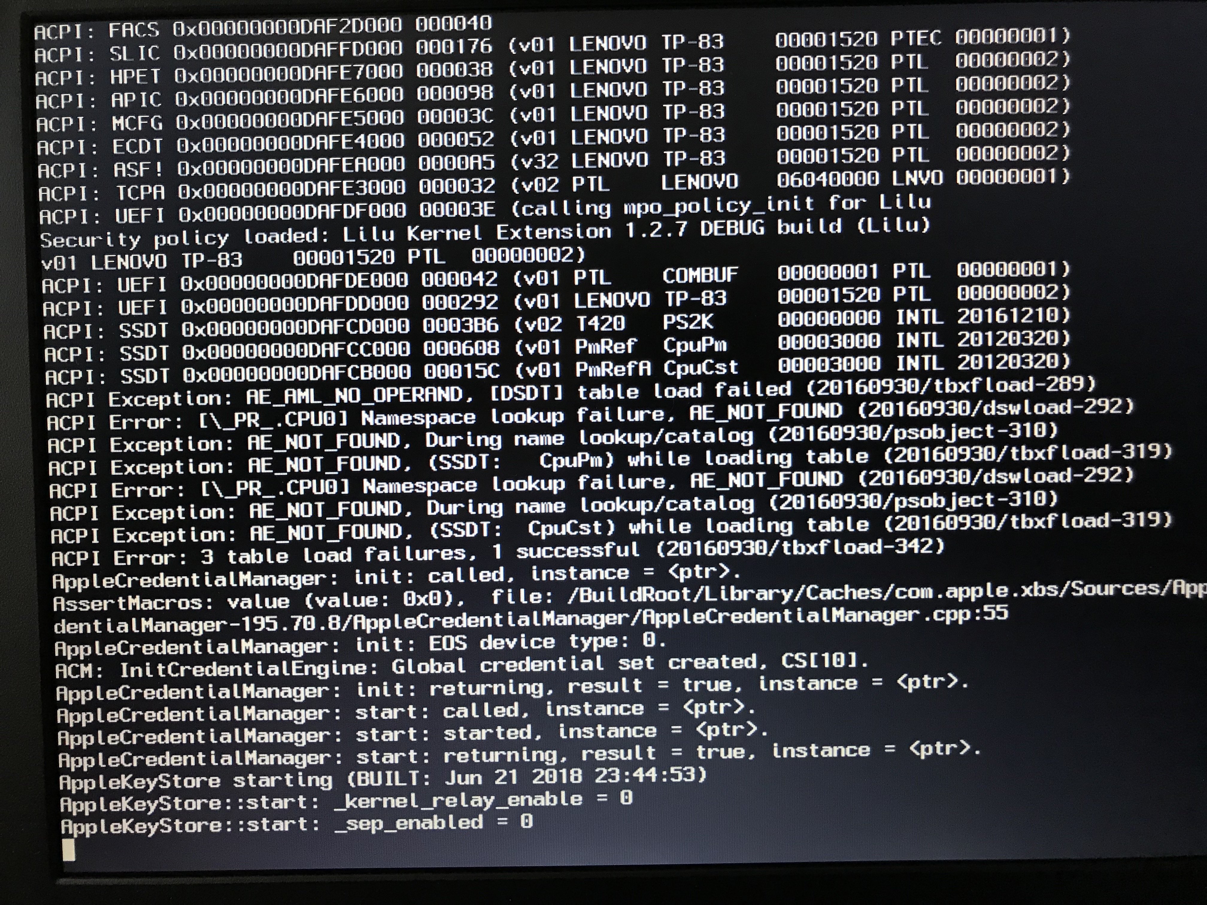

SnuK Posted September 6, 2018 Share Posted September 6, 2018 (edited) Hello again, thanks to the well documented DSDT from @tluck, I pasted all mods to the new DSDT. Finally I compared the two files and some questions raised up: the new file contains \, e.g. Scope (\_SB), the same line in tlucks file is without \ (e.g. Scope (_SB)), any problem with this? is a mix of zero & 0x00 and one & 0x01 (e.g. Store (One, H8DR) vs. Store (0x01, \OSIF)) ok? what about this difference: Store (\SRE1, \_SB.PCI0.EXP1.RID) vs. Store (SRE1, ^PCI0.EXP1.RID)? the sections Device (URTH) below Device (EH02) looks different… Enclosed the DSDT 1.52 with the patches from tluck. Hope you guys have some answers… Small update: - it looks like everything is working as expected. Regards SnuK DSDT.dsl Edited September 6, 2018 by SnuK first start Link to comment https://www.insanelymac.com/forum/topic/285678-lenovo-thinkpad-t420-with-uefi-only/page/171/#findComment-2633600 Share on other sites More sharing options...

tluck Posted September 6, 2018 Share Posted September 6, 2018 (edited) @SnuK good stuff i made a few edits on your 1.52 DSDT - that make it more like the old one. ----- posted some new items in the GitHub repo: Update kexts: AppleAlc.kext Lilu.kext VoodooPS2Controller.kext (fixes up some issues with keys etc) WhateverGreen.kext - may help with stability and glitches - doesn't hurt! Added SSDT option for adding custom key map. so PrtSrn - TrackPad on/off SrcLk - brightness down Pause - brightness up if you copy SSDT-T420-PS2K-keys.aml to ACPI/patched/SSDT-T420-PS2K.aml then you get this new set of mapping: Package(){}, "e01e=e037", //Map tp disable to f8</string> "e037=e01e", //Prevent PrntScr from triggering tp disable</string> }, "Function Keys Special", Package() { Package(){}, // The following 12 items map fkeys to Fn+fkeys</string> "3b=e012", // F1 - Brightness Down</string> "3c=e017", // F2 - Brightness Up</string> "3d=e00a", // F3 - Mission Control (app select)</string> "3e=e009", // F4 - Launchpad</string> "3f=0", // F5 - nothing</string> "40=0", // F6 - nothing</string> "41=e06e", // F7 - Video Mirror</string> "42=e037", // F8 - TP on/off</string> "43=0", // F9 - nothing</string> "44=e020", // F10 - Volume Mute</string> "57=e02e", // F11 - Volume Up</string> "58=e030", // F12 - Volume Up</string> "46=e022", // ScrLck - iTunes - play/pause</string> Edited September 11, 2018 by tluck 1 1 Link to comment https://www.insanelymac.com/forum/topic/285678-lenovo-thinkpad-t420-with-uefi-only/page/171/#findComment-2633661 Share on other sites More sharing options...

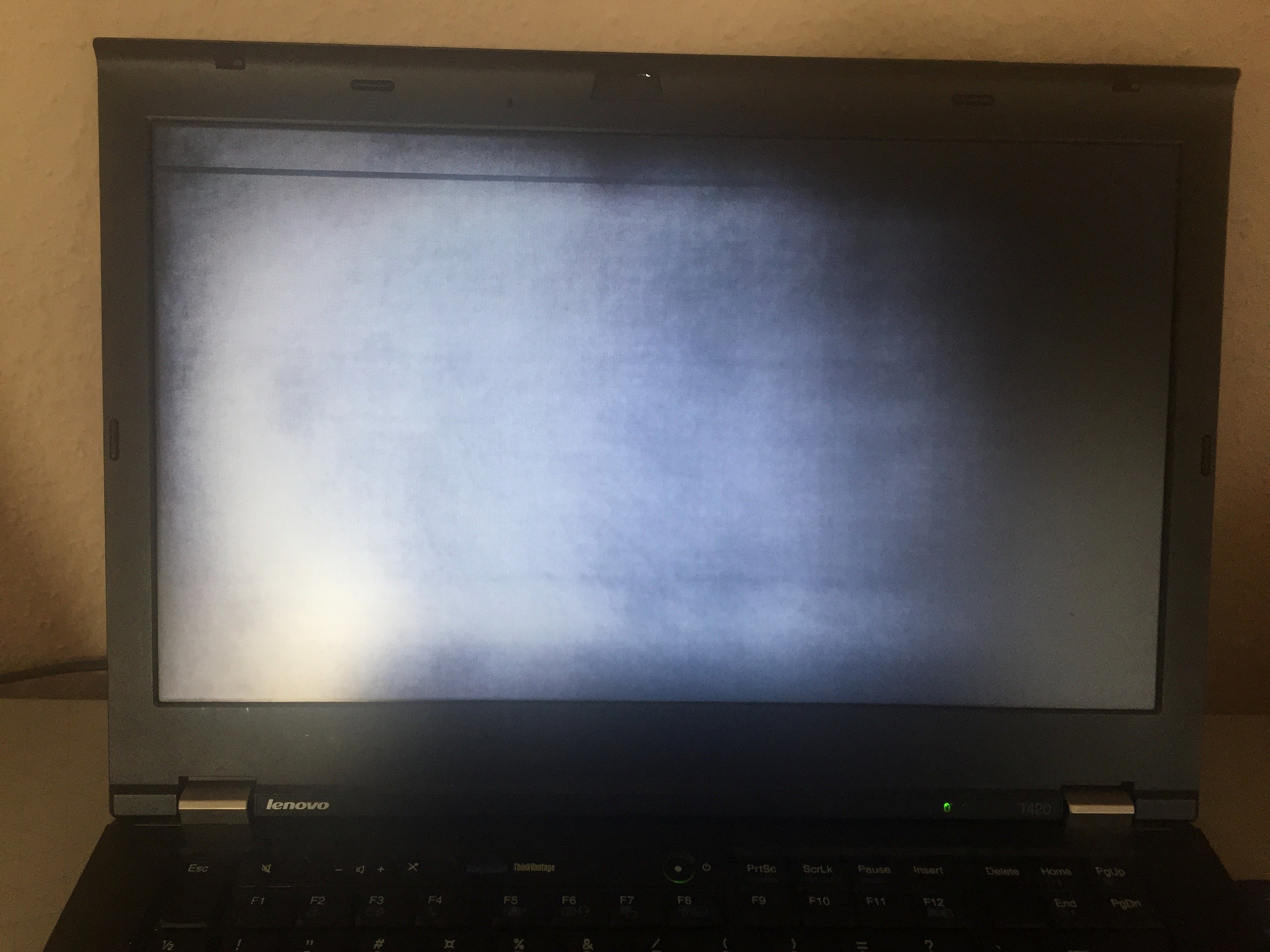

Somez Posted September 7, 2018 Share Posted September 7, 2018 Alright. So I'm now on High Sierra clean install using the bundle of 6 September. I've had 2 freezes so far, when the whole machine stopped. Interestingly with the last 2 or 3 bundles under Mojave I occasionally got scrambled LCD screen on boot and sometimes KPs. I thought that's due to Mojave but I got the same scrambled screen issue when tried o reboot into the Installer a few times. 3rd try went well and I could complete the install. Link to comment https://www.insanelymac.com/forum/topic/285678-lenovo-thinkpad-t420-with-uefi-only/page/171/#findComment-2633753 Share on other sites More sharing options...
SnuK Posted September 7, 2018 Share Posted September 7, 2018 (edited) On 9/6/2018 at 9:34 PM, tluck said: @SnuK good stuff i made a few edits on your 1.52 DSDT - that make it more like the old one. Thx. @tluck! The main changes are related to Scope (\_SB) vs. Scope (_SB) Store (0x01, H8DR) vs. Store (One, H8DR) Store (\SRE1, \_SB.PCI0.EXP1.RID) vs. Store (SRE1, ^PCI0.EXP1.RID) Please explain the reason / advantage. I will test it tomorrow as well as the new kexts. Update: with the new DSDT1.52 the boot stops, see attached picture Edited September 8, 2018 by SnuK test result Link to comment https://www.insanelymac.com/forum/topic/285678-lenovo-thinkpad-t420-with-uefi-only/page/171/#findComment-2633798 Share on other sites More sharing options...
tluck Posted September 8, 2018 Share Posted September 8, 2018 @SnuK hmm. odd that DSDT_1.52 works for me? maybe try putting back the slash in front - like this: \_PR ? Link to comment https://www.insanelymac.com/forum/topic/285678-lenovo-thinkpad-t420-with-uefi-only/page/171/#findComment-2633931 Share on other sites More sharing options...

tluck Posted September 9, 2018 Share Posted September 9, 2018 (edited) @SuperReaper yeah. i could boot up with the original 1.52 DSDT version SnuK posted. i made some more changes - the way i decompiled may have something to do with it. i can only guess since I cant reproduce what you guys experience. i just posted some changes to the DSDT - change _PR to \_PR and _SB to \_SB etc... i wonder if thats the difference? Edited September 9, 2018 by tluck Link to comment https://www.insanelymac.com/forum/topic/285678-lenovo-thinkpad-t420-with-uefi-only/page/171/#findComment-2633958 Share on other sites More sharing options...
SuperReaper Posted September 9, 2018 Share Posted September 9, 2018 (edited) 13 hours ago, tluck said: @SuperReaper yeah. i could boot up with the original 1.52 DSDT version SnuK posted. i made some more changes - the way i decompiled may have something to do with it. i can only guess since I cant reproduce what you guys experience. i just posted some changes to the DSDT - change _PR to \_PR and _SB to \_SB etc... i wonder if thats the difference? hi, I just try to use @SnuK dsdt from this: but I got KP like this: Anonymous UUID: 2D6AEB3B-6313-385A-93E9-DF44519B0F33 Sun Sep 9 12:38:13 2018 *** Panic Report *** panic(cpu 1 caller 0xffffff800838776f): Kernel trap at 0xffffff7f8aeec5d5, type 14=page fault, registers: CR0: 0x000000008001003b, CR2: 0x0000000000000000, CR3: 0x000000000bce3000, CR4: 0x00000000000626e0 RAX: 0x0000000000500000, RBX: 0xffffff801979e0c0, RCX: 0xffffff801a9a4c80, RDX: 0xffffff801b87d480 RSP: 0xffffff91139b3eb0, RBP: 0xffffff91139b3eb0, RSI: 0x0000000000000000, RDI: 0x0000000000000000 R8: 0x0000000000000001, R9: 0x0000000000000030, R10: 0x0000000000000110, R11: 0x0000000000000008 R12: 0xffffff801a9a4cd0, R13: 0xffffff801b87d480, R14: 0xffffff801b87d480, R15: 0xffffff801a9a4c80 RFL: 0x0000000000010246, RIP: 0xffffff7f8aeec5d5, CS: 0x0000000000000008, SS: 0x0000000000000000 Fault CR2: 0x0000000000000000, Error code: 0x0000000000000000, Fault CPU: 0x1, PL: 0, VF: 1 Backtrace (CPU 1), Frame : Return Address 0xffffff91139b3980 : 0xffffff800826c1c6 0xffffff91139b39d0 : 0xffffff8008395274 0xffffff91139b3a10 : 0xffffff8008387544 0xffffff91139b3a80 : 0xffffff800821e1e0 0xffffff91139b3aa0 : 0xffffff800826bc3c 0xffffff91139b3bd0 : 0xffffff800826b9fc 0xffffff91139b3c30 : 0xffffff800838776f 0xffffff91139b3da0 : 0xffffff800821e1e0 0xffffff91139b3dc0 : 0xffffff7f8aeec5d5 0xffffff91139b3eb0 : 0xffffff800886f6d5 0xffffff91139b3f00 : 0xffffff80088723ab 0xffffff91139b3f50 : 0xffffff80088740c6 0xffffff91139b3fa0 : 0xffffff800821d557 Kernel Extensions in backtrace: org.rehabman.driver.AppleSmartBatteryManager(1.81.4)[E65767C3-A35F-348A-89CF-C6FAA44C5C6F]@0xffffff7f8aeeb000->0xffffff7f8aef3fff dependency: com.apple.iokit.IOACPIFamily(1.4)[95DA39BB-7C39-3742-A2E5-86C555E21D67]@0xffffff7f88ff2000 BSD process name corresponding to current thread: kernel_task Boot args: slide=64 -no_compat_check -lilubetaall -alcbeta -v Mac OS version: 17G65 Kernel version: Darwin Kernel Version 17.7.0: Thu Jun 21 22:53:14 PDT 2018; root:xnu-4570.71.2~1/RELEASE_X86_64 Kernel UUID: 1AE5ACFD-3B6F-3D74-AD52-31F1430DBC6F Kernel slide: 0x0000000008000000 Kernel text base: 0xffffff8008200000 __HIB text base: 0xffffff8008100000 System model name: MacBookPro8,1 (Mac-94245B3640C91C81) System uptime in nanoseconds: 41034020254 last loaded kext at 40669556317: com.apple.driver.AppleHDA 281.52 (addr 0xffffff7f8a935000, size 958464) loaded kexts: com.paragon-software.lvm-for-mac 1 org.rehabman.voodoo.driver.PS2Mouse 1.8.34 org.rehabman.voodoo.driver.PS2Trackpad 1.8.34 org.rehabman.voodoo.driver.PS2Keyboard 1.8.34 VoodooSDHC 1.1d1 com.insanelymac.IntelMausiEthernet 2.3.0d0 com.rehabman.driver.ACPIPoller 0.8.1 org.rehabman.voodoo.driver.PS2Controller 1.8.34 org.hwsensors.driver.ACPISensors 1443 org.rehabman.driver.AppleSmartBatteryManager 1.81.4 org.hwsensors.driver.CPUSensors 1443 as.vit9696.AppleALC 1.3.1 org.netkas.driver.FakeSMC 1443 com.rehabman.driver.USBInjectAll 0.6.5 as.vit9696.WhateverGreen 1.2.2 science.firewolf.NightShiftUnlocker 2.2.1 as.vit9696.Lilu 1.2.7 com.apple.driver.AppleHDA 281.52 com.apple.driver.ApplePolicyControl 3.20.13 com.apple.driver.AppleUpstreamUserClient 3.6.5 com.apple.driver.AppleMCCSControl 1.5.5 com.apple.driver.AppleGraphicsDevicePolicy 3.20.13 com.apple.AGDCPluginDisplayMetrics 3.20.13 com.apple.driver.pmtelemetry 1 com.apple.iokit.IOUserEthernet 1.0.1 com.apple.iokit.IOBluetoothSerialManager 6.0.7f10 com.apple.Dont_Steal_Mac_OS_X 7.0.0 com.apple.driver.AppleHV 1 com.apple.driver.AppleOSXWatchdog 1 com.apple.driver.AppleLPC 3.1 com.apple.driver.ACPI_SMC_PlatformPlugin 1.0.0 com.apple.driver.AppleIntelSlowAdaptiveClocking 4.0.0 com.apple.driver.AppleSMCPDRC 1.0.0 com.apple.driver.AppleFIVRDriver 4.1.0 com.apple.driver.AppleIntelSNBGraphicsFB 10.0.4 com.apple.iokit.SCSITaskUserClient 404.30.2 com.apple.driver.AppleFileSystemDriver 3.0.1 com.apple.filesystems.apfs 748.51.0 com.apple.AppleFSCompression.AppleFSCompressionTypeDataless 1.0.0d1 com.apple.AppleFSCompression.AppleFSCompressionTypeZlib 1.0.0 com.apple.AppleSystemPolicy 1.0 com.apple.BootCache 40 com.apple.filesystems.hfs.kext 407.50.6 com.apple.driver.AirPort.Atheros40 700.74.5 com.apple.driver.AppleFWOHCI 5.5.9 com.apple.driver.AppleIntelHD3000Graphics 10.0.4 com.apple.driver.AppleAHCIPort 329.50.2 com.apple.driver.AppleBacklight 170.12.6 com.apple.driver.AppleRTC 2.0 com.apple.driver.AppleHPET 1.8 com.apple.driver.AppleACPIButtons 6.1 com.apple.driver.AppleSMBIOS 2.1 com.apple.driver.AppleACPIEC 6.1 com.apple.driver.AppleAPIC 1.7 com.apple.driver.AppleIntelCPUPowerManagementClient 220.50.1 com.apple.nke.applicationfirewall 183 com.apple.security.quarantine 3 com.apple.security.TMSafetyNet 8 com.apple.driver.AppleIntelCPUPowerManagement 220.50.1 com.apple.driver.DspFuncLib 281.52 com.apple.kext.OSvKernDSPLib 526 com.apple.driver.AppleGraphicsControl 3.20.13 com.apple.iokit.IOSurface 211.15 com.apple.iokit.IOAVBFamily 680.2 com.apple.plugin.IOgPTPPlugin 680.15 com.apple.iokit.IOEthernetAVBController 1.1.0 com.apple.driver.AppleSMBusController 1.0.18d1 com.apple.driver.AppleSSE 1.0 com.apple.driver.AppleSMBusPCI 1.0.14d1 com.apple.iokit.IOFireWireIP 2.2.9 com.apple.AppleGPUWrangler 3.20.13 com.apple.AppleGraphicsDeviceControl 3.20.13 com.apple.driver.AppleHDAController 281.52 com.apple.iokit.IOHDAFamily 281.52 com.apple.iokit.IOAudioFamily 206.5 com.apple.vecLib.kext 1.2.0 com.apple.driver.Apple16X50Serial 3.2 com.apple.iokit.IOSerialFamily 11 com.apple.driver.IOPlatformPluginLegacy 1.0.0 com.apple.iokit.IOSlowAdaptiveClockingFamily 1.0.0 com.apple.driver.IOPlatformPluginFamily 6.0.0d8 com.apple.iokit.BroadcomBluetoothHostControllerUSBTransport 6.0.7f10 com.apple.iokit.IOBluetoothHostControllerUSBTransport 6.0.7f10 com.apple.iokit.IOBluetoothHostControllerTransport 6.0.7f10 com.apple.iokit.IOBluetoothFamily 6.0.7f10 com.apple.driver.usb.cdc 5.0.0 com.apple.driver.usb.networking 5.0.0 com.apple.driver.usb.AppleUSBHostCompositeDevice 1.2 com.apple.driver.usb.AppleUSBHub 1.2 com.apple.iokit.IOSCSIMultimediaCommandsDevice 404.30.2 com.apple.iokit.IOBDStorageFamily 1.8 com.apple.iokit.IODVDStorageFamily 1.8 com.apple.iokit.IOCDStorageFamily 1.8 com.apple.driver.AppleXsanScheme 3 com.apple.iokit.IOAHCISerialATAPI 267.50.1 com.apple.iokit.IOAHCIBlockStorage 301.40.2 com.apple.filesystems.hfs.encodings.kext 1 com.apple.iokit.IO80211Family 1200.12.2 com.apple.driver.corecapture 1.0.4 com.apple.iokit.IOFireWireFamily 4.7.2 com.apple.driver.usb.AppleUSBEHCIPCI 1.2 com.apple.driver.usb.AppleUSBEHCI 1.2 com.apple.iokit.IOAHCIFamily 288 com.apple.driver.AppleEFINVRAM 2.1 com.apple.driver.usb.AppleUSBHostPacketFilter 1.0 com.apple.iokit.IOUSBFamily 900.4.1 com.apple.driver.AppleBacklightExpert 1.1.0 com.apple.iokit.IONDRVSupport 519.20 com.apple.iokit.IOGraphicsFamily 519.20 com.apple.driver.AppleEFIRuntime 2.1 com.apple.driver.AppleUSBHostMergeProperties 1.2 com.apple.iokit.IOSMBusFamily 1.1 com.apple.iokit.IOHIDFamily 2.0.0 com.apple.security.sandbox 300.0 com.apple.kext.AppleMatch 1.0.0d1 com.apple.driver.AppleFDEKeyStore 28.30 com.apple.driver.AppleEffaceableStorage 1.0 com.apple.driver.AppleKeyStore 2 com.apple.driver.AppleUSBTDM 439.70.3 com.apple.driver.AppleMobileFileIntegrity 1.0.5 com.apple.iokit.IOUSBMassStorageDriver 140.70.2 com.apple.iokit.IOSCSIBlockCommandsDevice 404.30.2 com.apple.iokit.IOSCSIArchitectureModelFamily 404.30.2 com.apple.driver.AppleCredentialManager 1.0 com.apple.driver.KernelRelayHost 1 com.apple.iokit.IOUSBHostFamily 1.2 com.apple.driver.usb.AppleUSBCommon 1.0 com.apple.driver.AppleBusPowerController 1.0 com.apple.driver.AppleSEPManager 1.0.1 com.apple.driver.IOSlaveProcessor 1 com.apple.driver.DiskImages 480.60.1 com.apple.iokit.IOStorageFamily 2.1 com.apple.iokit.IOReportFamily 31 com.apple.iokit.IOTimeSyncFamily 680.15 com.apple.iokit.IONetworkingFamily 3.4 com.apple.driver.AppleACPIPlatform 6.1 com.apple.driver.AppleSMC 3.1.9 com.apple.iokit.IOPCIFamily 2.9 com.apple.iokit.IOACPIFamily 1.4 com.apple.kec.Libm 1 com.apple.kec.pthread 1 com.apple.kec.corecrypto 1.0 EOF Model: MacBookPro8,1, BootROM MBP81.004E.B00, 2 processors, Intel Core i5, 2.59 GHz, 8 GB, SMC 1.68f99 Graphics: Intel HD Graphics 3000, Intel HD Graphics 3000, Built-In Memory Module: BANK 0/DIMM0, 4 GB, DDR3, 1333 MHz, Samsung, M471B5273DH0-CH9 Memory Module: BANK 0/DIMM1, 4 GB, DDR3, 1333 MHz, Samsung, M471B5273CH0-CH9 AirPort: spairport_wireless_card_type_airport_extreme (0x168C, 0x8F), Atheros 9287: 4.0.74.0-P2P Bluetooth: Version 6.0.7f10, 3 services, 27 devices, 1 incoming serial ports Network Service: Wi-Fi, AirPort, en1 PCI Card: Intel 82579LM PCI Express Gigabit Ethernet, Ethernet, PCI Slot 1638400 Serial ATA Device: HGST HTS725050A7E630, 500.11 GB Serial ATA Device: Optiarc DVD RW AD-7710H USB Device: USB 2.0 Bus USB Device: Hub USB Device: Integrated Camera USB Device: Broadcom Bluetooth Device USB Device: Biometric Coprocessor USB Device: USB 2.0 Bus USB Device: Hub Thunderbolt Bus: then, when I block ACPIBatteryManager.kext from clover, I still can boot into OS. Do you know how to fix it? Edited September 9, 2018 by SuperReaper Link to comment https://www.insanelymac.com/forum/topic/285678-lenovo-thinkpad-t420-with-uefi-only/page/171/#findComment-2633959 Share on other sites More sharing options...

SuperReaper Posted September 10, 2018 Share Posted September 10, 2018 2 hours ago, tluck said: @SuperReapercan you guys with try the new DSDT.aml i posted in GitHub to see if you can boot with it? It is still error! Link to comment https://www.insanelymac.com/forum/topic/285678-lenovo-thinkpad-t420-with-uefi-only/page/171/#findComment-2634121 Share on other sites More sharing options...
tluck Posted September 10, 2018 Share Posted September 10, 2018 1 hour ago, SuperReaper said: It is still error! but you are able to boot Snuk's 1.52 DSDT right? (other than the ACPIBatteryManager issue?) Link to comment https://www.insanelymac.com/forum/topic/285678-lenovo-thinkpad-t420-with-uefi-only/page/171/#findComment-2634134 Share on other sites More sharing options...
SuperReaper Posted September 11, 2018 Share Posted September 11, 2018 (edited) 28 minutes ago, tluck said: but you are able to boot Snuk's 1.52 DSDT right? (other than the ACPIBatteryManager issue?) Ah, I can use your aml with lower version of clover, and when I use Snuk aml it KP about 2 times then It can boot into OS normaly, and it loop that progress again and again after every restart or start up! So strange! Edited September 11, 2018 by SuperReaper Link to comment https://www.insanelymac.com/forum/topic/285678-lenovo-thinkpad-t420-with-uefi-only/page/171/#findComment-2634160 Share on other sites More sharing options...
