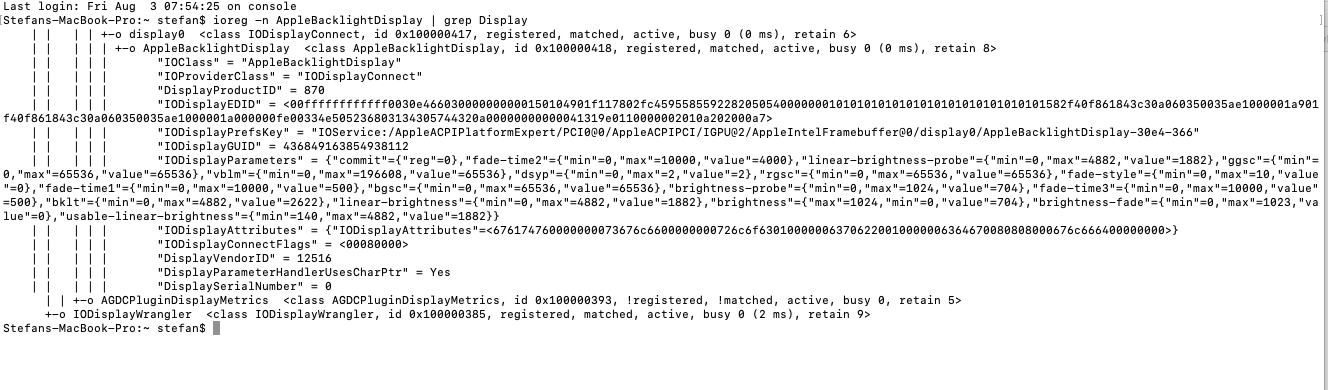

tluck Posted August 2, 2018 Share Posted August 2, 2018 (edited) 4 hours ago, stivenkar said: Thank you!Now I create AppleBacklightInjektor.kext manually,thanks for this guide and put in S/L/E and now brightness work fine! great. do you have 1600x900 or 1366x768 display? run this please and post info: ioreg -n AppleBacklightDisplay | grep Display it would be nice to find other LCDs that work without changing the EDID to the one in the 1600x900 config.plist file Edited August 2, 2018 by tluck Link to comment https://www.insanelymac.com/forum/topic/285678-lenovo-thinkpad-t420-with-uefi-only/page/168/#findComment-2628538 Share on other sites More sharing options...
stivenkar Posted August 3, 2018 Share Posted August 3, 2018 11 hours ago, tluck said: great. do you have 1600x900 or 1366x768 display? run this please and post info: ioreg -n AppleBacklightDisplay | grep Display it would be nice to find other LCDs that work without changing the EDID to the one in the 1600x900 config.plist file I have a Lenovo T520 with 1600x900 display. Link to comment https://www.insanelymac.com/forum/topic/285678-lenovo-thinkpad-t420-with-uefi-only/page/168/#findComment-2628585 Share on other sites More sharing options...
tluck Posted August 5, 2018 Share Posted August 5, 2018 ah well thanks @stivenkar - but you are injecting the same EDID I have presuming from the config.plistt Link to comment https://www.insanelymac.com/forum/topic/285678-lenovo-thinkpad-t420-with-uefi-only/page/168/#findComment-2628820 Share on other sites More sharing options...

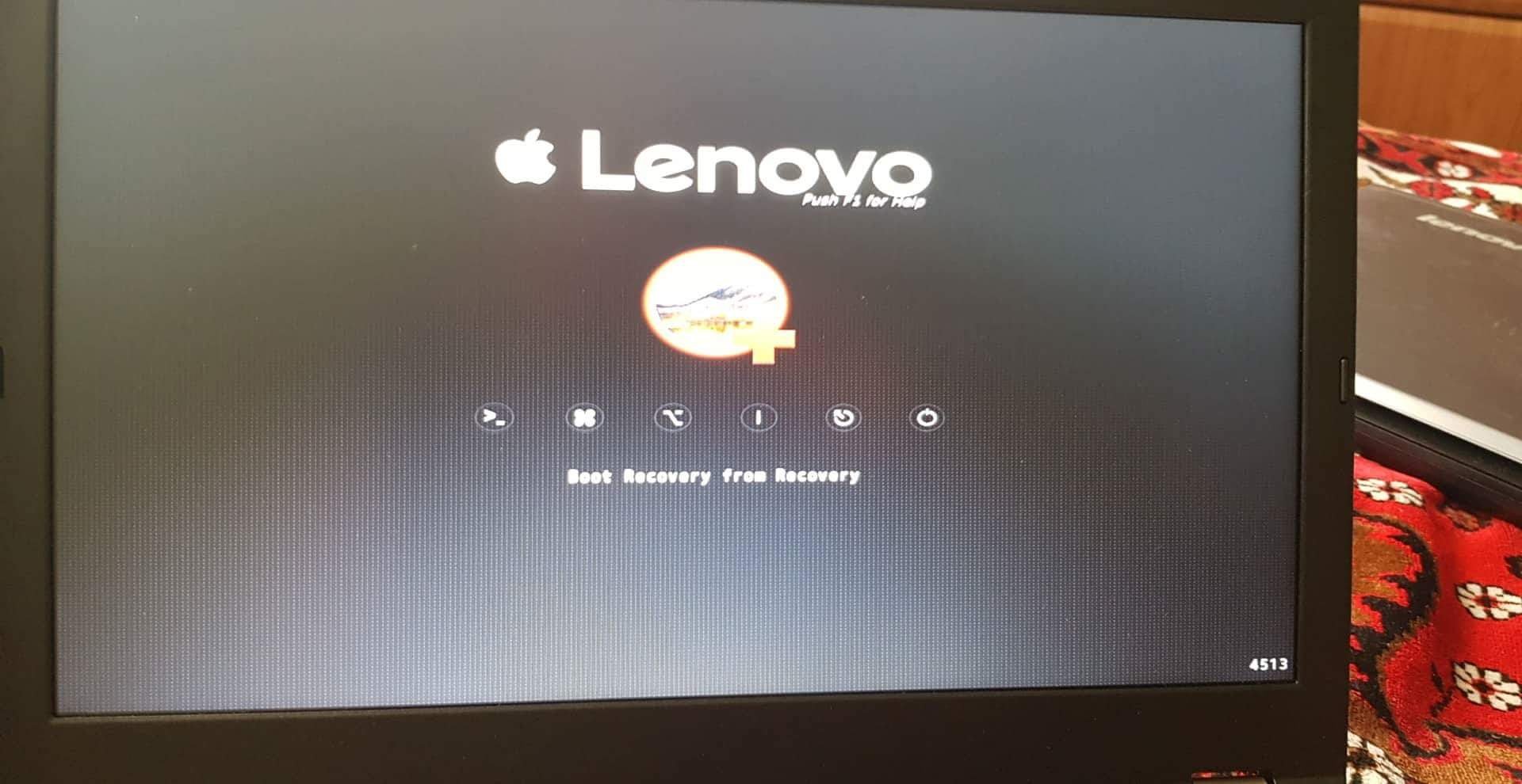

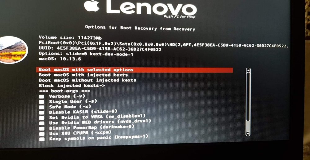

Dabman1988 Posted August 5, 2018 Share Posted August 5, 2018 Hei. I can't boot T420 after last reboot. Is regular T420 (1366x768 display) with WiFi AR5BHB92 Bios MOD Quote Features Based on v1.46 WLAN whitelist removed - can use any wireless card 1600MHz & 1866MHz RAM support 16GB RAM Support, stable with an eGPU Lots of extra menus available for additional configuration Updated splash logo included Can downgrade from 1.48 or 1.49 by using winflash's /sv /sd options I also wish to fix power off, because after power off it is just reboot, and multi fingers gestures just does not work (I mean switching between desktops etc...) same with F1 to F12 buttons, for example on F4 does not work like in mac Launchpad I install step by step https://josephsiu.com/convert-windows-10-thinkpad-t420-into-dual-boot-hackintosh-running-macos-high-sierra/ But only with one OS(10.13.6) Link to comment https://www.insanelymac.com/forum/topic/285678-lenovo-thinkpad-t420-with-uefi-only/page/168/#findComment-2628836 Share on other sites More sharing options...
Tetonne Posted August 5, 2018 Share Posted August 5, 2018 Hi to all Question: dors THE New config.plist (9.1 Work with HS and Mojave or will IT only work with Mojave? Link to comment https://www.insanelymac.com/forum/topic/285678-lenovo-thinkpad-t420-with-uefi-only/page/168/#findComment-2628863 Share on other sites More sharing options...
tluck Posted August 6, 2018 Share Posted August 6, 2018 On 8/5/2018 at 1:09 AM, Dabman1988 said: Hei. I can't boot T420 after last reboot. Is regular T420 (1366x768 display) with WiFi AR5BHB92 Bios MOD I also wish to fix power off, because after power off it is just reboot, and multi fingers gestures just does not work (I mean switching between desktops etc...) same with F1 to F12 buttons, for example on F4 does not work like in mac Launchpad I install step by step https://josephsiu.com/convert-windows-10-thinkpad-t420-into-dual-boot-hackintosh-running-macos-high-sierra/ But only with one OS(10.13.6) did you get it to boot? You can play with VoodooPS2Controller items to map keys and so on if you want to match something you like on a Mac. not all finger gestures will work as the TrackPad is not an Apple Magic Pad not sure about the reboot on power off? do you use a dock or have USB things plugged in? @Tetonne Yes - I am using the same config (mojave) for both High Sierra and Mojave - i changed 9,1 to 11,1 1 Link to comment https://www.insanelymac.com/forum/topic/285678-lenovo-thinkpad-t420-with-uefi-only/page/168/#findComment-2629074 Share on other sites More sharing options...
Dabman1988 Posted August 6, 2018 Share Posted August 6, 2018 1 hour ago, tluck said: did you get it to boot? You can play with VoodooPS2Controller items to map keys and so on if you want to match something you like on a Mac. not all finger gestures will work as the TrackPad is not an Apple Magic Pad not sure about the reboot on power off? do you use a dock or have USB things plugged in? @Tetonne Yes - I am using the same config (mojave) for both High Sierra and Mojave - i changed 9,1 to 11,1 No i can not boot it. Like U can see it shows only recovery mode, not boot partition Link to comment https://www.insanelymac.com/forum/topic/285678-lenovo-thinkpad-t420-with-uefi-only/page/168/#findComment-2629092 Share on other sites More sharing options...

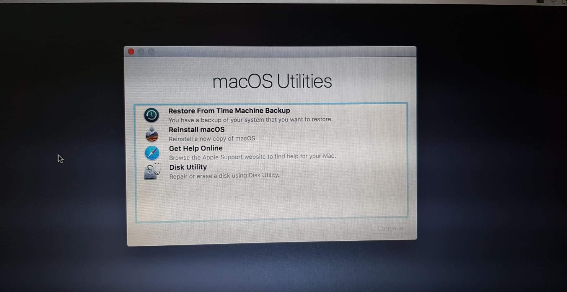

tluck Posted August 7, 2018 Share Posted August 7, 2018 bummer. well maybe you can repair the filesystem in recovery mode. what do you see in recover mode? using the disk utility to repair the disk. is this a APFS or HFS+ ? if APFS do you have all the drivers there for the latest zip? Link to comment https://www.insanelymac.com/forum/topic/285678-lenovo-thinkpad-t420-with-uefi-only/page/168/#findComment-2629141 Share on other sites More sharing options...

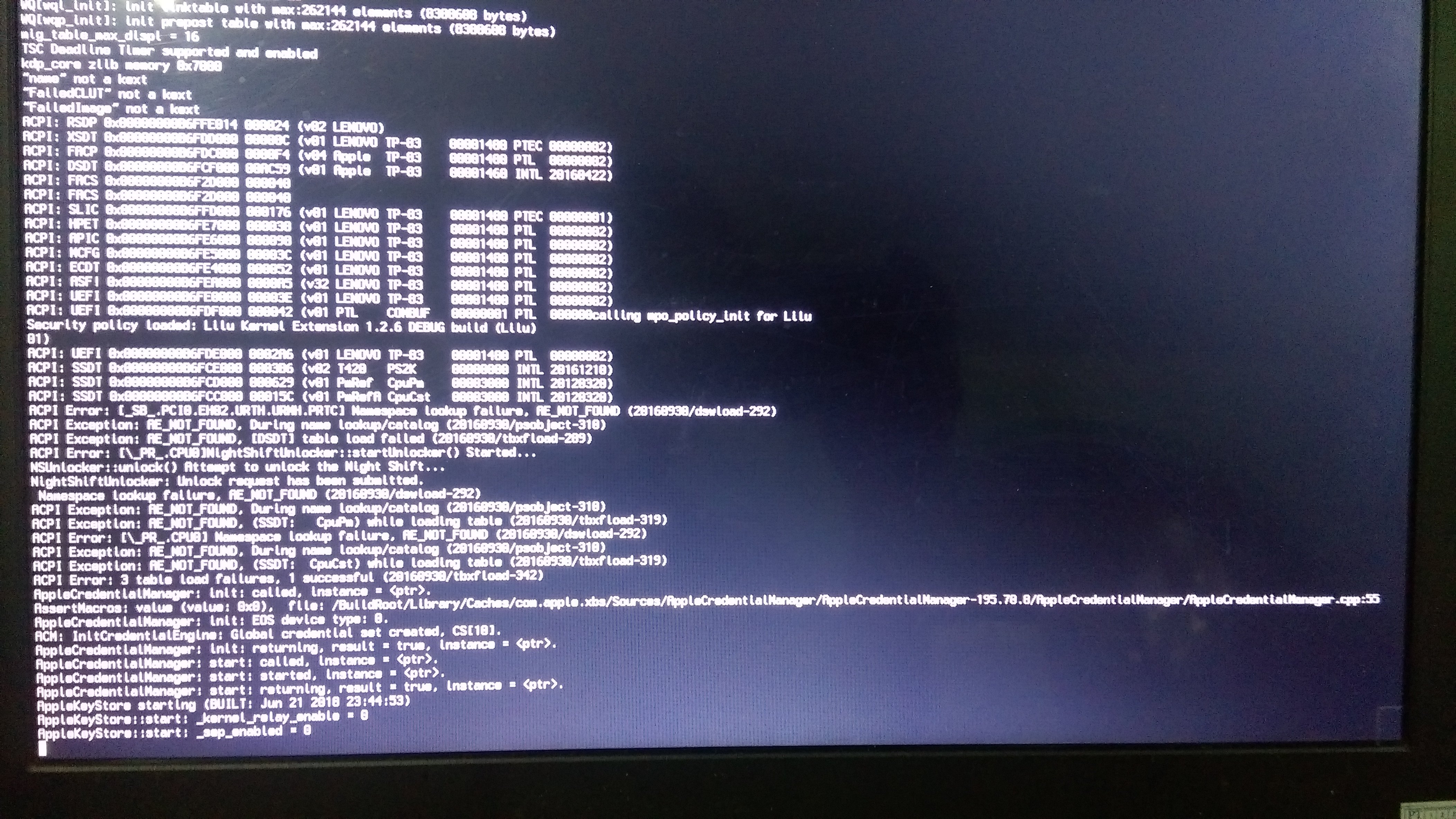

SuperReaper Posted August 12, 2018 Share Posted August 12, 2018 Hi bro, I got this error when I use any clover version greater than v2.4k r4513, and the laster efi release by u I can use is from 2018.06.04 Link to comment https://www.insanelymac.com/forum/topic/285678-lenovo-thinkpad-t420-with-uefi-only/page/168/#findComment-2629786 Share on other sites More sharing options...
tluck Posted August 13, 2018 Share Posted August 13, 2018 @SuperReaper what is your BIOS v? and what is in your ACPI/patched folder - seems like a ACPI/DSDT problem? what happens if you replace your entire CLOVER folder with the one in the zip? Link to comment https://www.insanelymac.com/forum/topic/285678-lenovo-thinkpad-t420-with-uefi-only/page/168/#findComment-2629878 Share on other sites More sharing options...
SuperReaper Posted August 13, 2018 Share Posted August 13, 2018 (edited) 10 hours ago, tluck said: @SuperReaper what is your BIOS v? and what is in your ACPI/patched folder - seems like a ACPI/DSDT problem? what happens if you replace your entire CLOVER folder with the one in the zip? Bios 1.48 mod, I use your EFI, use both dsdt e2e and 366 got the same broblem Edited August 13, 2018 by SuperReaper Link to comment https://www.insanelymac.com/forum/topic/285678-lenovo-thinkpad-t420-with-uefi-only/page/168/#findComment-2629921 Share on other sites More sharing options...
tluck Posted August 13, 2018 Share Posted August 13, 2018 (edited) 5 hours ago, SuperReaper said: Bios 1.48 mod, I use your EFI, use both dsdt e2e and 366 got the same broblem hmm. so if you use the standard DSDT.aml it works ok? do any of the provided DSDT*.aml files work? I am at a loss to understand what is going on? this could an issue with the Clover patching -- ie DSDT/ACPI fixes... maybe remove some of the "fixes" - like DeleteUnused etc - most fixes are already there in the DSDT? Edited August 13, 2018 by tluck Link to comment https://www.insanelymac.com/forum/topic/285678-lenovo-thinkpad-t420-with-uefi-only/page/168/#findComment-2629962 Share on other sites More sharing options...
SuperReaper Posted August 14, 2018 Share Posted August 14, 2018 (edited) 19 hours ago, tluck said: hmm. so if you use the standard DSDT.aml it works ok? do any of the provided DSDT*.aml files work? I am at a loss to understand what is going on? this could an issue with the Clover patching -- ie DSDT/ACPI fixes... maybe remove some of the "fixes" - like DeleteUnused etc - most fixes are already there in the DSDT? If I use clover v2.4 r4513 or lower, all your DSDT ok, but when I use later version of clover, I got that error even I change all possible dsdt u provide! Edited August 14, 2018 by SuperReaper Link to comment https://www.insanelymac.com/forum/topic/285678-lenovo-thinkpad-t420-with-uefi-only/page/168/#findComment-2630059 Share on other sites More sharing options...
tluck Posted August 14, 2018 Share Posted August 14, 2018 can you try this config.plist that turns off all DSDT edits? you should just have 2 files - DSDT.aml and SSDT-T420-PS2K.aml - in CLOVER/ACPI/patched right? config.nopatch.plist.zip Link to comment https://www.insanelymac.com/forum/topic/285678-lenovo-thinkpad-t420-with-uefi-only/page/168/#findComment-2630077 Share on other sites More sharing options...
SuperReaper Posted August 15, 2018 Share Posted August 15, 2018 20 hours ago, tluck said: can you try this config.plist that turns off all DSDT edits? you should just have 2 files - DSDT.aml and SSDT-T420-PS2K.aml - in CLOVER/ACPI/patched right? config.nopatch.plist.zip It can't boot with bios (no) dsdt, but I can't use wifi or any function key which patched in dsdt! Link to comment https://www.insanelymac.com/forum/topic/285678-lenovo-thinkpad-t420-with-uefi-only/page/168/#findComment-2630206 Share on other sites More sharing options...
