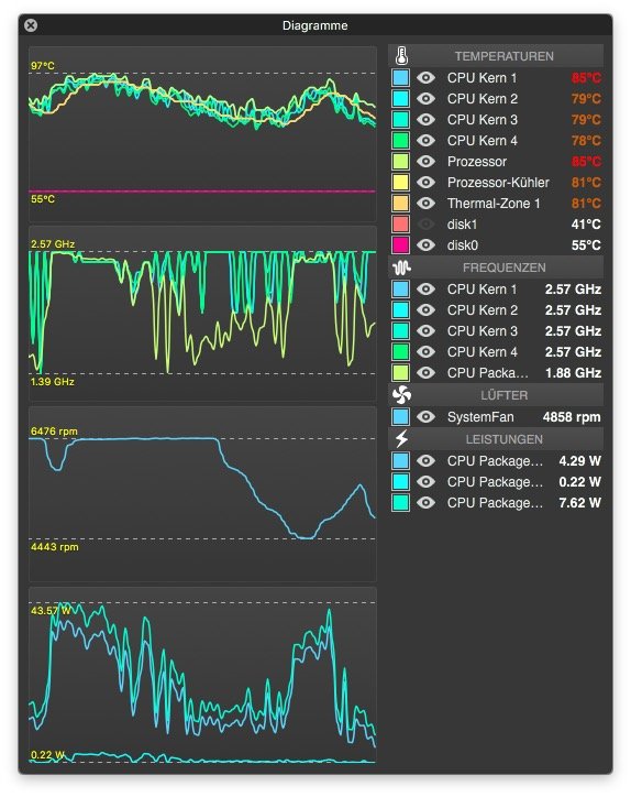

tluck Posted September 25, 2018 Share Posted September 25, 2018 11 hours ago, freddie said: My fans are quiet on Sierra with my T420s i7-2620@2.7GHz. Maybe dust on the fans? @pcace there is a option/fix to fan speed/heat. instead of relying on the bios to change fans speed which only seemed to run at 2 speeds. The "heat-step" DSDT versions has modified method to change fans speed depending on CPU temp - this requires using it + ACPIPoller.kext - both outlined in the Guide. you can modify temp triggers to match your needs - but there are 7 levels if I remember. Link to comment https://www.insanelymac.com/forum/topic/285678-lenovo-thinkpad-t420-with-uefi-only/page/174/#findComment-2636625 Share on other sites More sharing options...

pcace Posted September 26, 2018 Share Posted September 26, 2018 On 9/25/2018 at 8:46 AM, tluck said: @pcace there is a option/fix to fan speed/heat. instead of relying on the bios to change fans speed which only seemed to run at 2 speeds. The "heat-step" DSDT versions has modified method to change fans speed depending on CPU temp - this requires using it + ACPIPoller.kext - both outlined in the Guide. you can modify temp triggers to match your needs - but there are 7 levels if I remember. Hey there! thank you again and again for your great work here!! I kind of missed the point here i am using the heat-step dsdt. And it is kind of working. I just realized, that under windows the fan can go up to 6500rpm. And i really would love to see that behaviour on the mac too. Not everytime, but when i am using this T420 in very hot environments... ...i do get scared, that i could ruin the machine - working at +100°C for hours and hours... Any idea how to achieve that? Cheers and thanks!!!! PS.: i do know about this here: /* FAN control START */ If (LGreaterEqual (Local0, 0x55)) // CPU Temp is >= 85C { Store (0x07, \_SB.PCI0.LPC.EC.HFSP) } // Set FAN Mode 7 - Maximum Speed Else { If (LGreaterEqual (Local0, 0x50)) // CPU Temp is >= 80C { Store (0x06, \_SB.PCI0.LPC.EC.HFSP) } // Set FAN Mode 6 Else { If (LGreaterEqual (Local0, 0x4B)) // CPU Temp is >= 75C { Store (0x05, \_SB.PCI0.LPC.EC.HFSP) } // Set FAN Mode 5 Else { If (LGreaterEqual (Local0, 0x46)) // CPU Temp is >= 70C { Store (0x04, \_SB.PCI0.LPC.EC.HFSP) } // Set FAN Mode 4 Else { If (LGreaterEqual (Local0, 0x41)) // CPU Temp is >= 65C { Store (0x03, \_SB.PCI0.LPC.EC.HFSP) } // Set FAN Mode 3 Else { If (LGreaterEqual (Local0, 0x3C)) // CPU Temp is >= 60C { Store (0x02, \_SB.PCI0.LPC.EC.HFSP) } // Set FAN Mode 2 Else { If (LGreaterEqual (Local0, 0x01)) // CPU Temp is >= 01C { Store (0x01, \_SB.PCI0.LPC.EC.HFSP) } // Set FAN Mode 1 - Lowest Speed } } } } } } /* FAN control END */ But it seems that Fan Mode 7 is around 4500rpm. Wich is not the fastest it can go... cheers Link to comment https://www.insanelymac.com/forum/topic/285678-lenovo-thinkpad-t420-with-uefi-only/page/174/#findComment-2637028 Share on other sites More sharing options...
pcace Posted September 26, 2018 Share Posted September 26, 2018 (edited) Hey, just a quick answer (+ question) to my last post. i did look at a acpi patch for controlling fan speed on linux and found out, that there are 2 more modes to 0-7. there is also mode 64 and mode 128. mode 64 is supposed to be "disengaged" mode, mode 128 is "auto" mode. if i try to use either one of them, nothing happens. so what i did is, open up my dsdt.dsl (former name dsdt.heat-step.dsl) in the efi/acpi folder with maciasl and swiched the line: If (LGreaterEqual (Local0, 0x55)) // CPU Temp is >= 85C { Store (0x07, \_SB.PCI0.LPC.EC.HFSP) } // Set FAN Mode 7 - Maximum Speed Else { to If (LGreaterEqual (Local0, 0x55)) // CPU Temp is >= 85C { Store (0x40, \_SB.PCI0.LPC.EC.HFSP) } // Set FAN Mode 7 - Maximum Speed Else { saved it as aml, rebooted but nothing happens (yes, i am using the acpi kext in /Lib/ext..... Is there any reason why i would not be able to engage this mode?? here are some links: https://forum.thinkpads.com/viewtopic.php?t=107512 http://www.thinkwiki.org/wiki/Patch_for_controlling_fan_speed https://www.thinkwiki.org/w/index.php?title=Code/ibm-acpi-0.11-2.6.13-fan.patch&action=raw&ctype=application/octet-stream Cheers and THANKS!!! EDIT: I dont quite know what happened, i did some reboots and now it is working!? the aml is looking like that now: /* FAN control START */ If (LGreaterEqual (Local0, 0x55)) // CPU Temp is >= 85C { Store (0x40, \_SB.PCI0.LPC.EC.HFSP) } // Set FAN Mode 7 - Maximum Speed Else { If (LGreaterEqual (Local0, 0x50)) // CPU Temp is >= 80C { Store (0x07, \_SB.PCI0.LPC.EC.HFSP) } // Set FAN Mode 6 Else { If (LGreaterEqual (Local0, 0x4B)) // CPU Temp is >= 75C { Store (0x06, \_SB.PCI0.LPC.EC.HFSP) } // Set FAN Mode 5 Else { If (LGreaterEqual (Local0, 0x46)) // CPU Temp is >= 70C { Store (0x05, \_SB.PCI0.LPC.EC.HFSP) } // Set FAN Mode 4 Else { If (LGreaterEqual (Local0, 0x41)) // CPU Temp is >= 65C { Store (0x04, \_SB.PCI0.LPC.EC.HFSP) } // Set FAN Mode 3 Else { If (LGreaterEqual (Local0, 0x3C)) // CPU Temp is >= 60C { Store (0x02, \_SB.PCI0.LPC.EC.HFSP) } // Set FAN Mode 2 Else { If (LGreaterEqual (Local0, 0x01)) // CPU Temp is >= 01C { Store (0x01, \_SB.PCI0.LPC.EC.HFSP) } // Set FAN Mode 1 - Lowest Speed } } } } } } /* FAN control END */ Thanks!!! Edited September 27, 2018 by pcace Link to comment https://www.insanelymac.com/forum/topic/285678-lenovo-thinkpad-t420-with-uefi-only/page/174/#findComment-2637042 Share on other sites More sharing options...
