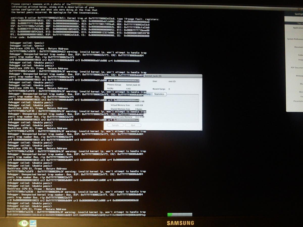

wastez Posted January 7, 2013 Share Posted January 7, 2013 I wanna start testing again, Currently I have the Nawcom Legacy kernel (which I have to use cpus=1 cause I have a sucky TSC sync problem! and VoodooTSCSyncAMD breaks the system!) System Spec: ECS A785GM-AD3 AMD Phenom II X6 1055T AMD Radeon HD6570 DDR3 8GB With the Sinetek Kernel I get a KP, booting with arch=i386 maxmem=4096 cpus=1 works on the nawcom kernel. Sinetek booting with mach_kernel arch=x86_64 maxmem=4096 cpus=1 -v enters this infiniant loop of a KP and booting without cpus=1 gives me a warning that it is out of sync, will post a screenshot of both now. "http://imageshack.us.../photo1au.jpg/" - TSC Sync "http://imageshack.us.../photoheu.jpg/" - KP As Deltac0 allready said, the new kernel is just 64 bit, so please use arch=x86_64 Cause of the cpus=1 problem. Did you allready edit your dsdt? You need to remove the alias entry´s in the cpu section. Link to comment https://www.insanelymac.com/forum/topic/285180-snow-leopard-kernel-testing-on-amd/page/3/#findComment-1878696 Share on other sites More sharing options...
