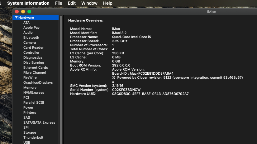

I test with as config.plist with mojave ( and r5123.pkg):
I lost  screen display, and no change is anymore possible (including applications)

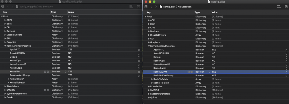

@Jief_Machak, @Slice,
As I mentioned in my previous post, the recent commit r5123_641b75e will cause problems for users migrating from old Clover because of backwards incompatibility with their old config.plist settings.
Old Clover KernelAndKextPatches settings matched to OC 0.6.1 Kernel/Quirks
  • OC AppleCpuPmCfgLock = Clover's AppleIntelCPUPM (power management for Sandy/IvyBridge CPUs needing patched AppleIntelCPUPowerManagement.kext, not Clover's KernelPm which enables Kernel Power Management for Haswell and newer CPUs)
  • OC AppleXcpmCfgLock = Clover's KernelPm (not KernelXCPM which was for IvyBridge CPUs according to old Clover wiki @SourceForge).
In order to boot with r5123_641b75e or newer on my NUC6i5SYH, I have to replace config.plist/KernelAndKextPatches/KernelPm=Yes with config.plist/KernelAndKextPatches/KernelXCPM=Yes, otherwise early boot hang due to locked kernel msrs...

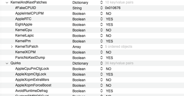

19 hours ago, fusion71au said:
@Slice, @stevezheng,
About recent commit 641b75e based on the above post.
AFAIK,
Please confirm with OC 0.6.1 Configuration.pdf
After a closer look, I agree that Clover's KernelPM functions more similar to OC's AppleXcpmCfgLock. Still needs a closer look, as I didn't figure out what Clover's KernelXCPM does (maybe enable XCPM on old platforms such as Haswell?).
The definition for Clover's KernelPm is at here: https://github.com/CloverHackyColor/CloverBootloader/blob/f312117030cc0e7f903b12da26cc1aeea03caff7/rEFIt_UEFI/Platform/kernel_patcher.cpp#L917
The definition for OpenCore's AppleXcpmCfgLock is at here:
https://github.com/acidanthera/OpenCorePkg/blob/ecbed230e0786c8aa250504c6fe72924260d92fc/Library/OcAppleKernelLib/CommonPatches.c#L203
I can see they both play with _xcpm_core_scope_msrs and patch them. But maybe Clover's KernelPm does more than zero out 0xE2 MSR, more tests are needed.
I also agree that OC's AppleCpuPmCfgLock is a replacement for Clover's AppleIntelCPUPM.
The definition of Clover's AppleIntelCPUPM is at here: https://github.com/CloverHackyColor/CloverBootloader/blob/f312117030cc0e7f903b12da26cc1aeea03caff7/rEFIt_UEFI/Platform/kext_patcher.cpp#L473
And for OpenCore:
https://github.com/acidanthera/OpenCorePkg/blob/ecbed230e0786c8aa250504c6fe72924260d92fc/Library/OcAppleKernelLib/CommonPatches.c#L42
They all patch with nops, and check registers with value 0xC9, 0xB9, etc.
CC @Slice
And for OpenCore:
CC @Slice

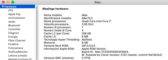

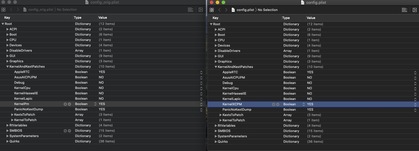

@Matgen84 which hack are you testing?
If on the p8Z77 and you can get to desktop, would you pass me the Clover you use and the config?
In my Z68 and Z97 systems I could not get to desktop with no Clover release after the 5122
@iCanaro I only test Z390 system up to commits 2fddd11, to boot Big Sur. Sorry, I don't update P8Z77 since r5122 (648f5c3d3). IvyBridge is on my TODO list.
