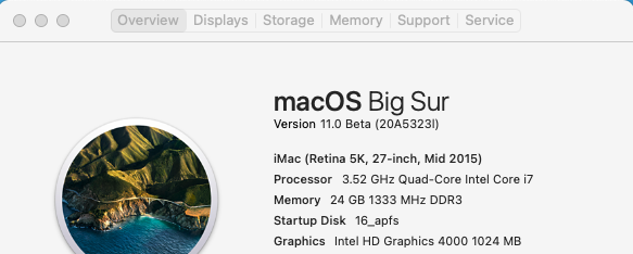

Matgen84 Posted July 27, 2020 Share Posted July 27, 2020 (edited) 6 hours ago, mifjpn said: And I try build 15b65bd ... successBigSurDevBeta3 boot confirmation info on Clover (latest build) You can boot latest commit 15b65bd from existing installed BS Beta 3 on your Hard Disk or from USB pendrive! It seems don't work on others mobo, yet. EDIT: The same issue for commit b291971: couldn't load kext, etc Edited July 27, 2020 by Matgen84 1 Link to comment https://www.insanelymac.com/forum/topic/284656-clover-general-discussion/page/893/#findComment-2732110 Share on other sites More sharing options...

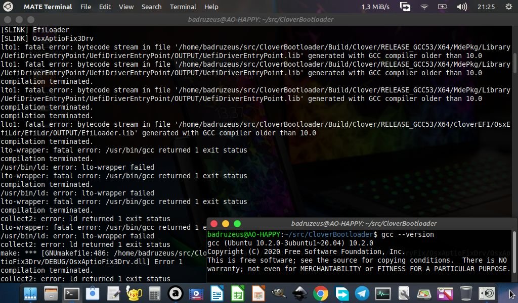

Badruzeus Posted July 27, 2020 Share Posted July 27, 2020 On 7/16/2020 at 7:00 PM, Slice said: I use gcc version 10.1.0 (GCC) OK, got it works either with GCC 10.2.0 under Ubuntu 20.04.1 LTS after 'cd ~/src/CloverBootloader && rm -R Build && make -C BaseTools clean && make -C BaseTools/Source/C && ./ebuild'.sh -fr'. Thanks. 2 Link to comment https://www.insanelymac.com/forum/topic/284656-clover-general-discussion/page/893/#findComment-2732145 Share on other sites More sharing options...

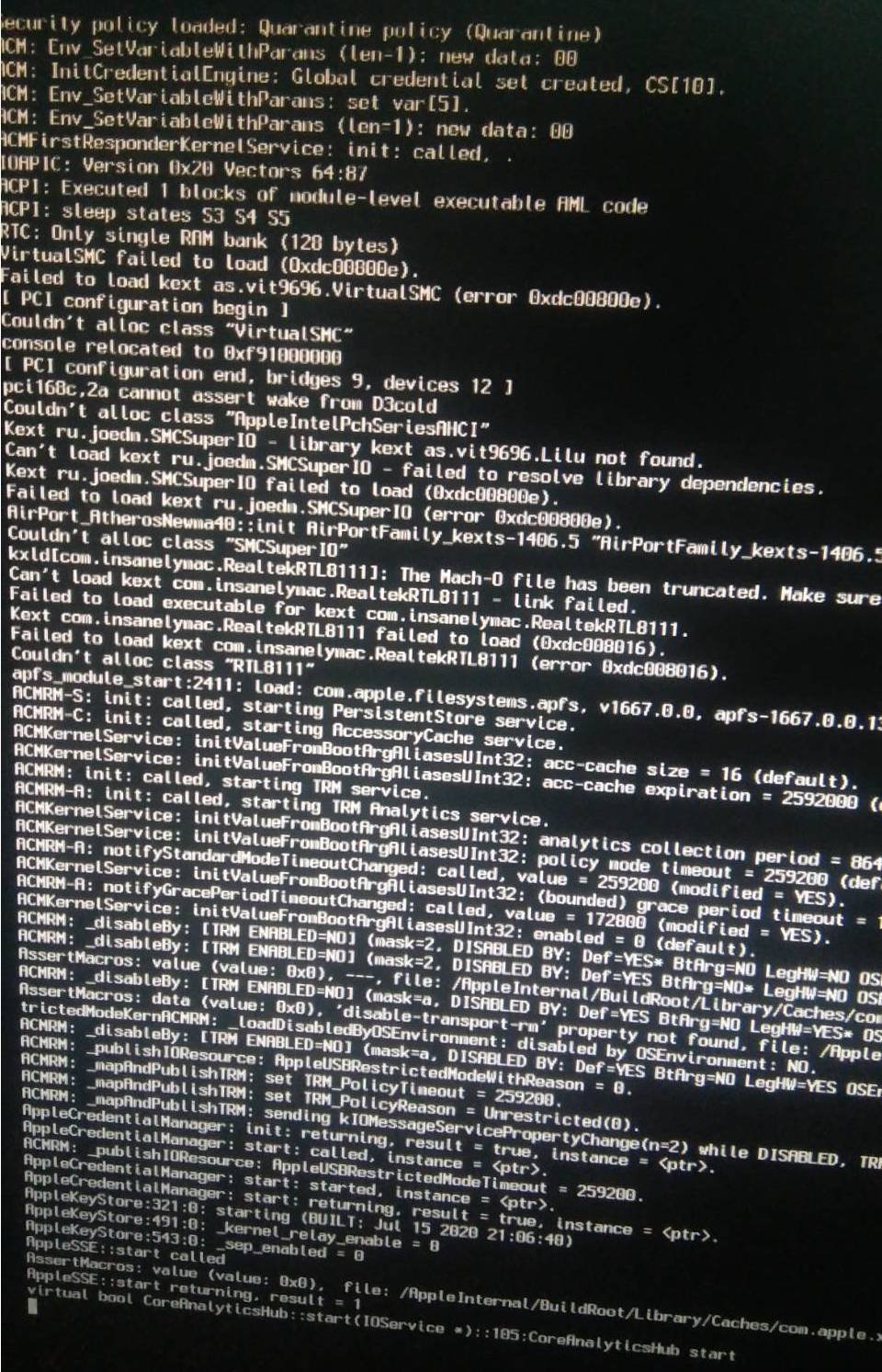

Matgen84 Posted July 27, 2020 Share Posted July 27, 2020 Hi @Slice Maybe I made a mistake somewhere I can't boot r5120 commit 0724be9 on Big Sur (works fine for Catalina) Can't boot on Big Sur Installer and Installed Big Sur: stuck this time at apfs_module:2411 Before, I see "couldn't load" kexts and "couldn't alloc" messages Spoiler debug.log 2 Link to comment https://www.insanelymac.com/forum/topic/284656-clover-general-discussion/page/893/#findComment-2732147 Share on other sites More sharing options...
yapan4 Posted July 27, 2020 Share Posted July 27, 2020 14 minutes ago, Matgen84 said: Can't boot on Big Sur Installer and Installed Big Sur: stuck this time at apfs_module:2411 Exactly the same behavior on my hackintosh from signature 1 Link to comment https://www.insanelymac.com/forum/topic/284656-clover-general-discussion/page/893/#findComment-2732150 Share on other sites More sharing options...
Slice Posted July 27, 2020 Share Posted July 27, 2020 47 minutes ago, Matgen84 said: Hi @Slice Maybe I made a mistake somewhere I can't boot r5120 commit 0724be9 on Big Sur (works fine for Catalina) Can't boot on Big Sur Installer and Installed Big Sur: stuck this time at apfs_module:2411 Before, I see "couldn't load" kexts and "couldn't alloc" messages Hide contents debug.log Delete your debug.log from misc folder. Else it grown unrestricted. And I see no debug messages in your log. See kernel_patcher.cpp line 26. There should be #define KERNEL_DEBUG 1 if you want to help me to see your problems. 1 1 Link to comment https://www.insanelymac.com/forum/topic/284656-clover-general-discussion/page/893/#findComment-2732154 Share on other sites More sharing options...

yapan4 Posted July 28, 2020 Share Posted July 28, 2020 (edited) I have little progress after Lilu, WEG, AppleALC kexts removal and re-cleaning NVRAM. Now no stop on apfs_module_start:2411 but boot process has progressed very little. Clover - yesterday's Edited July 28, 2020 by yapan4 1 Link to comment https://www.insanelymac.com/forum/topic/284656-clover-general-discussion/page/893/#findComment-2732292 Share on other sites More sharing options...
Matgen84 Posted July 28, 2020 Share Posted July 28, 2020 25 minutes ago, yapan4 said: I have little progress after Lilu, WEG, AppleALC kexts removal and re-cleaning NVRAM. Now no stop on apfs_module_start:2411 but boot process has progressed very little. Clover - yesterday's Hi @yapan4 What do you mean by "after Lilu, WEG, AppleALC kexts removal" Link to comment https://www.insanelymac.com/forum/topic/284656-clover-general-discussion/page/893/#findComment-2732293 Share on other sites More sharing options...
yapan4 Posted July 28, 2020 Share Posted July 28, 2020 (edited) 4 hours ago, Matgen84 said: Hi @yapan4 What do you mean by "after Lilu, WEG, AppleALC kexts removal" As @Slice say, now Clover can inject kexts but can't load acidanthera kexts. So I delete all this kexts from /EFI/Clover/kexts/Others and try boot with FakeSMC only. Now I have stop on 'still waiting for root device' debug.log Edited July 28, 2020 by yapan4 2 Link to comment https://www.insanelymac.com/forum/topic/284656-clover-general-discussion/page/893/#findComment-2732300 Share on other sites More sharing options...
