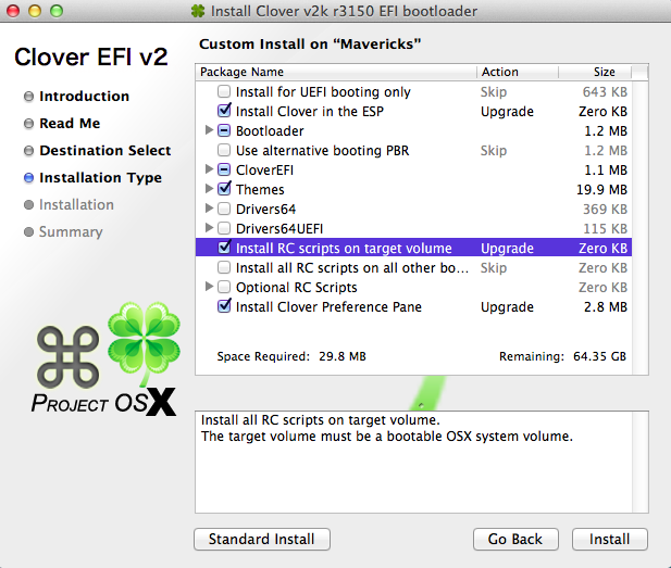

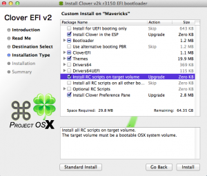

Did you install Clover with the "Install RC scripts" option?
This option enables installation of Clover's launchd scripts, necessary to save NVRAM variables on legacy machines that don't have real (hardware) NVRAM ---> saved to NVRAM.plist file on disk.  I would recommend checking this since NVRAM is required for proper iMessage/Facetime functioning (MLB/ROM vars are saved to NVRAM).
Look at Clover's boot log and see if nvram.plist is being loaded eg
bdmesg | grep nvram
2:511  0:037  Loading nvram.plist from Vol 'OSX Yosemite' - loaded, size=2050
2:516  0:005  PutNvramPlistToRtVars ...
Also did you save your config.plist properly?  If you use Clover configurator, you need to click the icon on the bottom left to "Export Configuration" to save any changes made to MLB & ROM in RtVariables.
