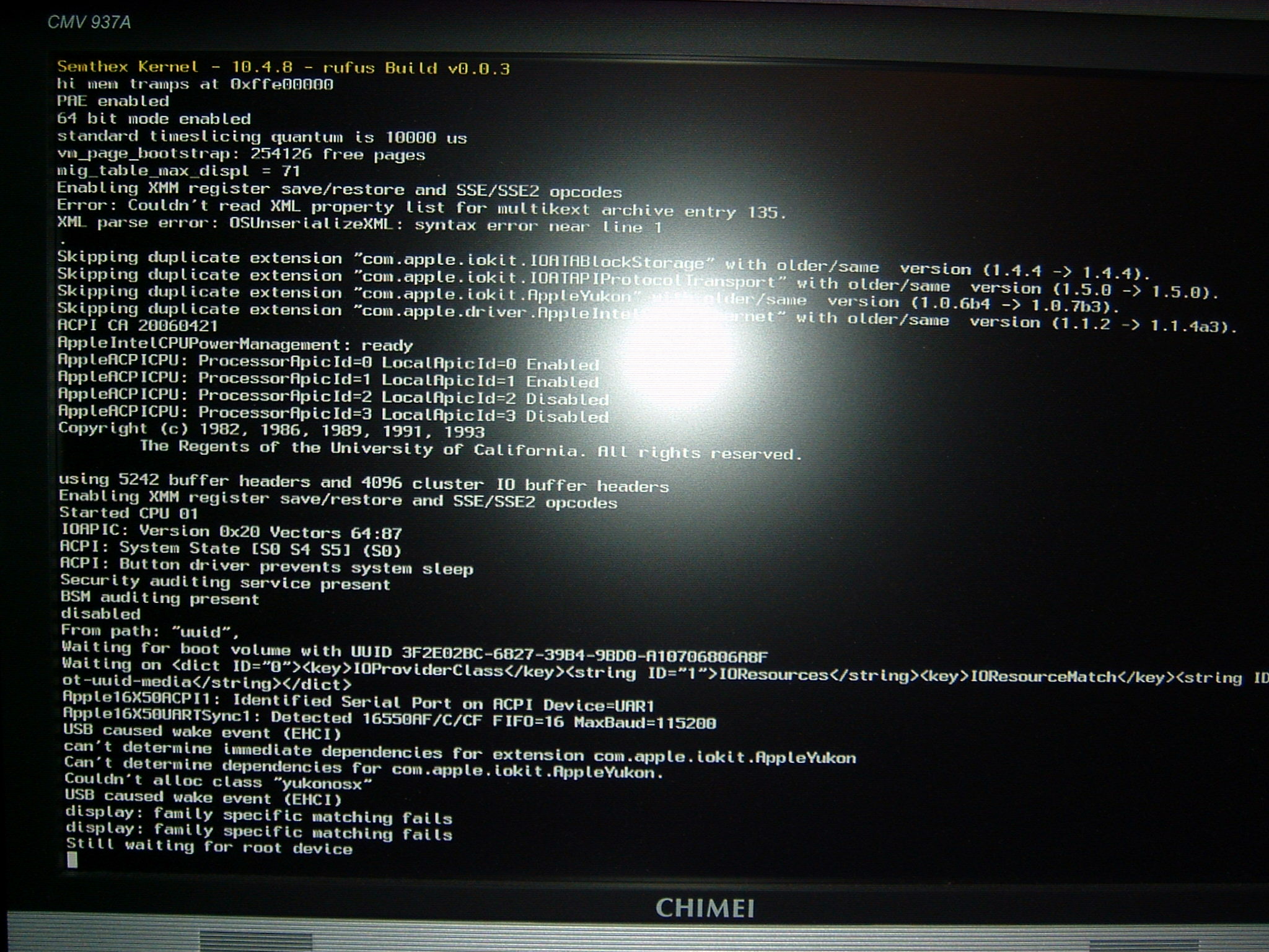

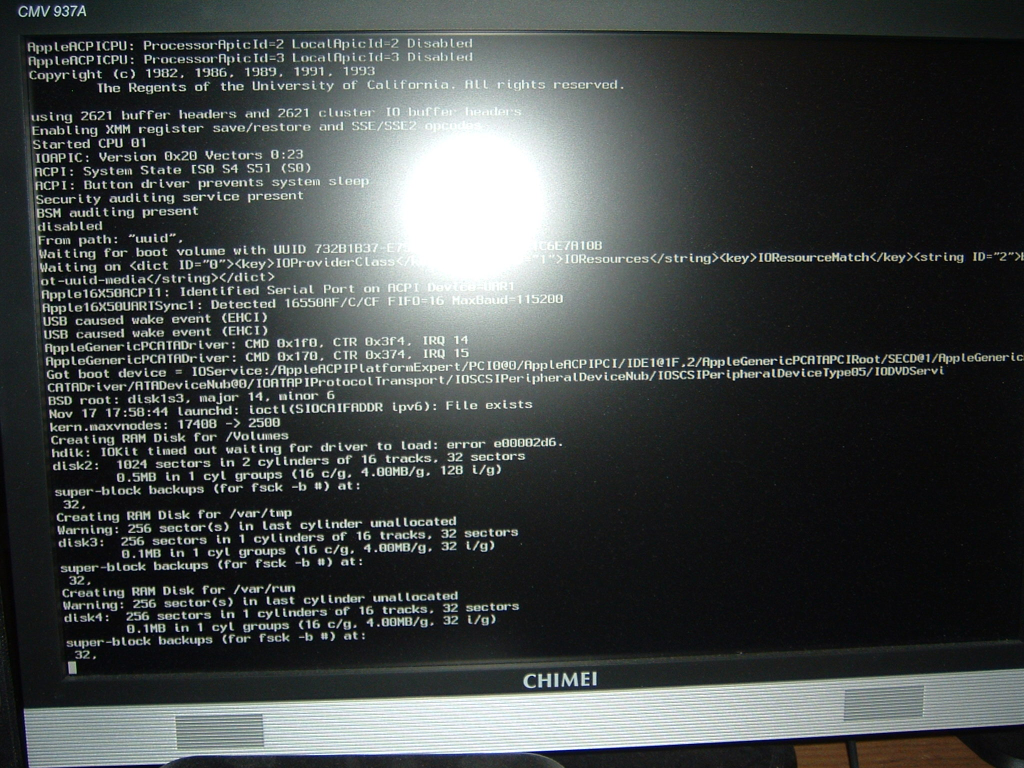

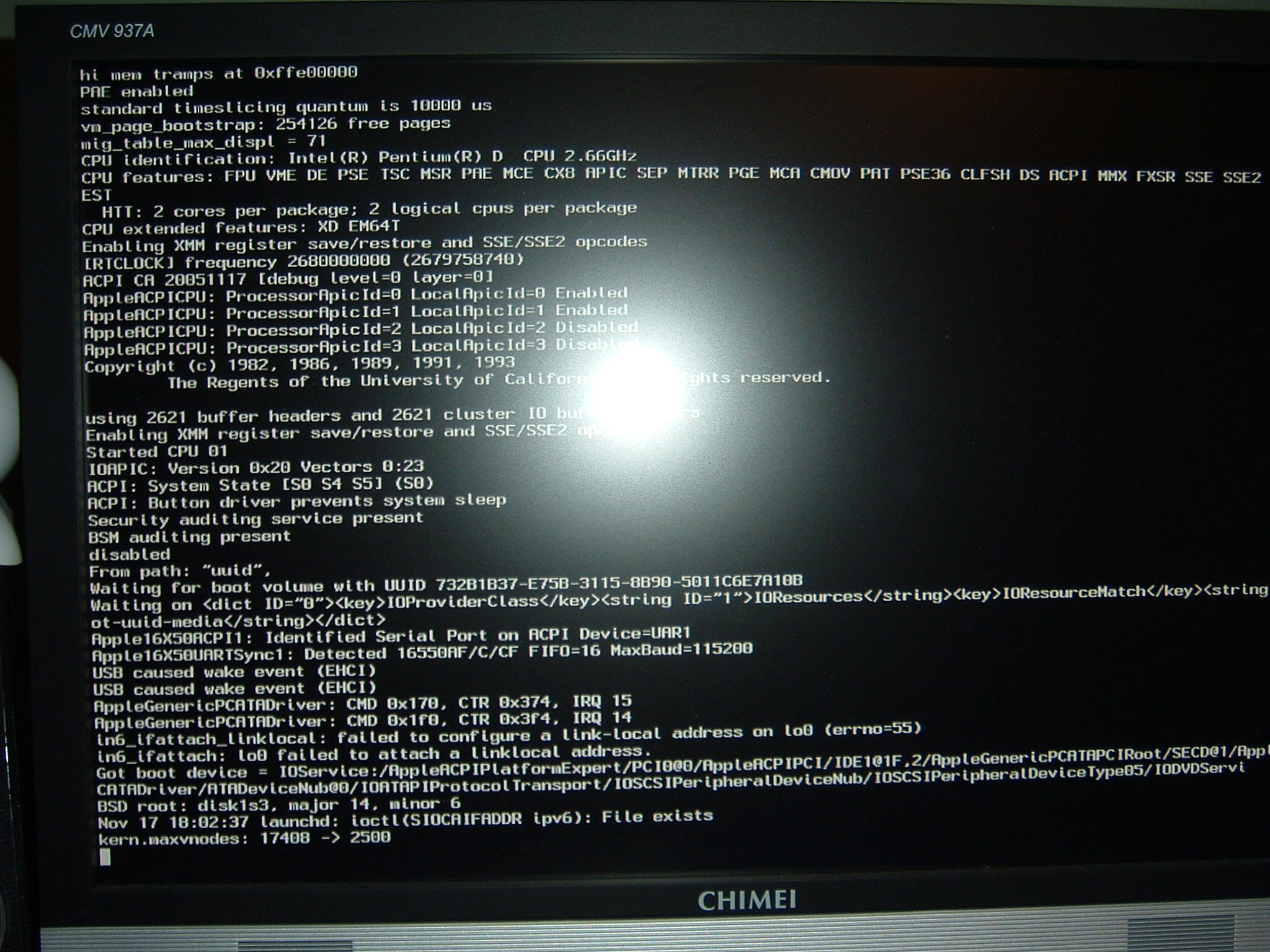

Conroe Mac Posted November 18, 2006 Share Posted November 18, 2006 I am able to boot Jas 10.4.6 and Jas 10.4.7 but not 10.4.8. First image is 10.4.8, then 10.4.7, then 10.4.6 Setup is same for all three boots. Key differences concerning 10.4.8 from 10.4.6: 64 Bit mode enabled Does not recognize the CPU as Pentium D XML Parse error: OS UnserializeXML: syntax error near line 1 skipping duplicate extension "com.apple.iokit.IOATABlockStorage skipping duplicate extension "com.apple.iokit.IOATAPIProtocol Transport" skipping duplicate extension "com.apple.iokit.AppleYukon" skipping duplicate extension "com.apple.driver.AppleInter...." ACPI CA 200060421 (10.4.6 is 20051117 [debuge level=0 layer=0] using 5242 buffer headers and 4096 cluster IO buffer headers (10.4.6 is 2621 buffer headers and 2621 clusters IO buffer headers) Link to comment https://www.insanelymac.com/forum/topic/28439-howto-gigabyte-ga-965p-ds3-osx-10471048-jas/page/3/#findComment-237286 Share on other sites More sharing options...
Sabr Posted November 18, 2006 Share Posted November 18, 2006 Try booting with: -v platform=X86PC fsb=yourfsb Replac yourfsb with, well, your FSB lol P.S. You are using the JaS ReSeed 10.4.8, right? The original wouldn't let me boot... Link to comment https://www.insanelymac.com/forum/topic/28439-howto-gigabyte-ga-965p-ds3-osx-10471048-jas/page/3/#findComment-237342 Share on other sites More sharing options...
