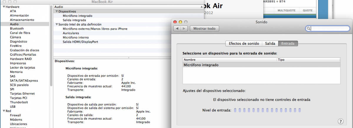

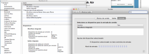

grisno Posted September 27, 2014 Share Posted September 27, 2014 I leave you some information that I hope will be useful to activate the sound card IDT 92HD87B2/4 (111D:76D9) on OSX 10.8.5 and 10.9.5 Original Verbs: 00a71cf0 00a71d00 00a71ef0 00a71f40 00b71c1f 00b71d10 00b71e21 00b71f04 00c71c20 00c71d10 00c71ea1 00c71f04 00d71c10 00d71d01 00d71e17 00d71f90 00f71cf0 00f71d00 00f71ef0 00f71f40 01171c30 01171d01 01171ea3 01171fd5 Modified Verbs: 00A71CF0 00A71D00 00A71EF0 00A71F40 01371C40 01371D10 01371E21 01371F04 00C71C20 00C71D10 00C71E81 00C71F04 01471C10 01471D01 01471E17 01471F90 00F71C50 00F71D00 00F71EF0 00F71F40 01171C30 01171D01 01171EA0 01171F90 AppleHDAHardwareConfigDriver.kext > Info.plist <key>HDAConfigDefault</key> <array> <dict> <key>CodecID</key> <integer>287143641</integer> <key>ConfigData</key> <data> AKcc8ACnHQAApx7wAKcfQAE3HEABNx0QATce IQE3HwQAxxwgAMcdEADHHoEAxx8EAUccEAFH HQEBRx4XAUcfkAD3HFAA9x0AAPce8AD3H0AB FxwwARcdAQEXHqABFx+Q </data> <key>FuncGroup</key> <integer>1</integer> <key>LayoutID</key> <integer>12</integer> </dict> </array> DSDT Fix: Method (_DSM, 4, NotSerialized) // _DSM: Device-Specific Method { Store (Package (0x0A) { "built-in", Buffer (One) { 0x00 }, "MaximumBootBeepVolume", Buffer (One) { 0x4D }, "hda-gfx", Buffer (0x0A) { "onboard-1" }, "layout-id", Buffer (0x04) { 0x0C, 0x00, 0x00, 0x00 }, "PinConfigurations", Buffer (Zero) {} }, Local0) DTGP (Arg0, Arg1, Arg2, Arg3, RefOf (Local0)) Return (Local0) } Status: Speakers : OK Headphones : OK HDMI Audio : OK (Intel HD3K/4K Tested) LineIn : OK MicInt : OK MicExt : OK Sleep : OK WakeUp : OK AutoSleep : OK I created an installer to simplify this task. It can be downloaded from: http://www.hackintoshosx.com/files/file/4222-idt-92hd87b24-111d76d9/ convert_codec_dump_dec.txt verbs.txt convert_codec_dump_dec.txt.svg.zip layout12.xml.zlib.zip Platforms.xml.zlib.zip audio.zip 1 Link to comment https://www.insanelymac.com/forum/topic/283754-patched-applehdakext-for-codecs-idt-92hd81b1x5-92hd91bxx-92hd87b13-92hd87b24-92hd87xx-etc/page/7/#findComment-2064345 Share on other sites More sharing options...
Micky1979 Posted September 27, 2014 Author Share Posted September 27, 2014 I'm sure that this can works well in Yosemite too Link to comment https://www.insanelymac.com/forum/topic/283754-patched-applehdakext-for-codecs-idt-92hd81b1x5-92hd91bxx-92hd87b13-92hd87b24-92hd87xx-etc/page/7/#findComment-2064356 Share on other sites More sharing options...
grisno Posted October 4, 2014 Share Posted October 4, 2014 Added support for sound card IDT 92HD87B2/4 (111D:76D9) in OSX Lion 10.7.5 Status: Speakers : OK Headphones : OK HDMI Audio : OK (Intel HD3K/4K Tested) LineIn : OK MicInt : OK MicExt : OK Sleep : OK WakeUp : OK AutoSleep : OK I created an installer to simplify this task. It can be downloaded from: http://www.hackintos...87b24-111d76d9/ I'll try with OSX Snow Leopard 10.6.8 ... layout12.xml.zip Platforms.xml.zip Link to comment https://www.insanelymac.com/forum/topic/283754-patched-applehdakext-for-codecs-idt-92hd81b1x5-92hd91bxx-92hd87b13-92hd87b24-92hd87xx-etc/page/7/#findComment-2066235 Share on other sites More sharing options...
