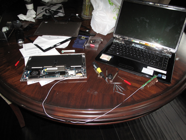

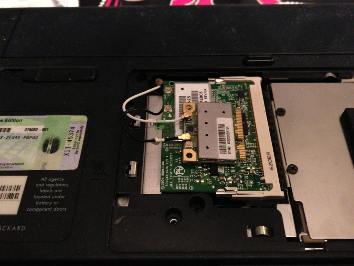

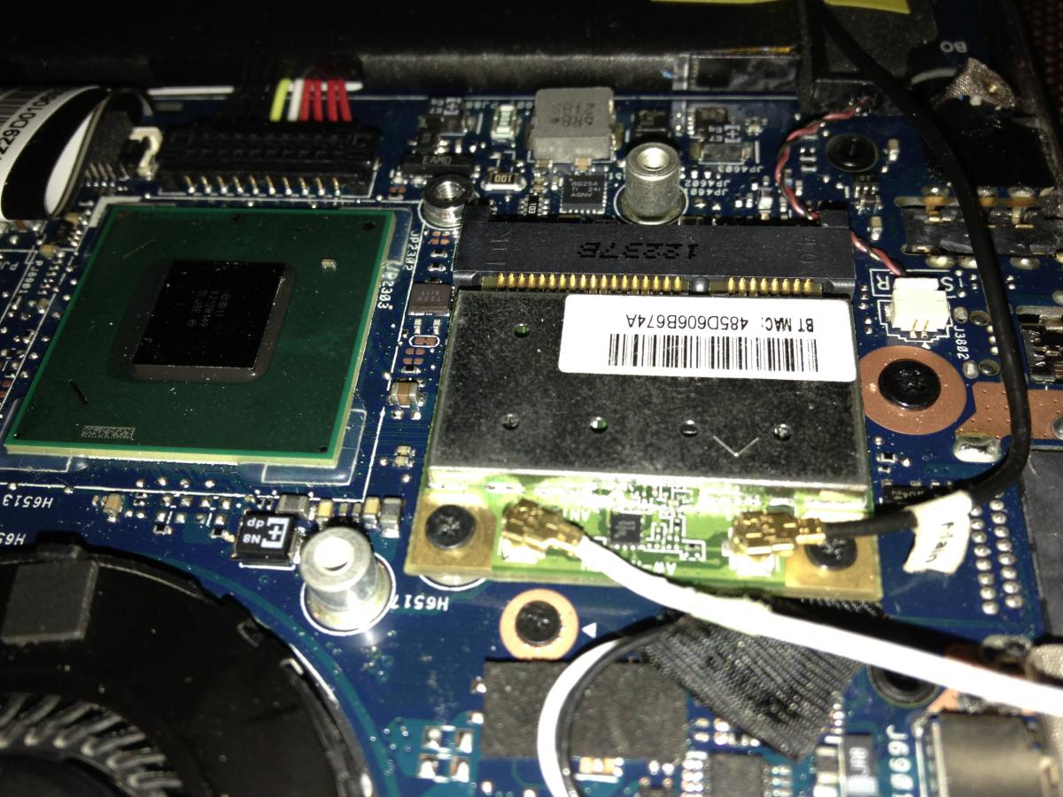

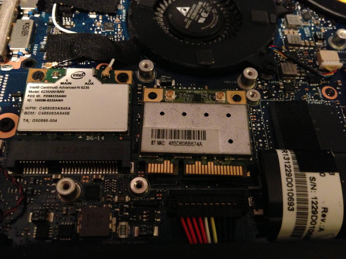

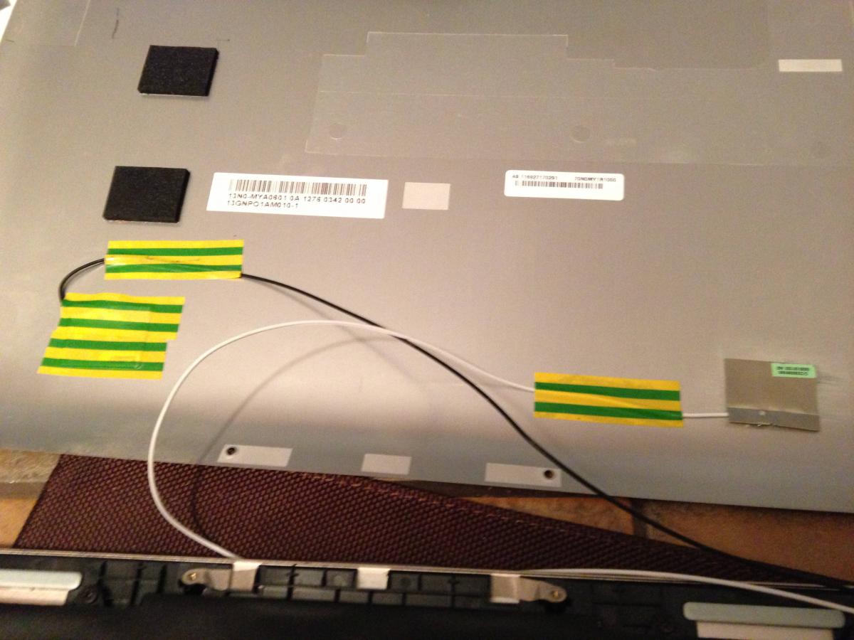

Thomas2111 Posted November 23, 2012 Share Posted November 23, 2012 Got wifi working, that is realy difficult with the Atheros card (u/fl) and an antena from an old PC see the pictures below the backplate is connected to the antenna with the screws i've put back the intel centrino card (w/fl) and the antenna because my W/fl antena don't receive the wifi signal over 10 meter (WHY my multimeter indicates me that all is right) Link to comment https://www.insanelymac.com/forum/topic/283038-asus-zenbook-prime-ux31a-db51-ultrabook-fixes-mods-tweaks-etc/page/7/#findComment-1868556 Share on other sites More sharing options...

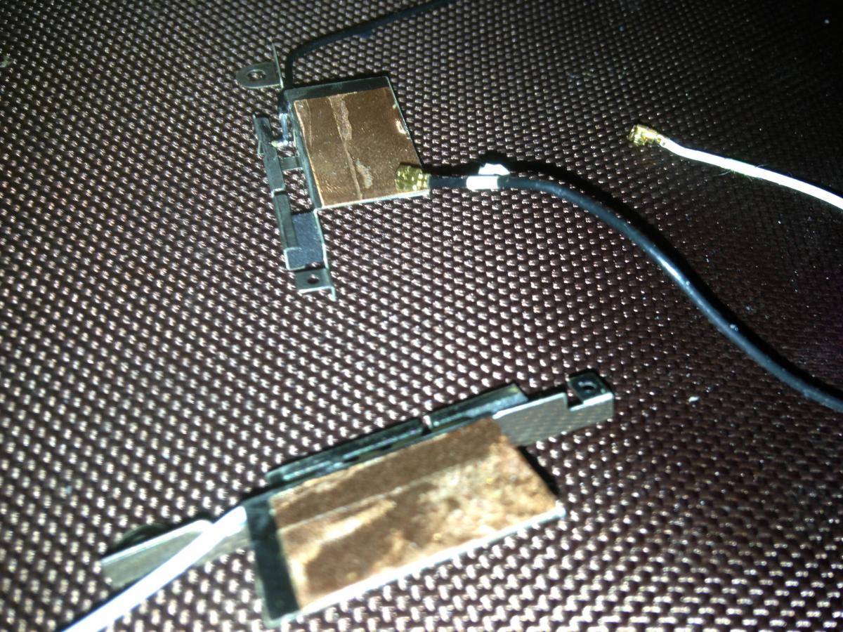

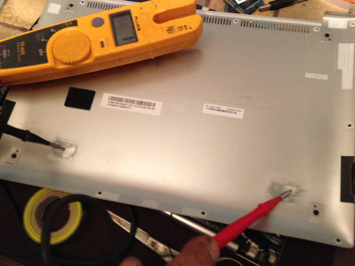

Thomas2111 Posted November 23, 2012 Share Posted November 23, 2012 1. Is 2.jpg a picture of the original ASUS antennas (the ones you're calling W/fl?)? They are soldered to brackets? 2. Why are you shorting the replacement antennas (that is, electrically connecting the tips of the replacement antennas to the back cover) in 5.jpg? That completely changes the electrical characteristics of the antennas. Try it without connecting the antennas to anything on the other end. In 2.jpg it is the W/FL coax antenna from the old pc, that fits with the atheros w/fl socket in the old pc they was soldered to brackets and connected on a big aluminium sheet in the screen ( 17" ) that i replaced by the asus backplate, i think it's connected on another aluminum sheet in the asus'screen by screw contact because all screws are electrical-maped (multimeter have spoken ) i'll try tomorow to connect the antenna to nothing else than the card, but i'm not hopefully, we'll see. BBS [Edit] tryed, but still ~10 meters. I'm thinking about keep the intel or soldering W/FL coax connectors from my old antenna on the asus antenna cable\ [Edit] Done, works fine, i have the wifi airplay, airdrop Link to comment https://www.insanelymac.com/forum/topic/283038-asus-zenbook-prime-ux31a-db51-ultrabook-fixes-mods-tweaks-etc/page/7/#findComment-1868574 Share on other sites More sharing options...
cyf Posted November 24, 2012 Share Posted November 24, 2012 In 2.jpg it is the W/FL coax antenna from the old pc, that fits with the atheros w/fl socket in the old pc they was soldered to brackets and connected on a big aluminium sheet in the screen ( 17" ) that i replaced by the asus backplate, i think it's connected on another aluminum sheet in the asus'screen by screw contact because all screws are electrical-maped (multimeter have spoken ) i'll try tomorow to connect the antenna to nothing else than the card, but i'm not hopefully, we'll see. BBS [Edit] tryed, but still ~10 meters. I'm thinking about keep the intel or soldering W/FL coax connectors from my old antenna on the asus antenna cable\ [Edit] Done, works fine, i have the wifi airplay, airdrop Works fine = 10 meters still? Soldering those connectors are going to be difficult, no? Very small connections, including shielding! I did poorly in my radio frequency classes, but one thing I did learn is that antennas HAVE TO BE matched with the characteristics of the system, so simply replacing any one of the components may mean reception won't be as good. Also, shielding is important, so if you remove the outer ring on your new WiFi card so that the ASUS antenna is able to fit (see previous post in this thread--don't remember who did this), at the very least I would try to figure out a way to replicate (i.e., copy) the shielding function, which may mean electrically connecting the outer shielding of the ASUS cable to the part where the ring was. You have a dual-boot, right? Just to confirm it's not a software setting, can you boot into Windows and see if you get the same readings? Oh yeah, it says "BT MAC" on your card. Does the BT work? Link to comment https://www.insanelymac.com/forum/topic/283038-asus-zenbook-prime-ux31a-db51-ultrabook-fixes-mods-tweaks-etc/page/7/#findComment-1868685 Share on other sites More sharing options...
Thomas2111 Posted November 24, 2012 Share Posted November 24, 2012 Works fine = 10 meters still? Soldering those connectors are going to be difficult, no? Very small connections, including shielding! I did poorly in my radio frequency classes, but one thing I did learn is that antennas HAVE TO BE matched with the characteristics of the system, so simply replacing any one of the components may mean reception won't be as good. Also, shielding is important, so if you remove the outer ring on your new WiFi card so that the ASUS antenna is able to fit (see previous post in this thread--don't remember who did this), at the very least I would try to figure out a way to replicate (i.e., copy) the shielding function, which may mean electrically connecting the outer shielding of the ASUS cable to the part where the ring was. You have a dual-boot, right? Just to confirm it's not a software setting, can you boot into Windows and see if you get the same readings? Oh yeah, it says "BT MAC" your card. Does the BT work? before all : U/fl is the biggest of my connectors, present on the atheros card and my old antenna (about 2mm) W/fl is the smaller one, present on the asus antenna and the intel card (about 1mm \\ Work over 10 meters, i think it can work over 50m maybe more (i have a good reception) Works good on windows too about the antena, the U/FL or W/FL connectors alows 5Ghz (802.11a & 802.11n) and the 2.4Ghz (802.11 b/g/n) the asus antenna is a 802.11n (with Wl/fl cable that i cut and soldered with a U/fl one from an old antenna) thats compatible and YES thats difficult and realy small ! about the ring socket U/fL on the atheros card, i don't want to try to replace it by a smaller (U/FL), that's too small, it need a SMD solder (that's a bit difficult ) the blutooth card actually works on mac + the internal usb one, not on windows yet (just need the driver) BTW i would like to notice that i soldered my mini cable (W/fl from asus) on the antenna too so i have an antenna with W/fl and U/fl in case of i want to put again the intel card in the zenbook sorry the fiirst pic is bad but we can see the solder in grey, the mini W/fl mapped and the u/fl too in my hand (for one of the two cables, the black one) on the second pic, the two U/FL cable plugged on the atheros card, the solder and the W/fl connetors protected by chaterton Link to comment https://www.insanelymac.com/forum/topic/283038-asus-zenbook-prime-ux31a-db51-ultrabook-fixes-mods-tweaks-etc/page/7/#findComment-1868696 Share on other sites More sharing options...

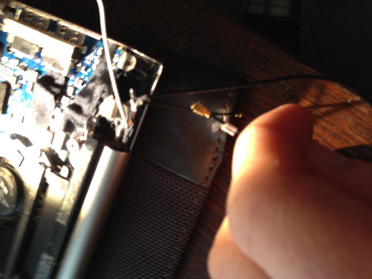

cyf Posted November 24, 2012 Share Posted November 24, 2012 ... BTW i would like to notice that i soldered my mini cable (W/fl from asus) on the antenna too so i have an antenna with W/fl and U/fl in case of i want to put again the intel card in the zenbook sorry the fiirst pic is bad but we can see the solder in grey, the mini W/fl mapped and the u/fl too in my hand (for one of the two cables, the black one) on the second pic, the two U/FL cable plugged on the atheros card, the solder and the W/fl connetors protected by chaterton Very nice. How far did you cut? WOuld have been nice to have pictures before you put the tape on. Edit: I think you mean you soldered the W/Fl cable at the antenna? Guess can't tell how you spliced it in the picture as you already assembled it in second picture, and first is blurry. Guess I should at least open mine... Link to comment https://www.insanelymac.com/forum/topic/283038-asus-zenbook-prime-ux31a-db51-ultrabook-fixes-mods-tweaks-etc/page/7/#findComment-1868709 Share on other sites More sharing options...

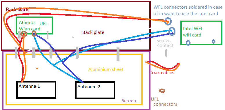

Thomas2111 Posted November 24, 2012 Share Posted November 24, 2012 Edit: I think you mean you soldered the W/Fl cable at the antenna? Guess can't tell how you spliced it in the picture as you already assembled it in second picture, and first is blurry. Guess I should at least open mine... My english is bad here is my electric shema, thanks windows, paint. everyone can understand that about the cut, all is realy short with the WFL antena, need to cut the minimal as possible Link to comment https://www.insanelymac.com/forum/topic/283038-asus-zenbook-prime-ux31a-db51-ultrabook-fixes-mods-tweaks-etc/page/7/#findComment-1868755 Share on other sites More sharing options...
vishhvaan Posted November 25, 2012 Share Posted November 25, 2012 My english is bad here is my electric shema, thanks windows, paint. everyone can understand that about the cut, all is realy short with the WFL antena, need to cut the minimal as possible I was just looking to open up the W.FL antennas as well. Did you just solder the inner conductors together or did you also solder the conducting shields? And how in the world did you manage to make the small cuts to W.FL cable? Good Job man. Has anyone else tried to open up the screen to put in their own antennas? Link to comment https://www.insanelymac.com/forum/topic/283038-asus-zenbook-prime-ux31a-db51-ultrabook-fixes-mods-tweaks-etc/page/7/#findComment-1868769 Share on other sites More sharing options...

Thomas2111 Posted November 25, 2012 Share Posted November 25, 2012 I was just looking to open up the W.FL antennas as well. Did you just solder the inner conductors together or did you also solder the conducting shields? There is no conducting shields just plastic. I isolated with the tape And how in the world did you manage to make the small cuts to W.FL cable? Good Job man. Thank you. Hum ... Self control As you can see in 2. JPG an antenna is just a métal plate and i think it would be better and easier to solder a u.fl câble from an old antenna on the asus antenna and also keep the original w/fl cable Link to comment https://www.insanelymac.com/forum/topic/283038-asus-zenbook-prime-ux31a-db51-ultrabook-fixes-mods-tweaks-etc/page/7/#findComment-1868790 Share on other sites More sharing options...
vishhvaan Posted November 25, 2012 Share Posted November 25, 2012 There is no conducting shields just plastic. I isolated with the tape http://en.wikipedia.org/wiki/File:Coaxial_cable_cutaway.svg So you're saying you removed the plastic jacket and insulator to solder only the cores together? Link to comment https://www.insanelymac.com/forum/topic/283038-asus-zenbook-prime-ux31a-db51-ultrabook-fixes-mods-tweaks-etc/page/7/#findComment-1868950 Share on other sites More sharing options...

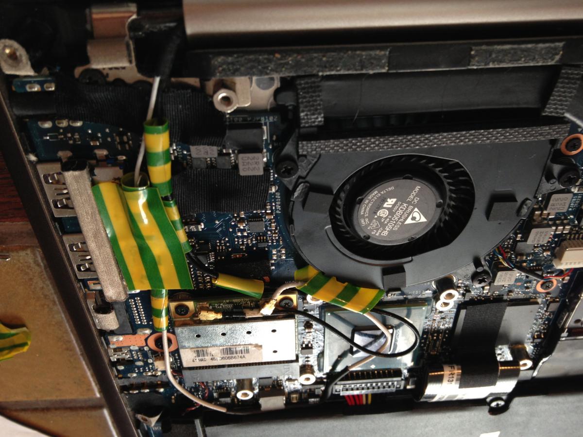

gsly Posted November 26, 2012 Share Posted November 26, 2012 Has anyone else tried to open up the screen to put in their own antennas? On the UX32VD, the antennas are not in the screen, but rather the hinge area of the screen. They connect to the metal frame of the screen via the screws that hold the antenna assembly. I simply removed the Asus assembly and cannibalized an old Dell laptop antenna to put in it's place. Any yes, stripping those wires is delicate work! 1 Link to comment https://www.insanelymac.com/forum/topic/283038-asus-zenbook-prime-ux31a-db51-ultrabook-fixes-mods-tweaks-etc/page/7/#findComment-1869054 Share on other sites More sharing options...

Thomas2111 Posted November 27, 2012 Share Posted November 27, 2012 http://en.wikipedia.org/wiki/File:Coaxial_cable_cutaway.svg So you're saying you removed the plastic jacket and insulator to solder only the cores together? Yes i did Oh yeah, just as importantly, those people with "new" Wifi cards: is the App Store working? Not yet Link to comment https://www.insanelymac.com/forum/topic/283038-asus-zenbook-prime-ux31a-db51-ultrabook-fixes-mods-tweaks-etc/page/7/#findComment-1869220 Share on other sites More sharing options...
