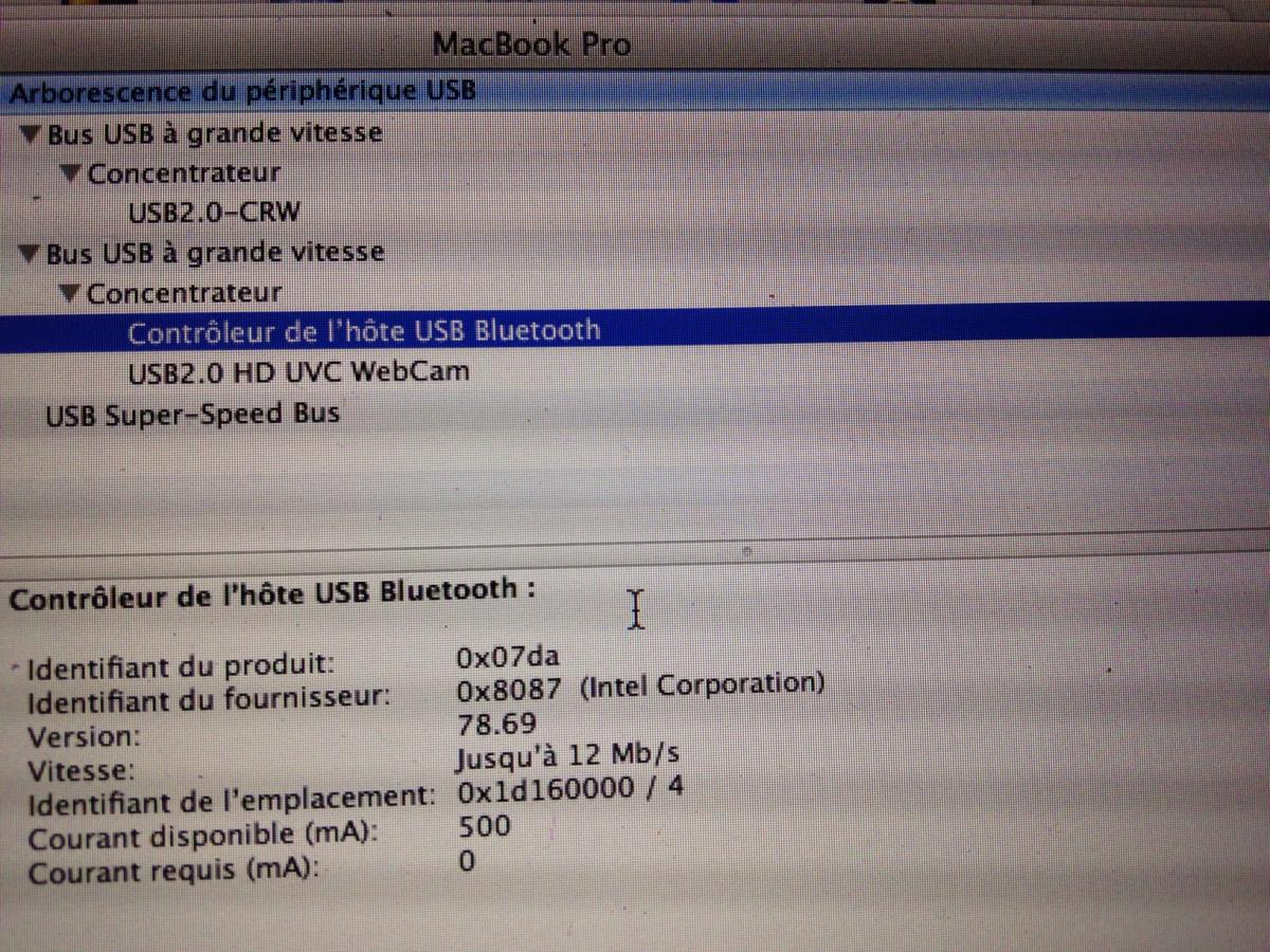

note about bluetooth in zenbooks:
there is two bluetooth adapters integrated:
2.1 bluetooth USB that work with the kext
[edit] addded screenshot of 2.1 bluetooth module on usb concentrator
4.0 bluetooth in the intel wireless Wifi / bluetooth Combo 6235 pci card, actually not working.
