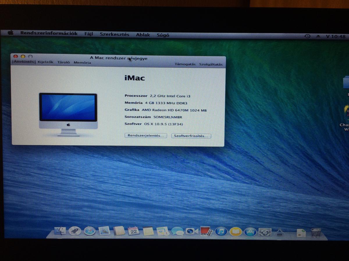

i am trying to make at 6470m working again but now with mavericks 10.9.5
i have DSDT which made by @Trucker MK
i patch my amd6000controller like
i changed this
00040000040300000001000012040105
00080000040200000001000011020403
to the patched :
02000000400000000901000010000201
10000000100200000001000000000403
i uploaded the clean and patched one too
when i want to start with DSDT and the patched amd6000 i got no errors but this this grey screen
so i can boot only safe and its okay dsdt is working you can see it recognises my video card
Im using chameleon 2.2
i have reattached my videobios too
any ideas what could go wrong and why it doesn't boot normaly  ? Wrong patching ?

okay i will try that smbios. I don't use yosemite becasuse i yosemite creates a recovey partition and i can't make the partitions like this : apple os x, windows  and data.  because if i use yosemite there are no mbr slots left and i can't use data partition under windows.
in post 929 i attached vga bios.
Thanks for helping
Thanks for helping

Edit : this methot what ive written was working with moutain lion( pithecia+ dsdt ) , but now i don't have the the right patched kexts only the dsdt ( insanley mac old upload folder is down) . thats why i moved to mavericks

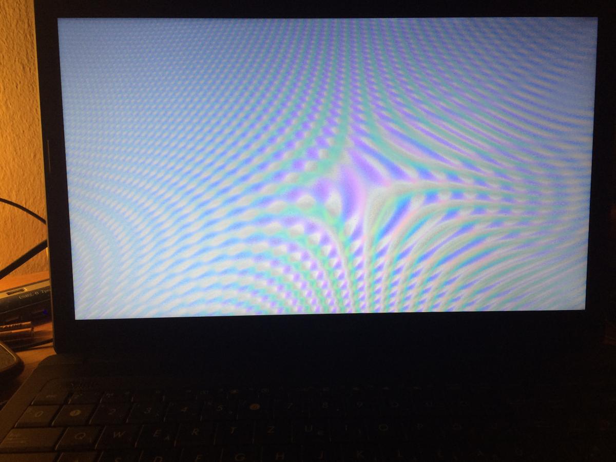

hi guys,,, i was try its, but still blank screen,,
when i use clover and fakeid 6841_1002 my graphics was 1024MB and full QE/IC but doesn't display correctly(maybe gradient), ( i will upload the picture ) but, when i use fakeid and FB=Ipomoea/Pondweed it's stuck at blank screen after vorbose boot,, i was try use windows EDID and inject to clover, but still blank screen,
here's my editing of frambuffer Pondweed
02 00 00 00 40 00 00 00 09 01 00 00 10 00 01 02
00 08 00 00 04 02 00 00 00 01 00 00 11 02 02 01
10 00 00 00 10 00 00 00 00 01 00 00 00 10 03 03
here's a pic : https://www.dropbox....5904_o.jpg?dl=0
