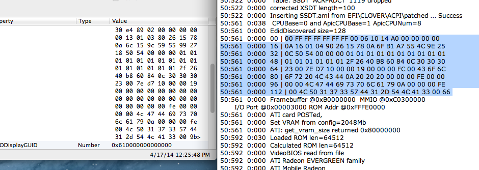

Trucker MK Posted April 17, 2014 Author Share Posted April 17, 2014 Sure. BTW, I i switched to Clover because of "on the fly" patching and mostly for the EDID injection but it turns out that i can't inject the EDID with Clover. Anyone else with 6650M on the Aspire 7750G having success ? Link to comment https://www.insanelymac.com/forum/topic/277042-amd-radeon-hd-6650m-graphics-enabler-dsdt-hdmi-audio-acer-aspire-7750g-2674g50mnkk-gradients-fixed/page/35/#findComment-2013294 Share on other sites More sharing options...

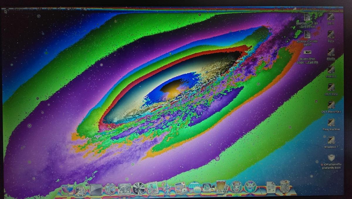

freeuser16 Posted April 23, 2014 Share Posted April 23, 2014 It works perfectly good for me. However, some time ago it didn't and I had to use Device-Properties string to enable the card without gradients. So if it doesn't work, I'm afraid there is no way do fix it yet. But why don't you want to use DisplayMergeNUB kext instead? I think you can put it into kexts/10.9 folder and keep vanilla system, no? Link to comment https://www.insanelymac.com/forum/topic/277042-amd-radeon-hd-6650m-graphics-enabler-dsdt-hdmi-audio-acer-aspire-7750g-2674g50mnkk-gradients-fixed/page/35/#findComment-2014700 Share on other sites More sharing options...
Trucker MK Posted April 23, 2014 Author Share Posted April 23, 2014 DisplayMergeNUB.kext works only from /S/L/E/. I guess we (7750G owners) are stuck with it. Link to comment https://www.insanelymac.com/forum/topic/277042-amd-radeon-hd-6650m-graphics-enabler-dsdt-hdmi-audio-acer-aspire-7750g-2674g50mnkk-gradients-fixed/page/35/#findComment-2014739 Share on other sites More sharing options...
freeuser16 Posted April 23, 2014 Share Posted April 23, 2014 Well, at least it's not overwritten with system update. You only have to install it again when the new OS X version is released (once in a year or something). It's definitely much easier than getting AppleHDA to work fe. Link to comment https://www.insanelymac.com/forum/topic/277042-amd-radeon-hd-6650m-graphics-enabler-dsdt-hdmi-audio-acer-aspire-7750g-2674g50mnkk-gradients-fixed/page/35/#findComment-2014743 Share on other sites More sharing options...

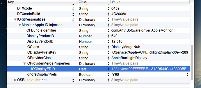

Trucker MK Posted May 30, 2014 Author Share Posted May 30, 2014 1. Don't use my DSDT 2. Switch to Enoch bootloader 2286, (do not install newer version) and make sure you have EnableDualLink=Yes and GraphicsEnabler=Yes in org.Chameleon.boot.plist but only after installing patched AMD6000Controller.kext 3. Use FixEDID to create DisplayMergeNUB.kext ( disconnect VGA and HDMI before running FixEDID ) so you can inject your modified EDID to fix the gradients issue. ( For this you need to have your originial EDID in bin format (I dumped it on windows with MonInfo, i couldn't use EDID obtained with DarwinDumper, FixEDID was giving some error. you can try SwitchResX on OS X). Check page 28 for info about which values you need to edit in your original EDID. Create your modified EDID and replace the values in DisplayMergeNUB.kext Reboot, dump your EDID with DurwinDumper and look for the broken checksum line Edit your modified EDID again in DisplayMergeNUB.kext replacing the last two digits with those from DurwinDumper ((should be 0xXX) to fix the broken checksum. 4. Patch Ipomoea with this framebuffer: 020000004000000009010000100000030008000000020000000100001102010110000000100000000001000000000205 5. Go to System Preferences/Displays/Color and choose this color profile sRGB IEC61966-2.1 Let me know if you need help with something. This is my original EDID 00 FF FF FF FF FF FF 00 30 E4 89 02 00 00 00 00 00 13 01 03 80 26 15 78 0A 6C 15 9C 59 55 99 27 18 50 54 00 00 00 01 01 01 01 01 01 01 01 01 01 01 01 01 01 01 01 2F 26 40 B8 60 84 0C 30 30 30 23 00 7E D7 10 00 00 19 00 00 00 00 00 00 00 00 00 00 00 00 00 00 00 00 00 00 00 00 00 FE 00 00 00 00 4C 47 44 69 73 70 6C 61 79 0A 00 00 00 FE 00 4C 50 31 37 33 57 44 31 2D 54 4C 41 33 00 9B This is my modified EDID 00 FF FF FF FF FF FF 00 06 10 14 A0 00 00 00 00 0A 16 01 04 90 26 15 78 0A 6F B1 A7 55 4C 9E 25 0C 50 54 00 00 00 01 01 01 01 01 01 01 01 01 01 01 01 01 01 01 01 2F 26 40 B8 60 84 0C 30 30 30 23 00 7E D7 10 00 00 19 00 00 00 FC 00 43 6F 6C 6F 72 20 4C 43 44 0A 20 20 20 00 00 00 FE 00 00 00 00 4C 47 44 69 73 70 6C 61 79 0A 00 00 00 FE 00 4C 50 31 37 33 57 44 31 2D 54 4C 41 33 00 66 EDID info header: 00 ff ff ff ff ff ff 00 serial number: 06 10 14 a0 00 00 00 00 0a 16 version: 01 04 basic params: 90 26 15 78 0a chroma info: 6f b1 a7 55 4c 9e 25 0c 50 54 established: 00 00 00 standard: 01 01 01 01 01 01 01 01 01 01 01 01 01 01 01 01 descriptor 1: 2f 26 40 b8 60 84 0c 30 30 30 23 00 7e d7 10 00 00 19 descriptor 2: 00 00 00 fc 00 43 6f 6c 6f 72 20 4c 43 44 0a 20 20 20 descriptor 3: 00 00 00 fe 00 00 00 00 4c 47 44 69 73 70 6c 61 79 0a descriptor 4: 00 00 00 fe 00 4c 50 31 37 33 57 44 31 2d 54 4c 41 33 extensions: 00 checksum: be Link to comment https://www.insanelymac.com/forum/topic/277042-amd-radeon-hd-6650m-graphics-enabler-dsdt-hdmi-audio-acer-aspire-7750g-2674g50mnkk-gradients-fixed/page/35/#findComment-2023266 Share on other sites More sharing options...
Basaaa Posted May 30, 2014 Share Posted May 30, 2014 Thank you for your response. Few questions: With the bootloader, do you mean http://www.osx86.net/files/file/3740-chameleon-v22-svn-r2286/ ? "replace the values in DisplayMergeNUB.kext" How? Patch the Ipomoea is with that ati_personality.py right? And then replace with hex editor? Will I lose sleep functionality? As it works perfectly fine with your DSDT. With page 28 you mean post #557 from freeuser16? Will be home in an hour, so I'll go and do my very best. Thank you for your help (so far ) Link to comment https://www.insanelymac.com/forum/topic/277042-amd-radeon-hd-6650m-graphics-enabler-dsdt-hdmi-audio-acer-aspire-7750g-2674g50mnkk-gradients-fixed/page/35/#findComment-2023281 Share on other sites More sharing options...
Trucker MK Posted May 30, 2014 Author Share Posted May 30, 2014 1. Yes 2. Edit the Info.plist with Plist Editor, i have edited and attached a screenshot to my post. 3.Yes 4. You will not lose sleep 5. Yes Link to comment https://www.insanelymac.com/forum/topic/277042-amd-radeon-hd-6650m-graphics-enabler-dsdt-hdmi-audio-acer-aspire-7750g-2674g50mnkk-gradients-fixed/page/35/#findComment-2023284 Share on other sites More sharing options...

Basaaa Posted May 31, 2014 Share Posted May 31, 2014 freeuser16, with the help from Trucker, I managed to get my laptop to work with full qe/ci and without color banding. There is 1 problem though. For work I have to use monitors. Now I have 2 23" monitors, and I want to use both of them, while not using the LVDS screen (6650m can only handle 2 screens at a time) Have you ever tried to connect 2 external displays? Link to comment https://www.insanelymac.com/forum/topic/277042-amd-radeon-hd-6650m-graphics-enabler-dsdt-hdmi-audio-acer-aspire-7750g-2674g50mnkk-gradients-fixed/page/35/#findComment-2023563 Share on other sites More sharing options...
