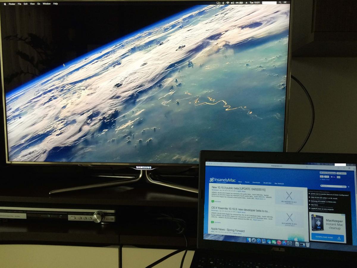

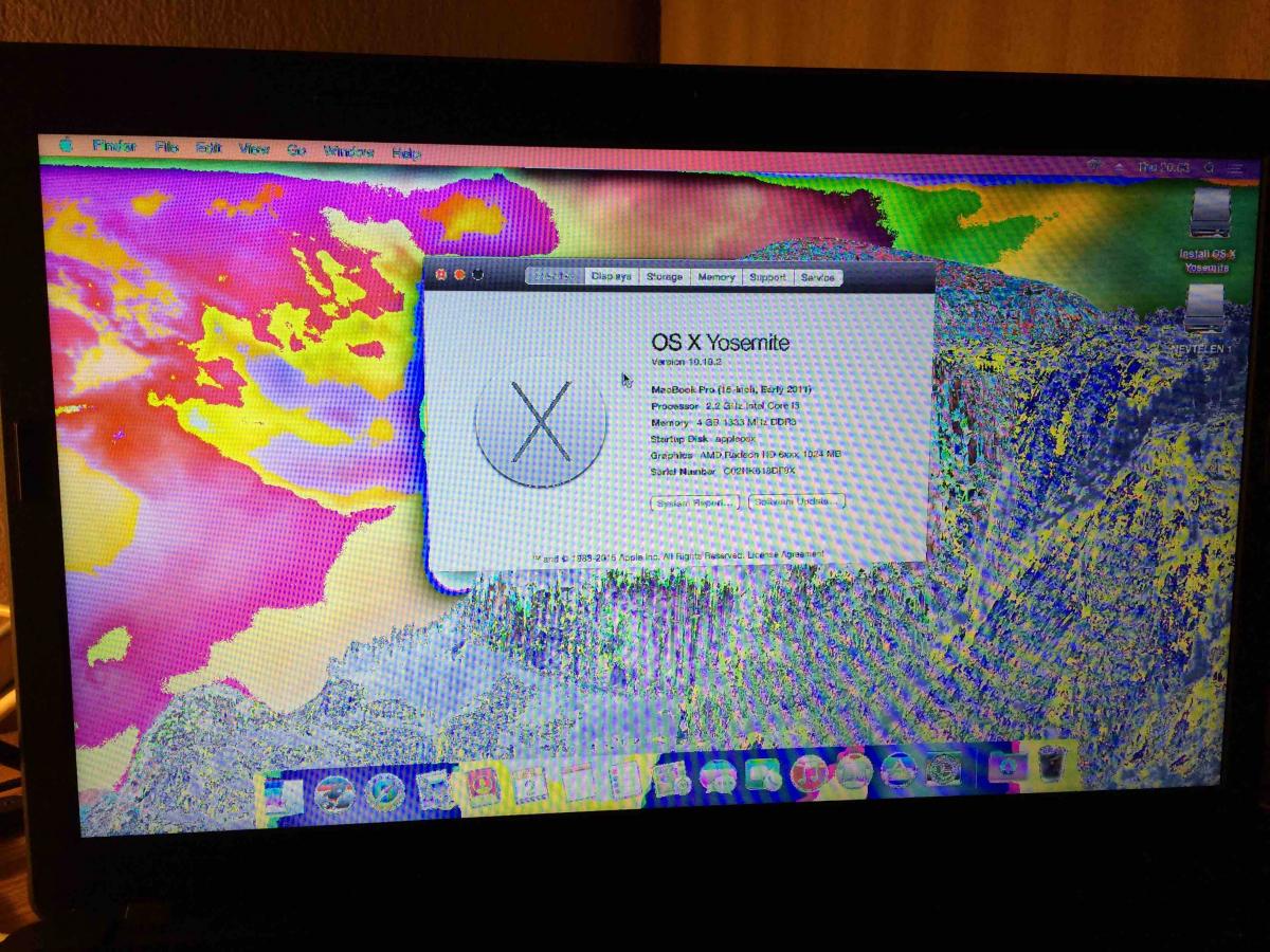

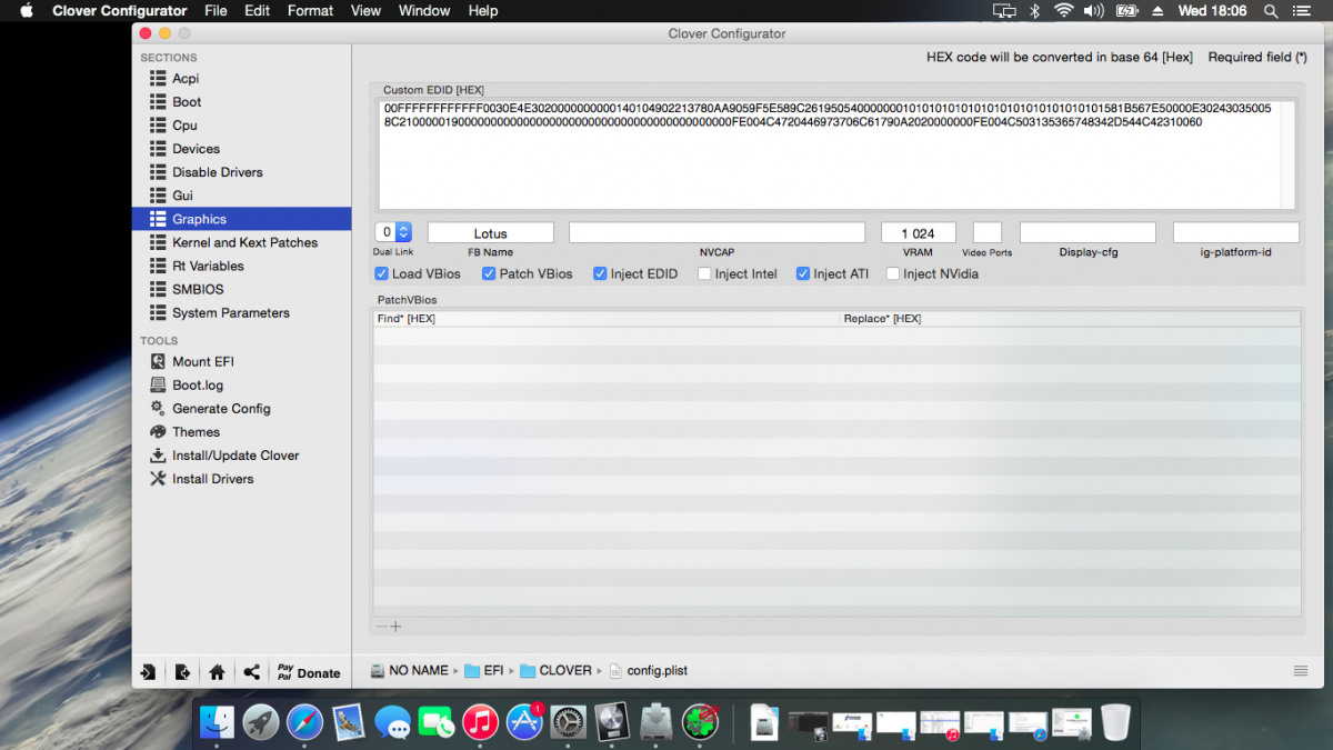

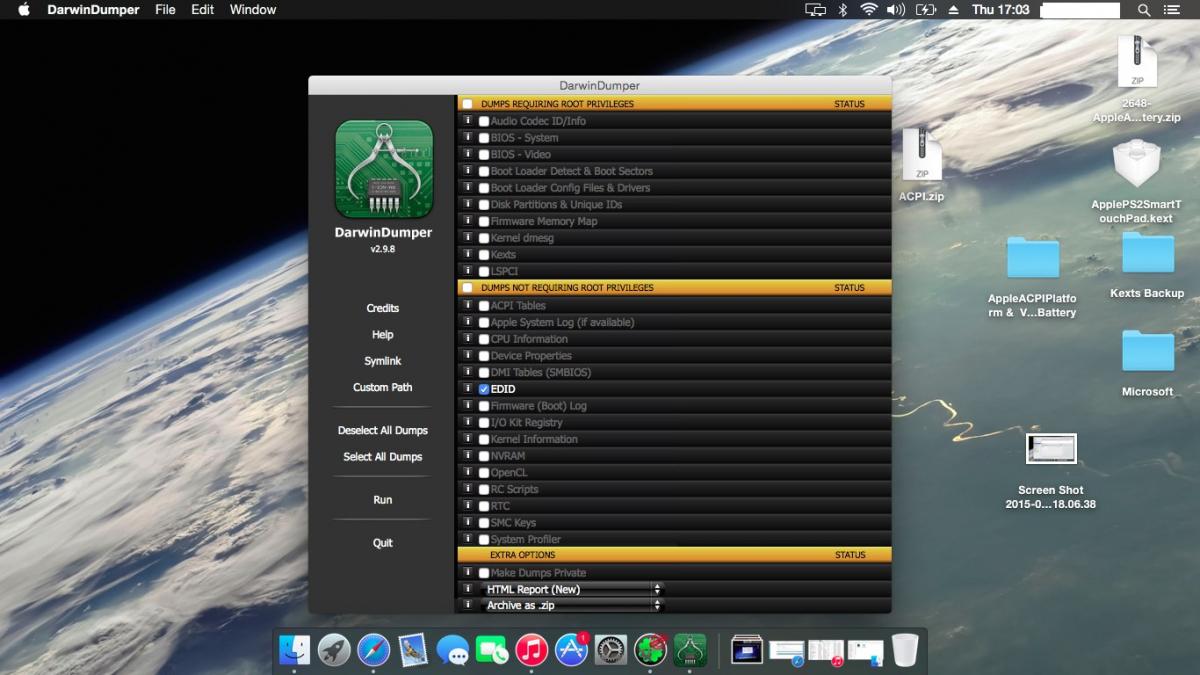

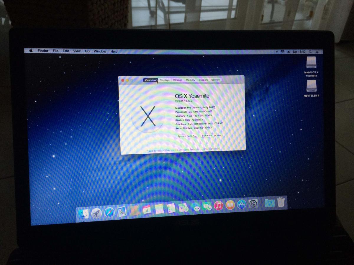

grexai926 Posted April 6, 2015 Share Posted April 6, 2015 Here is a way to make your Ati radeon 6470m work with clover and also To install Os X yosemite to Asus X54HYThis is how i made my computer almost fully work A lot of thanks to vusun123 for the ideas and lot of helping !! Please before you start or ask read the description carefully !------------------------------------------------------------------------------------------WHAT YOU NEED 2 pics of 8GB USB to create clover usb and win 7efi usb installerA macintosh or a hackintosh ( it's not a problem if it not works fully ex.: no hardware acceleration) to create your clover usbPrograms : In OS-XDownloaded OS-X yosemite from appstoreHackintosh Vietnam tool http://www.insanelymac.com/forum/files/file/210-hackintosh-vietnam-ultimate-aio-tool/ Clover configuratorhttp://www.hackintoshosx.com/files/file/49-clover-configurator/ Darwin dumper https://bitbucket.org/blackosx/darwindumper/downloadsIn Windows Windows 7.isoviewsonic EDID generator http://viewsonic-edid-editor.software.informer.com/3.1/ i have 1 TB HDD so i usually partition my disk in GPT with 3 partitions 150 GB for Windows, 677GB Data and 100GB AppleOSX-----------------------------------------------------------------Creating the Win7 usb open your win7 iso copy all to your USB the go to efi/microsoft/ boot copy the "boot"folder one level upper now you should have and efi/boot folder download the bootmgfw-w7.efi.zip file unzip, than rename it to bootx64.efi and copy it to "your usb"/efi/boot folder ------------------------------------------------------------PARTITIONING now you can boot with your WIN7 usb when it booted open windows CMD ( press shift + f10 to bring it up ) than write these (press enter after every line ) diskpart lis dis sel dis x ( x is the number of your hdd, usually 0 ) clean convert gpt cre par efi size=300 format quick fs=fat32 cre par msr size=128 cre par pri size=153600 format quick fs=ntfs label="Windows" cre par pri size=677400 format quick fs=ntfs label="Data" cre par pri size=102400 format quick fs=ntfs label="Apple" (If you don’t need data partition the order of partitions don’t matter but if you need DATA partition you should pay attention to the order because Yosemite creates a recovery partition and in windows you won’t able to see your DATA when yosemite is not the last partition)after partitioning exit CMD Don't install windows yet ----------------------------------------------------CREATING CLOVER USB AND YOSEMITE INSTALLER now Go To your OS-X and create you boot USB like it Clover USB like in this link : http://www.insanelymac.com/forum/topic/298027-guide-aio-guides-for-hackintosh/page-2?do=findComment&comment=2030113IMPORTANT you must pay attention that you MUST NOT rename the partition you make for clover leave it "untitled" because if you rename it WONT boot( im hungarian, i used Hungarian system language it also worked when i left it "NEVTELEN" ( it means untitled ), but you should probably use english system language) open your clover config.plist with clover configuratorNow add ati config = "Lotus" Vram = "1024 , tick inject EDID, inject ATI, inject Vbios , set duallink to 0 ( its importatnt if you have 1366x768 resolution ) On Add macbook pro 8.2 in smbios ---------------------------------------------------------------------------------------------------------INSTALL YOSEMITE if you boot now you will have QE / CI probably with color gradient You can install yosemite to the created partition Apple partiton ( you should format it with disk utility to mac os journaled ) -------------------------------------------------------------------------------------------------------------EDID editing Run Darwin Dumper on Mac, its enough to tick EDID other report stuff is useless for us now. When EDID report is ready bring it to Windowsit should look like this Extracted contents: header: 00 ff ff ff ff ff ff 00 serial number: 30 e4 e3 02 00 00 00 00 00 14 version: 01 03 basic params: 80 22 13 78 0a chroma info: a9 05 9f 5e 58 9c 26 19 50 54 established: 00 00 00 standard: 01 01 01 01 01 01 01 01 01 01 01 01 01 01 01 01 descriptor 1: 58 1b 56 7e 50 00 0e 30 24 30 35 00 58 c2 10 00 00 19 descriptor 2: 00 00 00 00 00 00 00 00 00 00 00 00 00 00 00 00 00 00 descriptor 3: 00 00 00 fe 00 4c 47 20 44 69 73 70 6c 61 79 0a 20 20 descriptor 4: 00 00 00 fe 00 4c 50 31 35 36 57 48 34 2d 54 4c 42 31 extensions: 00 checksum: 71 In Windows, install Viewsonic EDID Editor. Open the EDID txt from Darwin Dumper, look at the EDID version, it should be 01 03, if so then change it to 01 04; look at basic param, the first byte should be 80, change it to 90. After editing, open Viewsonic EDID Editor and manually input every bytes of the EDID except checksum the program will automatically calculate it. After getting your checksum, write it onto your EDID txt ( edit both EDID version, basic param and checksum in there ) then bring it to Mac.Open your config.plist with Clover Configurator, click on Graphics tab, paste your edited EDID into CustomEDID section mine looks like this ( without enter or space ) : 00FFFFFFFFFFFF0030E4E3020000000000140104902213780AA9059F5E589C26195054 00000001010101010101010101010101010101581B567E50000E302430350058C2100000 19000000000000000000000000000000000000000000FE004C4720446973706C61790A20 20000000FE004C503135365748342D544C42310060 Now if you reboot your graphics card will fully operate You can use hackintosh Vietnam tool to install clover it will install it to the created No Name partition, you should copy the config.plist from usb.Reboot go to bios: add a new boot option : name it as you wish the path should be : EFI\Clover\CloverX64.efi Now you can boot without usb Now install windows 7 to the created windows partition ( USE the usb ) --------------------------------------------------------------------------------------------- YOSEMITE POST INSTALLION Kexts for yosemite:Use the kexts from hackintosh vietnam tool ( like USB3.0, wifi ,battery, asus fn, etc )battery won't write the percents well, it will always be 0 % but if you click on the battery icon it will count probably good timeleftTouchpaddownload the latest kext from here install to the EFI partition /EFI/Clover/kexts/other/ http://forum.osxlatitude.com/index.php?/topic/1948-elan-and-focaltech-smart-touchpad-driver-mac-os-x/ two figure gestures will wok only if you change scrolling settings (in settings --> trackpad)AUDIOuse the 64 bit version of this pkg,http://www.hackintoshosx.com/files/file/480-voodoohda-282-r86-3264bit-installer-vt2021-51/HDMI is working - isn't is beautiful?VGA is not tested yet but it should work bootmgfw-w7.efi.zip config.zip 1 Link to comment https://www.insanelymac.com/forum/topic/305496-asus-x54hy-installion-yosemite-1010x-windows-7-dual-boot-ati-6470m-fully-working/ Share on other sites More sharing options...

Sixx08 Posted May 28, 2015 Share Posted May 28, 2015 Hey I would just like to say that this fixed my 3mb 6470m graphics problem i installed os x with clover than did the edid editing afterwards and it works perfectly first time you are a legend =D Link to comment https://www.insanelymac.com/forum/topic/305496-asus-x54hy-installion-yosemite-1010x-windows-7-dual-boot-ati-6470m-fully-working/#findComment-2139489 Share on other sites More sharing options...

vusun123 Posted May 28, 2015 Share Posted May 28, 2015 One thing, I would like to correct a few details. There's a program in Windows named Moninfo, it can calculate the edited EDID real-time to get the checksum so you don't have to go through the " type all 128 bytes of EDID " pain anymore Link to comment https://www.insanelymac.com/forum/topic/305496-asus-x54hy-installion-yosemite-1010x-windows-7-dual-boot-ati-6470m-fully-working/#findComment-2139505 Share on other sites More sharing options...
