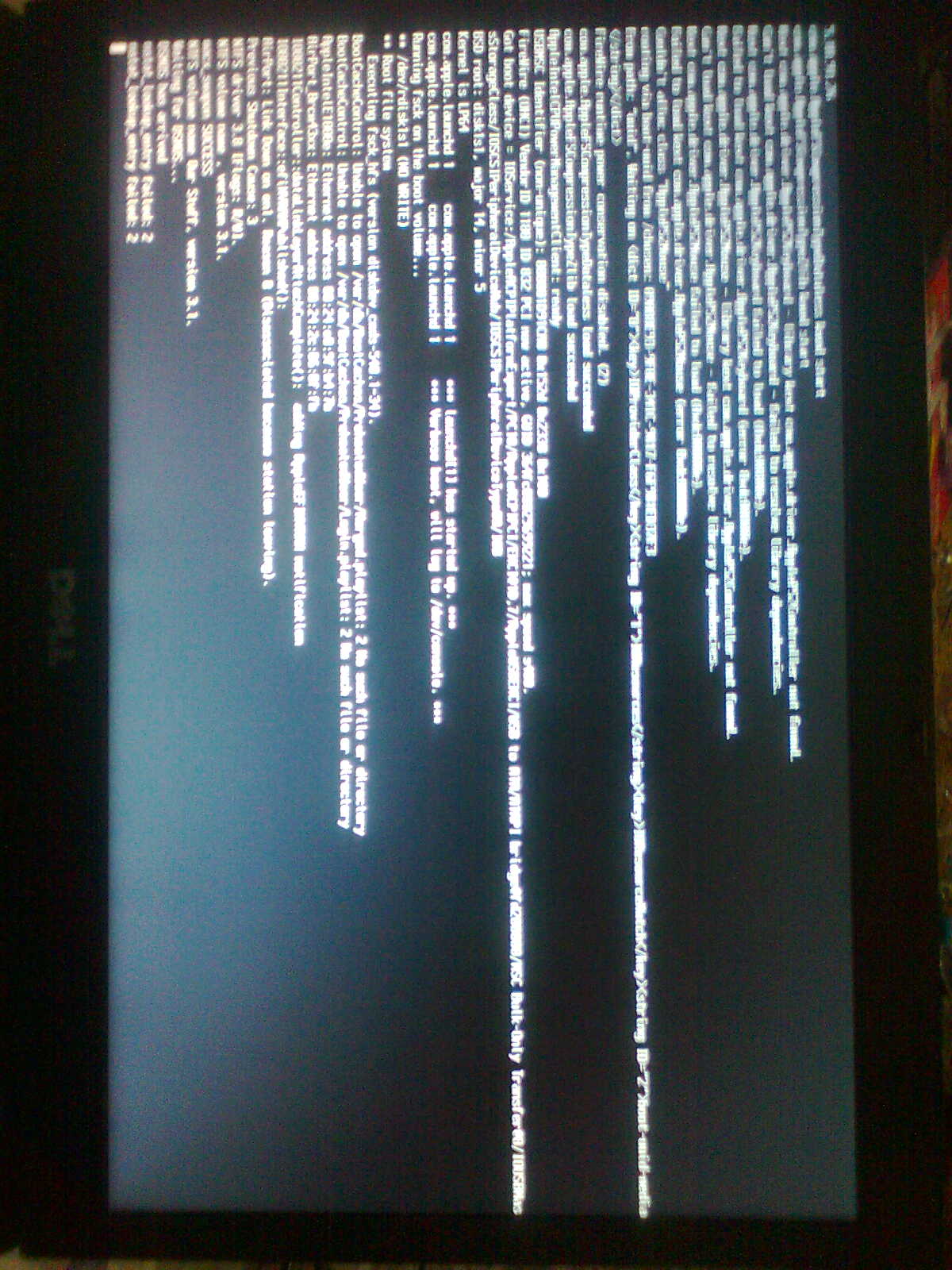

TheNavigator Posted June 20, 2012 Author Share Posted June 20, 2012 If you can get OS X installed using your other laptop, why not swap the HDDs over, install, then swap back.Then you can concentrate on getting it to boot the OS rather than the installer. It's already installed. The installer boots perfectly, the installation doesn't. Why do you keep trying different versions? I'm already working on 10.7.3, but as I found that it's a little different than 10.7, so I thought about downloading 10.7 and working on it. I'll stop doing that now though. Why don't you google it and find out!? Sorry for that. I did and found out, but would it make a difference as the installation already boots on another laptop? Maybe you need to dedicate a bit more time to *learning* and less time to posting on here asking for help at every turn.There is a manual for Ukelele in the download. RTFM I can talk you through it if you want but it really would be a waste of time considering how easy it actually is. You're right about that... I'll read the manual Just a cosmetic issue.The latest chameleon should pick it up automatically, if not, edit your smbios.plist I don't even have an smbios there. Shall I create one? Chances are you don't have AppleIntelCPUPowerManagement.kext loaded. I guess you're right cuz permissions are not as they should be. I'll try and reply if I had an issue. -------------------------------------------- I've followed this topic. http://www.insanelym...howtopic=243851 Specially this post. #23 I've reached a good point, bypassed that RTC thing and the other problems. Had a problem with NVClockX though. I deleted it then everything worked fine, except that I'm stuck at the attached image. Link to comment https://www.insanelymac.com/forum/topic/276288-iatkos-l2-stuck-on-apple-logo-start-failed-to-get-acpi-path-for-provider/page/9/#findComment-1827884 Share on other sites More sharing options...
eep357 Posted June 20, 2012 Share Posted June 20, 2012 That's not stuck, but no graphics loaded. The nstat_lookup failed 2 message is normal and nothing really failed that matters. So check your graphics enabler settings again either yes or no, it's almost there. looks like your ethernet and wifi might be working too. Since you can't see the desktop to put in your password for wifi, you can try ethernet and if you have another mac, screen share into it and control it that way while u set it up. If not you could still plug it in then check your router status page and see if it shows it as a connected device, if it does it definately is up and running just no graphics Link to comment https://www.insanelymac.com/forum/topic/276288-iatkos-l2-stuck-on-apple-logo-start-failed-to-get-acpi-path-for-provider/page/9/#findComment-1827889 Share on other sites More sharing options...
TheNavigator Posted June 20, 2012 Author Share Posted June 20, 2012 For the ethernet and wifi, those are for the Acer, not the Dell. For the graphics enabler thing, neither worked. Link to comment https://www.insanelymac.com/forum/topic/276288-iatkos-l2-stuck-on-apple-logo-start-failed-to-get-acpi-path-for-provider/page/9/#findComment-1827891 Share on other sites More sharing options...
eep357 Posted June 20, 2012 Share Posted June 20, 2012 uh, that screen shot showed they loaded with a mac address listed. can't mix 2 different computers boot logs into one, so whatever computer you took that screen shot from loaded a network driver. Did you happen to delete any graphics kexts besides nvclock at any point? Cause that is the big difference between that dell and acer, very different graphics card and not too many people that have that dell with the same intel graphics you have on yours. Try all the fun boot flags in every combination you can think of. -x -f -v PCIRoot=1 arch=i386 npci=0x3000 USBBusFix=Yes GraphicsEnabler=Yes or no if all the tinkering and different combinations fail, see if it will at least boot to the command line with -s Link to comment https://www.insanelymac.com/forum/topic/276288-iatkos-l2-stuck-on-apple-logo-start-failed-to-get-acpi-path-for-provider/page/9/#findComment-1827893 Share on other sites More sharing options...
TheNavigator Posted June 20, 2012 Author Share Posted June 20, 2012 I guess it began to be a little mess. I'm using 10.7.3. All those screenshots are from the Dell, not the Acer. The hard disk I installed Lion on has Snow Leopard 10.6.7 which boots perfectly, and it has Lion on another partition that doesn't work. I used myHack to install it. The installation didn't boot on the Dell but it booted on the Acer. I used the files of the linked topic to reach the current state. The Dell's version is E6500 and the Acer is Inspiron. Eep, I'll try those boot flags now. I guess it would boot into the -s thing though. Those long boot flags didn't work. GraphicsEnabler=No and GraphicsEnabler=Yes. Stuck at DSMOS arrived this time though. -s works. Link to comment https://www.insanelymac.com/forum/topic/276288-iatkos-l2-stuck-on-apple-logo-start-failed-to-get-acpi-path-for-provider/page/9/#findComment-1827896 Share on other sites More sharing options...

eep357 Posted June 22, 2012 Share Posted June 22, 2012 I think I asked you this before, but did you remove ANY graphics kexts besides nvclock.kext? You also mentioned in post 217 that you did not have an SMBIOS on your completed installation. Can you boot it on the Acer and copy the entire /Extra folder from your installer over to the root of the completed installation's drive as this would be the first thing to do if you booted into it from the Dell anyway. Link to comment https://www.insanelymac.com/forum/topic/276288-iatkos-l2-stuck-on-apple-logo-start-failed-to-get-acpi-path-for-provider/page/9/#findComment-1828532 Share on other sites More sharing options...
TheNavigator Posted June 22, 2012 Author Share Posted June 22, 2012 No I didn't remove any kexts beside NVClockX.kext. I didn't check if I have an SMbios there after using myHack to be honest, but I guess it's there as it's installed by myHack. It boots into the Acer but it says that I have no keyboard there. It's because I deleted those PS2 things. I'll try to retrieve them and boot, then copy that. I still have the Snow Leopard working perfectly by the way though so I can just copy the Extra folder to there using it, but I still can't get Lion to work. Lion is installed onto another partition of the same HD where Snow Leopard is, but Snow Leopard is working perfectly. When I use the Acer, SL boots perfectly but there's no Wifi, and Lion boots but there's no keyboard. By the way, we already copied the entire folder in the previous installation before using myHack and it didn't work. Link to comment https://www.insanelymac.com/forum/topic/276288-iatkos-l2-stuck-on-apple-logo-start-failed-to-get-acpi-path-for-provider/page/9/#findComment-1828613 Share on other sites More sharing options...
eep357 Posted June 22, 2012 Share Posted June 22, 2012 Copy the Extra folder to Lion then, the one from the installer that worked, not anything that was from prior to myhack. If that does not help boot, make a backup folder and start removing unused graphics kexts like all nvidia, ati and gma940- --do this first, since It looks like your booting but no display, boot again verbose and let it sit a minute. then boot back to Snow Leo and in Lion partition navigate to /var/log/ and post any logs with todays date as created or modified date Link to comment https://www.insanelymac.com/forum/topic/276288-iatkos-l2-stuck-on-apple-logo-start-failed-to-get-acpi-path-for-provider/page/9/#findComment-1828627 Share on other sites More sharing options...
