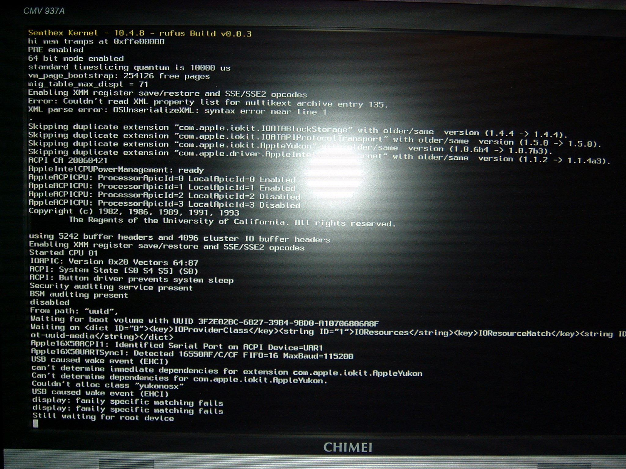

I cannot get the Jas 10.4.8 DVD to boot. I get a "waiting for root device error."
People with 10.4.8: Did you use the DVD or upgrade? Could you detail the process?

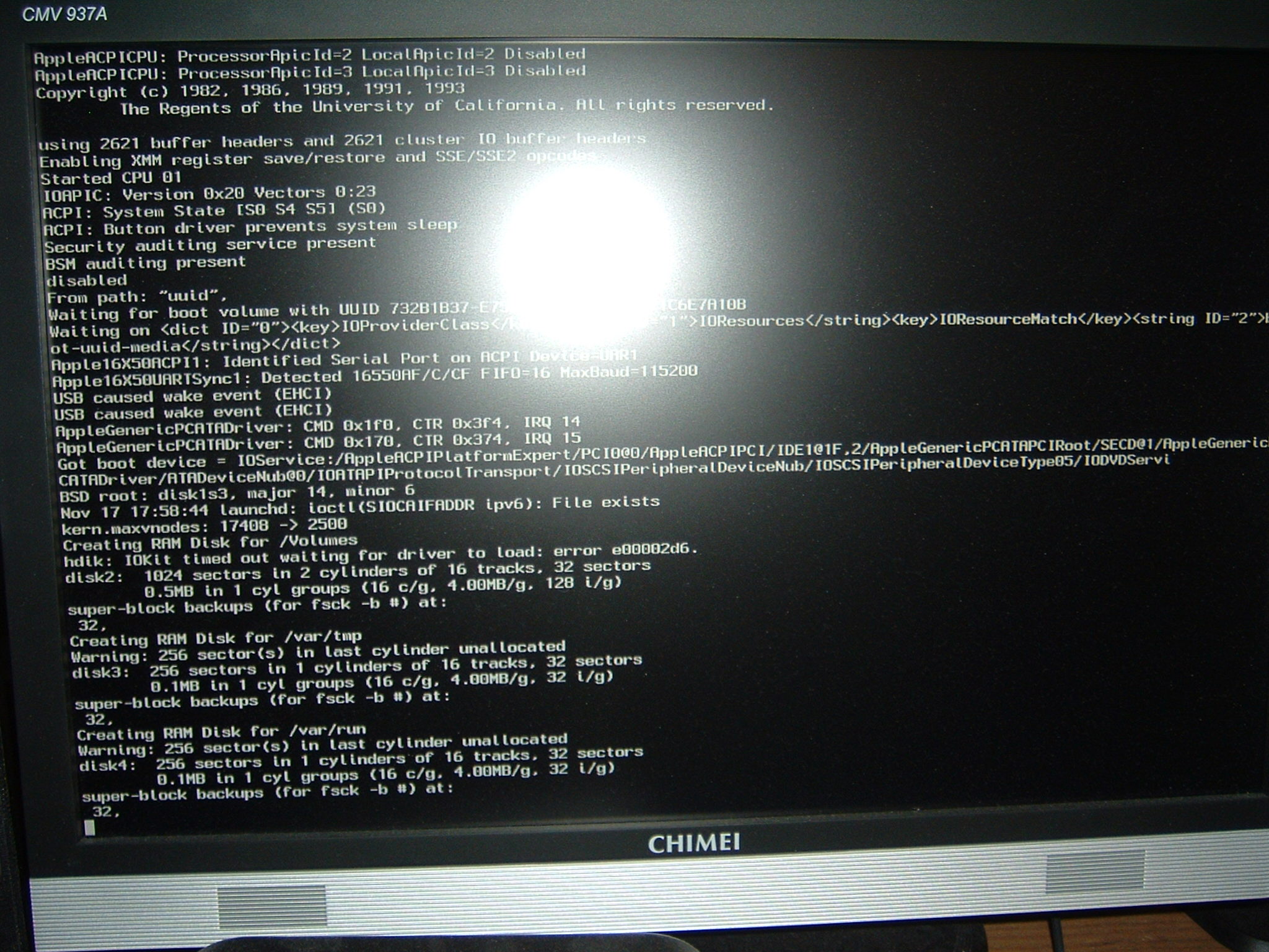

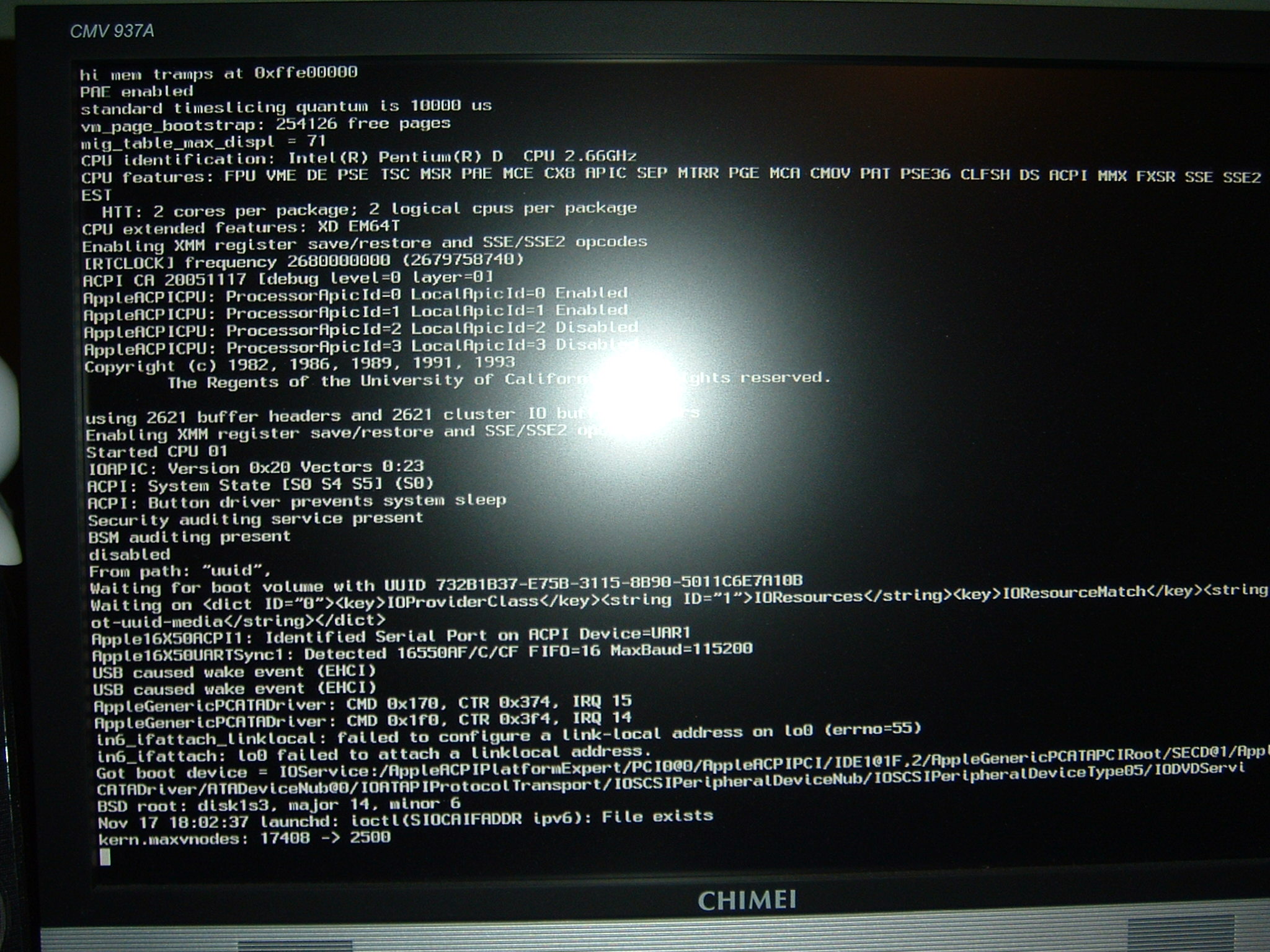

The first image is 10.4.6 Jas booting
The second image is 10.4.7 Jas booting
Both are with the exact same setup that would not allow the 10.4.8 disc to boot. Changing firmware has not helped thus far.
I've put below some of the key differences between the 10.4.6 boot and the 10.4.8 boot.
Key differences:
10.4.8
64 Bit mode enabled
(Does not recognize the CPU as Pentium D)
XML Parse error: OS UnserializeXML: syntax error near line 1
skipping duplicate extension "com.apple.iokit.IOATABlockStorage
skipping duplicate extension "com.apple.iokit.IOATAPIProtocol Transport"
skipping duplicate extension "com.apple.iokit.AppleYukon"
skipping duplicate extension "com.apple.driver.AppleInter...."
ACPI CA 200060421 (10.4.6 is 20051117 [debuge level=0 layer=0]
using 5242 buffer headers and 4096 cluster IO buffer headers (10.4.6 is 2621 buffer headers and 2621 clusters IO buffer headers)

BTW, the 10.4.8 disk uses the Semthex kernel. But whats odd is it still works for most of us.
Since I don't see your boot screen loading any IDE/SATA drivers, even if you used an IDE/usb converter I'm not sure you'll see your hd.
It could be a case of not seeing your drives, and therefore not loading the drivers. I don't know I'm stumped.
At this point, I'm thinking it is a hardware problem.

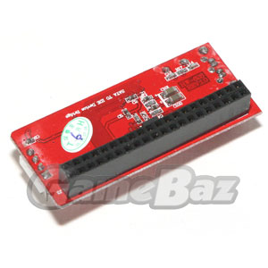

Hi ! Conroe Mac, I've got exactely the same problem.."still waiting for root device" and SAM...with the Jas 10.4.8 DVD (reseed version)
I noticed that I've got the same IDE-SATA adapter than you (transparent little case).....it may be the cause of the problem !
This adpater has some issues with windows too, i can't read any disc when I plug it, but I can still boot my CDs...(hein hein ?!? like we say in french...)
I'm using a Pioneer DVR-111 burner for information

I thought I had a good solution to the converter question, but perhaps I was wrong.
Those who have installed 10.4.8, which SATA converter (or USB converter) did you use?
I thought we established very early in this thread which converters did not work, (quite unfortunately) but perhaps the converter I am using is another example.
HW-628 is the model code. Works perfectly fine for me. I even burnt some OSx86 DVD's under Windows XP with no problems.
Here is a picture:
That's the only stuff I can find written on the converter which will be of any use. That, and "SATA To IDE Device Bridge".
