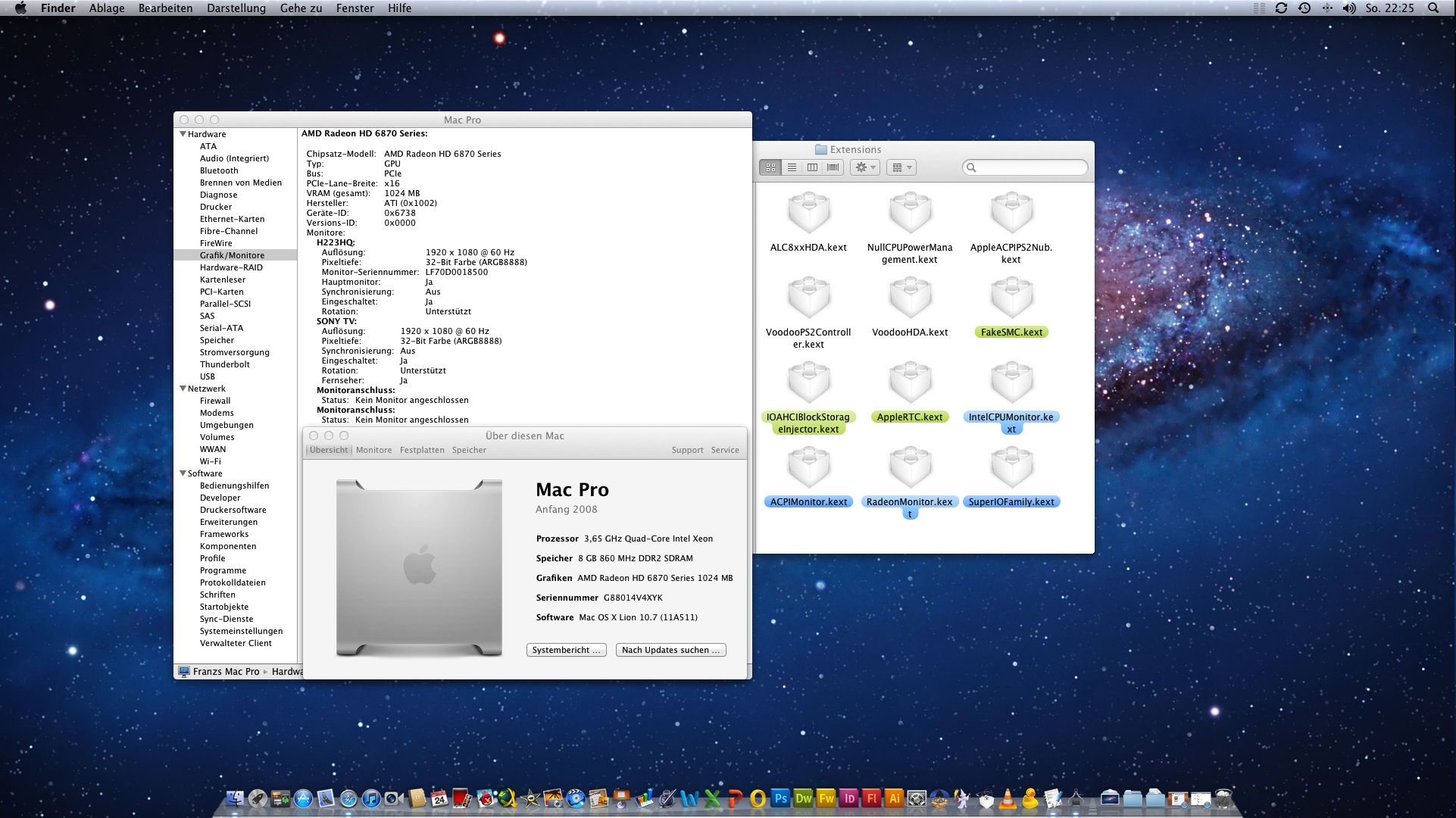

So I got ALC888 working on my EP45T-UD3LR (Catri 0.8) with these files: http://www.kexts.com/downloads.php?do=file...1379&page=2
BUT: Still no sleep/return (not timed, nor forced).
I tried DSDT Autopatcher and the AppleRTC Patch but without any results. Sending the Hackintosh to sleepmode will result in a system with a black screen (monitor powered down) but system still powered on, yet frozen.
Anyone here to enlighten me with a glance of genius on that issue? ;)
have you tried the newer one i posted in the first post, it is a newer built 1200, i tried it on the usb install lion i made that was freezing my computer during post with older chameleon I had posted before in the guide...
Yes, I've tried also the r1200 build but wasn't work for me, the only one that works for me is the one I've posted!
Seems like I've solved the last problem that I have had following again step by step your guide... (the installation would finish in about 3 minutes)...
Hi cizko,
What guide have you followed? this one of eliade? what file do you have in your Extra folder?
Hey pollopollo,
I tried this guide but I went with KAKEWALK 4.0 in the end and then installed the newer version of chameleon to my hard drive post the install.
In my Extra/Extensions there are only two files:
FakeSMC.kext
and
ALC8xxHDA.kext
(after I set up Cartri correctly, I deleted everything else and my DSDT.aml, since I did not need DSDT patching anymore)
That leaves me with only
com.apple.boot.plist
and
smbios.plist
in my /Extra folder
and finally I have
AppleHDA.kext
and
HDAEnabler888.kext
in my /System/Library/Extensions folder
I reversed the AppleRTC patch that I applied earlier so the above are my only changes to a vanilla system.
Now I got everything working. :(
EDIT: I'm back with CMOS reset errors. Will try another kext for this in a few days (gave away my hackitosh to a friend today) --> http://www.kexts.com/view/1494-fix_cmos_re...den_master.html (version 1.0.0d1) or the one mentioned in the comments here http://cartri.net/blog/88 (version 1.0) and if none of those work, I will just re-apply the AppleRTC patch...
But sleep / wake working properly on EP45T-UD3LR with Cartri BIOS 0.8. :D)
