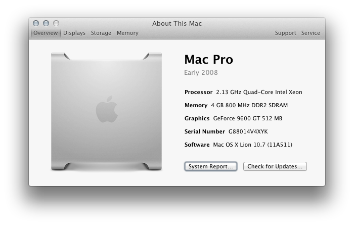

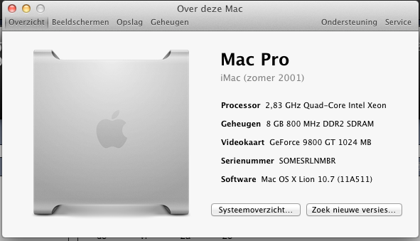

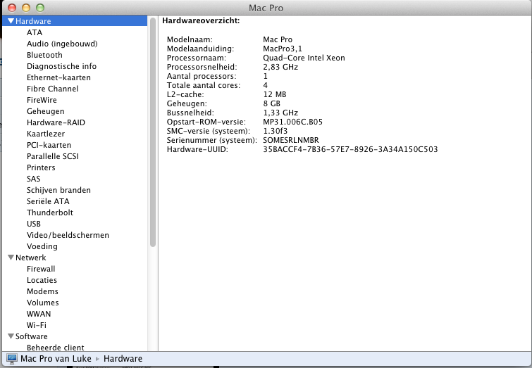

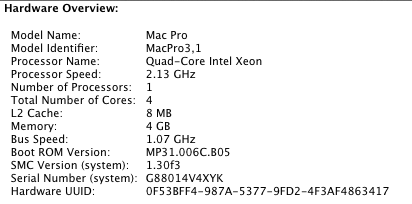

Luky Luke Posted July 13, 2011 Share Posted July 13, 2011 Also running lion GM on this board with the following kexts The only problem im facing is, the login screen after sleep and missing the auto sleep My mac is identified as Mac Pro but a line under this definition is says iMac summer 2001 and the serial number SOMESRLNMBR, does somebody know how to fix this ? Link to comment https://www.insanelymac.com/forum/topic/262015-guide-lion-on-ga-ep45-ud3r-very-close-to-perfection/#findComment-1714127 Share on other sites More sharing options...
Squirrelf Posted July 14, 2011 Author Share Posted July 14, 2011 Also running lion GM on this board with the following kexts The only problem im facing is, the login screen after sleep and missing the auto sleep My mac is identified as Mac Pro but a line under this definition is says iMac summer 2001 and the serial number SOMESRLNMBR, does somebody know how to fix this ? Did you use my Extra folder as a base?? get my smbios.plist !!! with my q6600, it is recognized as a macpro, early 2008 (I used the appropriate smbios) on my other ud3r, I have a e5200 and I get Macpro too Do you not have a dns resolution issue after sleep when in manual IP ? and what do you mean by login screen after sleep ? Link to comment https://www.insanelymac.com/forum/topic/262015-guide-lion-on-ga-ep45-ud3r-very-close-to-perfection/#findComment-1714283 Share on other sites More sharing options...

Luky Luke Posted July 14, 2011 Share Posted July 14, 2011 Did you use my Extra folder as a base?? get my smbios.plist !!! This is how my extra folder looks like: My Extra folder For my audio i replaced the appleHDA.kext in s/l/e with the with the 10.6.8 appleHDA.kext, than got the Ethernet working by using this installer: RealtekRTL81xx-0_0_67%2B.pkg Than i inject the ethernet efi in my com.apple.boot.plist so that the app-store works I also replaced the AppleRTC.kext with the 10.6.8 AppleRTC.kext in s/l/e About my mac info: Everything works perfect for me, only thing is the auto sleep and the annoying login screen that pops up every time it wakes up after a sleep. And that is says iMac in the second line summer 2011 and the SOMESRLNMBR EDIT: Fixed the identification, the smbios file was linked wrong in my com.apple.boot.plist, now it works Link to comment https://www.insanelymac.com/forum/topic/262015-guide-lion-on-ga-ep45-ud3r-very-close-to-perfection/#findComment-1714572 Share on other sites More sharing options...
