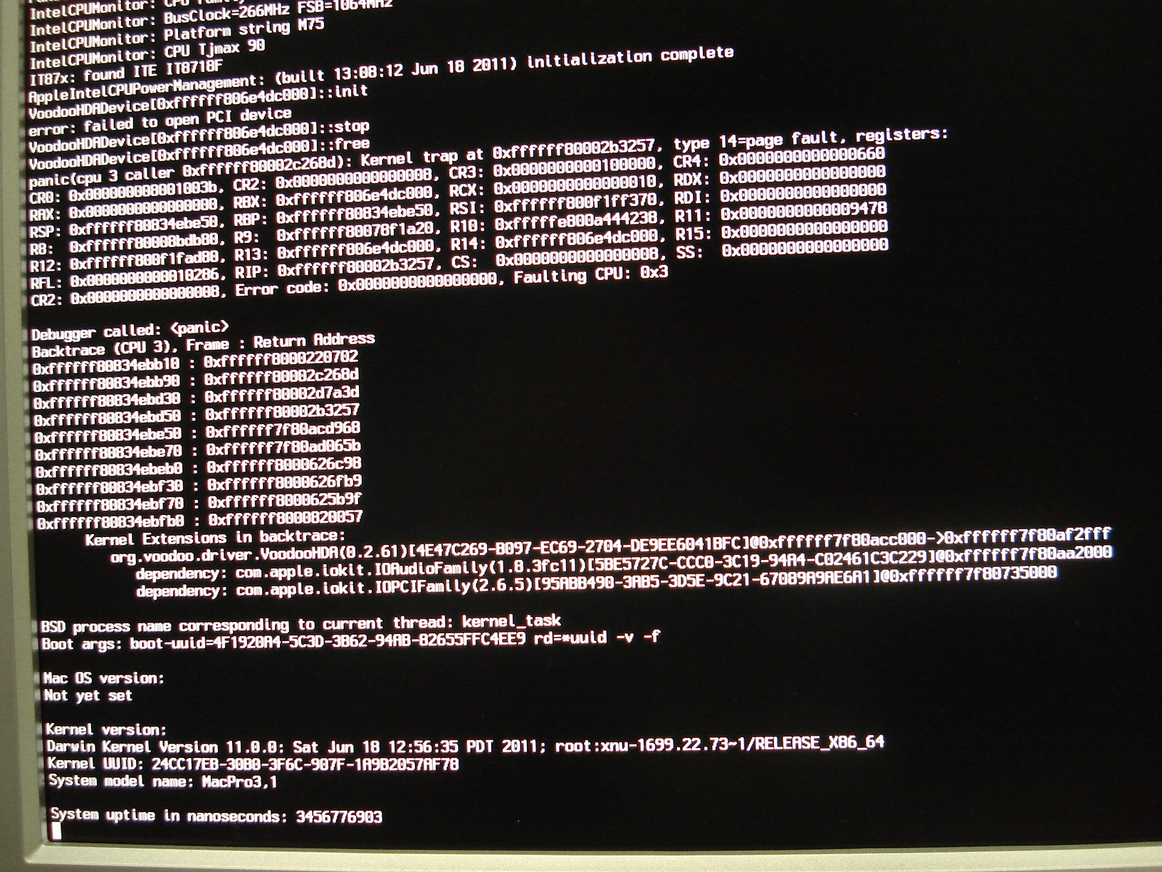

When i did a force shutdown I got this kernel panic(see picture).
Can anybody help me with this one?
thank you,
Emac
just remove the appleHDA.kext. For that boot with -s
You mean remove voodooHDA kext right? After all, that is what is causing the panic. Plus AppleHDA will be required for the other audio install options discussed in this thread...
hmm..
VoodooHDA is in conflict with AppleHDA, choices are:
- remove AppleHDA (use VoodooHDA for sound)
- remove VoodooHDA (patch AppleHDA for sound) (recommended?)
- rename Device (HDEF) in DSDT to something else and use VoodooHDA for sound (if you have to :)
Thank you Swavek...will try that :D
greetz,
E
Well this thread is for the GA-EP45-UD3R. but I see you have the GA-EP45C-DS3R. Doesn't matter as both use the ALC889a audio from Realtek. Ditch Voodoo audio, make sure you have your sound patched correctly for 889a in your DSDT and follow my message over here to get your audio working correctly again. INCLUDES front headphones, woohoo!
