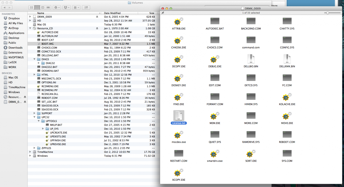

You've got me thinking about something now - what if the recovery dvd of the 15/15z actually contains the flash bios? If that's the case then we just need to trigger the recovery capsule (fvrecovery.fd) and then it should run from the dvd. Let me check on the bios forums to see if someone still has the recovery dvd from the default set...
Bah, it's only a kernel of some sort to initiate the ramdisk ...
Anyway now that we have a key to trigger the recovery process it's only left to uncover what are the files need on the external media to actually do the recovery...
judging by the screenshot you had posted there isn't anything winflash related. Considering UEFI mode is locked from the factory one could assume that there might be regular DOS executables involved in the process of recovery. But then again.. according to Phoenix and Intel's EDK it should be done through DXE/PEI/PPI usage ..

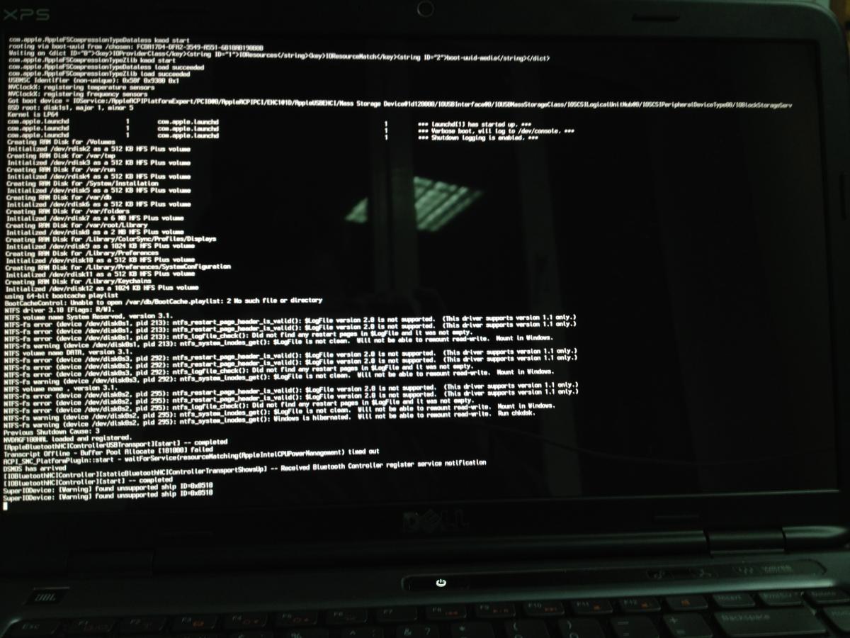

Trying to install OS X ML on my l502x.
I have prepared an installation usb as it was described in post #218 (Simple method) but the boot from it stops at
SuperIODevice: [Warning] found unsupported ship ID=0x8518
Please see the image below
Does anyone have an idea how to deal with it?
Actually I tried different boot args (GraphicsEnabler=n, y, PCIRootUID=0, 1,) as well as BIOS speed step option - enabled and disabled. But nothing helped.
1. I changed FakeSCM.kext in S/L/E on installation USB for the one from another hackintosh
2. On another hackintosh I created smbios.plist (with the help of Champlist app) and put it to Extra folder on my installation USB

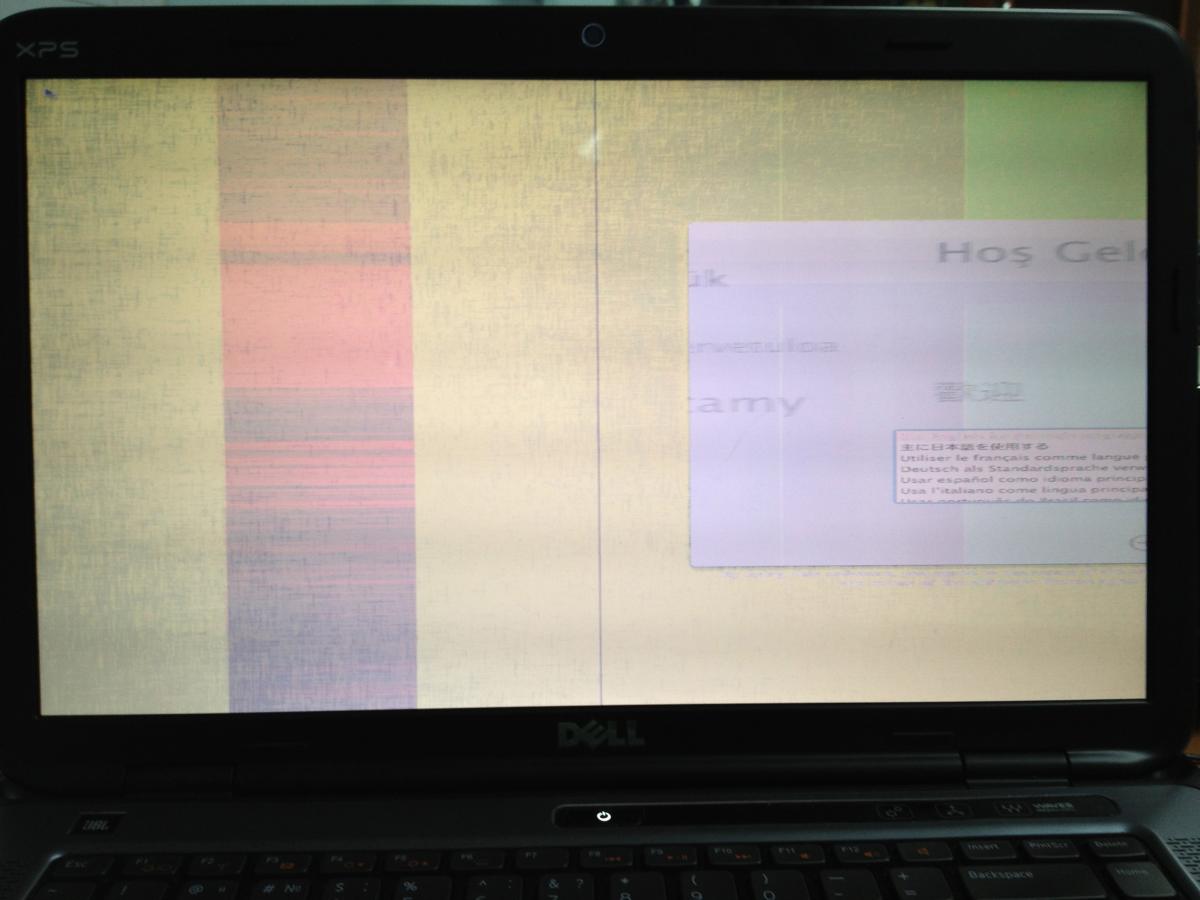

It helped me to boot and now I have a setup screen like this
I read in manual from DoiX (post #218) that it's normal to have such a fuzzy and pinkish screen on full HD displays on l502x and I need to pass the setup process to get to the desktop for the proper patch. But at this initial setup screen neither touchpad nor usb mouse is able to move the cursor...
Is it normal or I do something wrong again?
